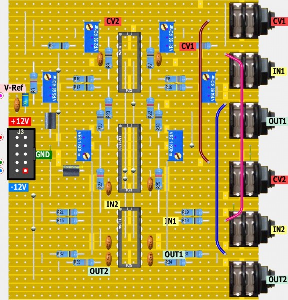

A stripboard version for 2X VCA 64x92mm. Almost finished.
I used LochMaster - http://www.abacom-online.de/uk/html/body_lochmaster.html
RYO 2X VCA stripboard version with LochMaster software
 Filesize:  119.87 KB

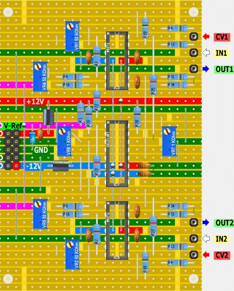

Here with potentials
I used IC2, IC5, but with the pins renumber. Pins IC3 are the same.
Instead of D1,D2,R1,R2,C1,C2,C3,C4 I have used 2 ferrite bead. I will complete pcb with this pieces too.
RYO 2X VCA stripboard version with LochMaster software. Potentials
 Filesize:  302.16 KB
 Viewed:  477 Time(s)
http://nardusynth.blogspot.ro/

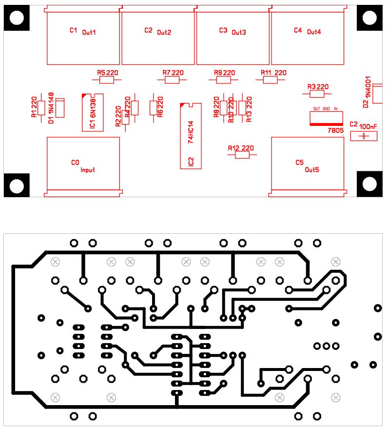

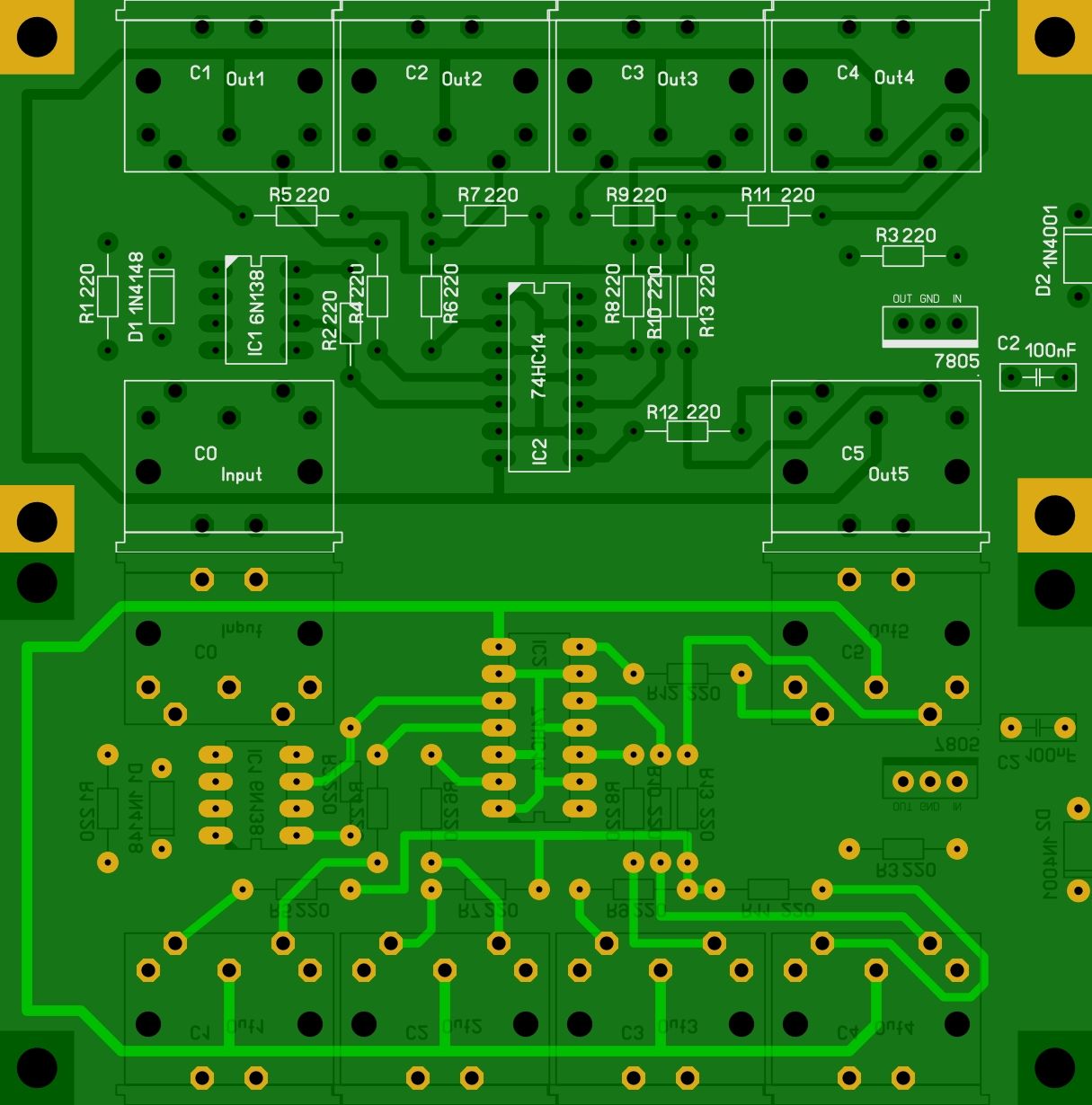

@g.gabba, I use for pcb design Sprint-Layout 6.0 from Abacom http://www.abacom-online.de/uk/html/body_sprint-layout.html .
It's simpler and more productive. Export Gerber files, Drill data (Excellon), Isolation milling (HGPL, .plt), bmp, jpg, gif, emf. Print all layers with option.
All you need to produce DIY pcb; press&peel, toner transfer, CNC milling, plotter, PCB manufacturing... China!
Here is an example
Silkscreen & bottom pcb
 Filesize:  83.98 KB
 Viewed:  421 Time(s)
Photo view with solder mask, like real
 Filesize:  163.82 KB
 Viewed:  440 Time(s)

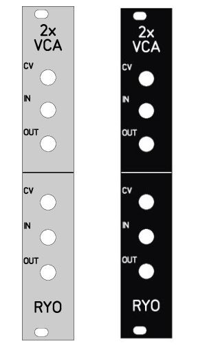

PostPosted: Wed Jan 17, 2018 2:30 pm    Post subject: RYO 2X VCA - Front panel Reply with quote  Mark this post and the followings unread
Front panel idea 4HP EuroRack
 Filesize:  12.87 KB
 Viewed:  23283 Time(s)
RYO 2x VCA-4HP_eurorack.pdf
 Filename:  RYO 2x VCA-4HP_eurorack.pdf
 Filesize:  12.44 KB
 Downloaded:  477 Time(s)
RYO 2x VCA-4HP_eurorack v,2.pdf
 Filename:  RYO 2x VCA-4HP_eurorack v,2.pdf
 Filesize:  12.45 KB
 Downloaded:  456 Time(s)
RYO 2x VCA-2HP_eurorack.fpd
 Filename:  RYO 2x VCA-2HP_eurorack.fpd
 Filesize:  1.11 KB
 Downloaded:  439 Time(s)
RYO 2x VCA-2HP_eurorack v,2.fpd
 Filename:  RYO 2x VCA-2HP_eurorack v,2.fpd
 Filesize:  1.14 KB
 Downloaded:  429 Time(s)

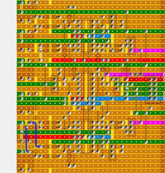

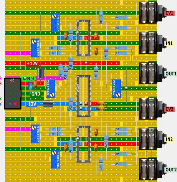

Stripboard version for 2X VCA 76x92mm. Is not like the original scheme
All you need here - RYO 2x VCA stripboard.zip
 Filesize:  203.6 KB
 Viewed:  406 Time(s)
 Filesize:  250.68 KB
 Viewed:  416 Time(s)
 Filesize:  197.59 KB
 Viewed:  433 Time(s)
All you need
 Filename:  RYO 2x VCA stripboard.zip
 Filesize:  425.36 KB
 Downloaded:  478 Time(s)

I was meaning if it is possible from schematics to have components layout and traces.
this way I can use toner transfer method for make my pcb
thanks
Of course, it's possible, but because it is off topic I will answer in detail here - http://electro-music.com/forum/post-428482.html#428482

Stripboard version 2 for 2X VCA. Original scheme; CV1,CV2 - LM324, IN1-Out1, IN2-Out2 - TL084
 Filesize:  339.24 KB
 Viewed:  398 Time(s)
