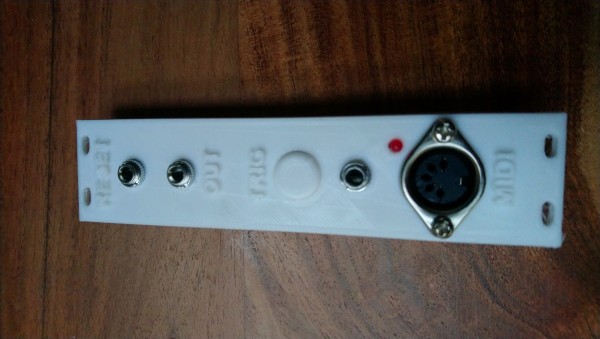

The secundary board for the drum sequencer (isn't 3D printing great πŸ˜‡πŸ‘πŸ»)
Top input resets the sequencer to first step, second connector Is the output of the clock, one pulse for every step.
Then a button for tap-tempo and a trigget input.
Below that a midi output connector with activity Led.
Next.... Software πŸ™ˆ

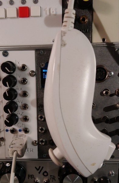

Nintendo Wii Nunchuck Module
https://youtu.be/s3ADI7035gY

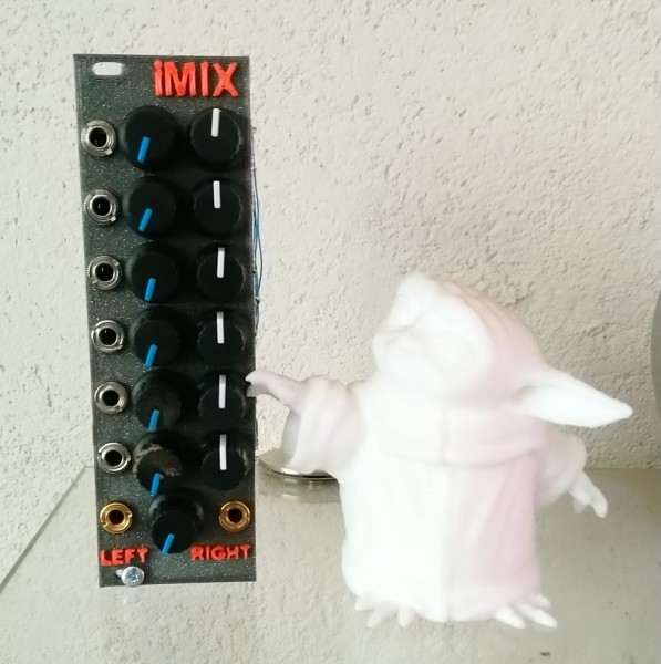

6 channel mono in/stereo out eurorack audio mixer with individual volume and pan control and mixed volume control.

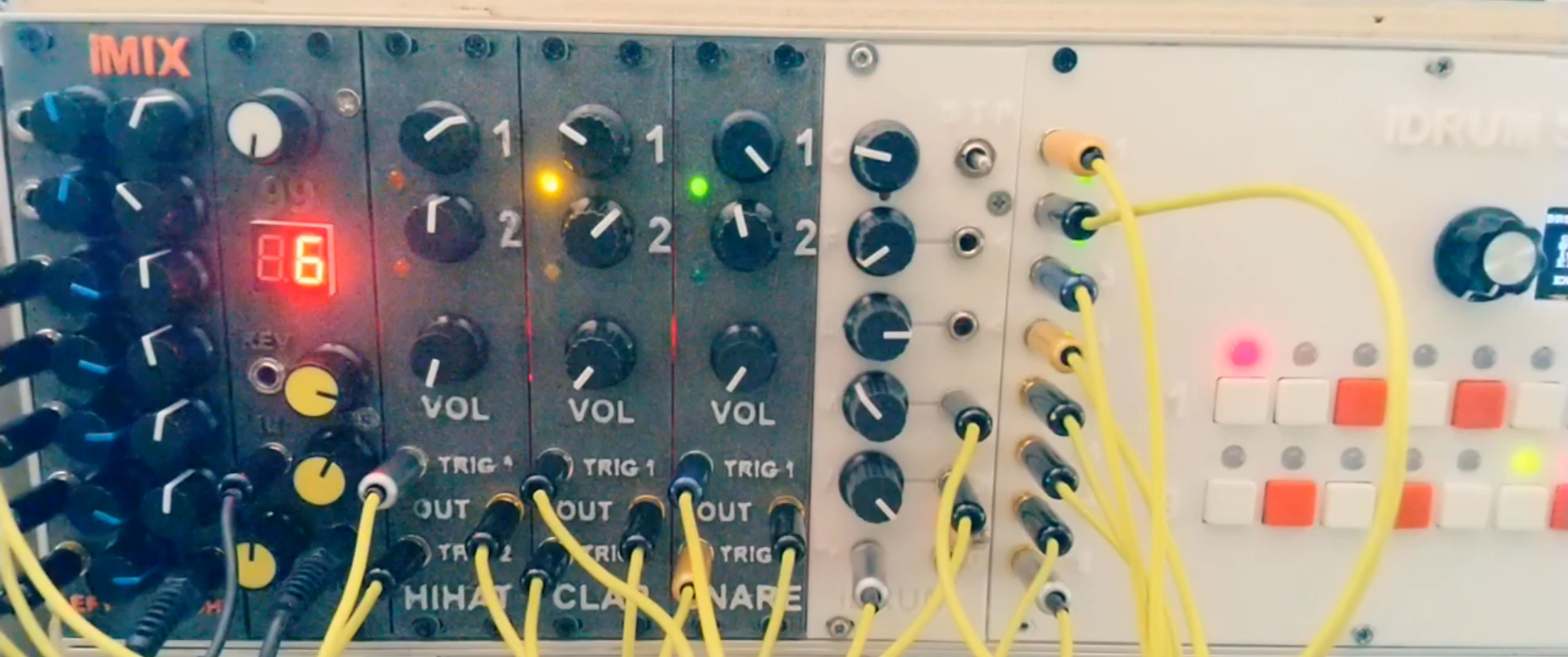

Today I finished my drumkit. The sequencer needs some more programming.
http://youtu.be/hKxWkB8Dxms

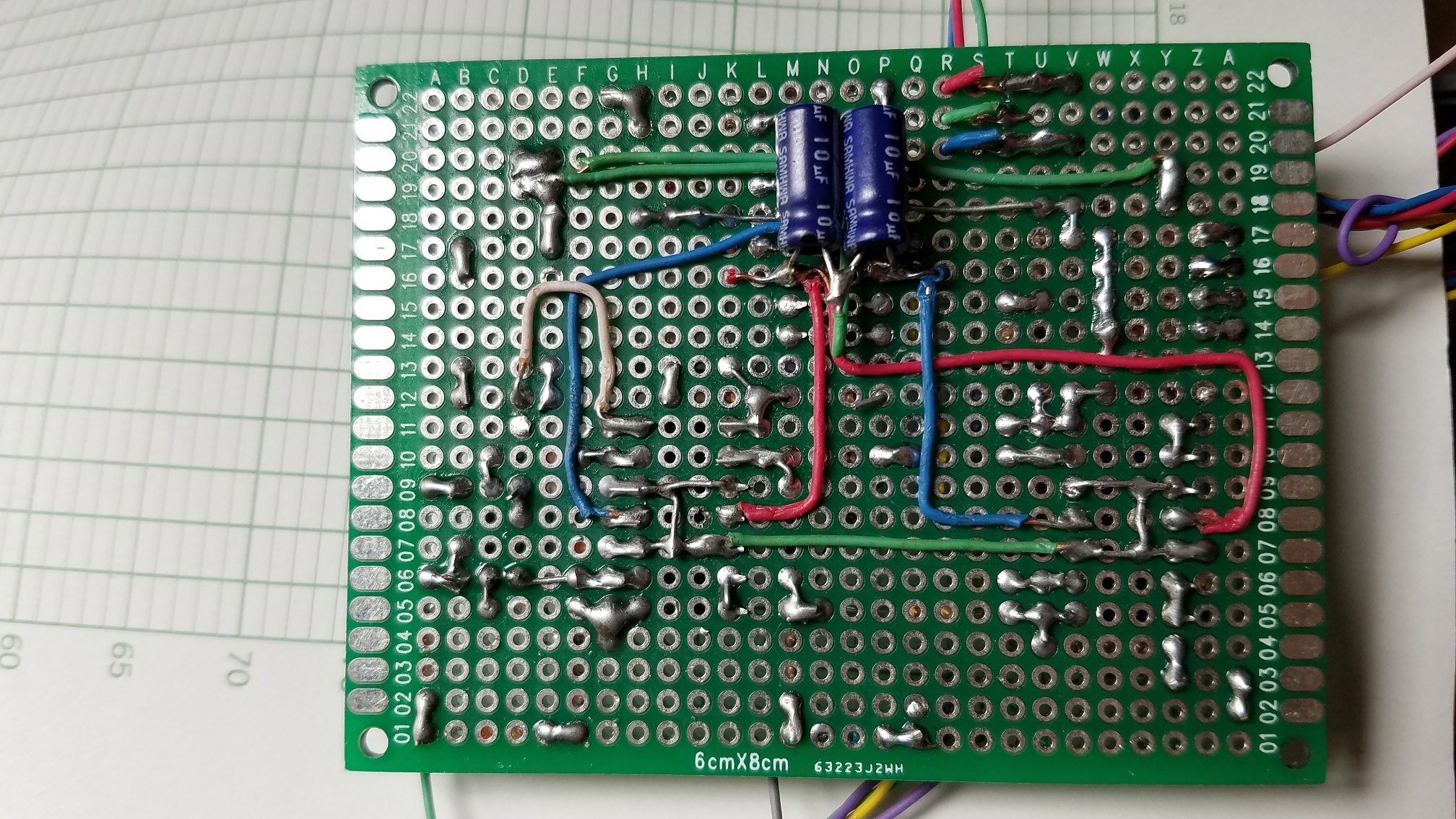

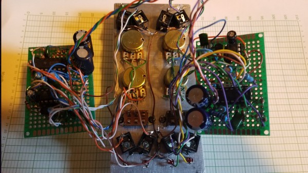

I have lots to learn... Elders of perfboard circuit design, bless me with your knowledge!(or a link to it)
I know these images will disturb most if not all of you... but sadly, this is my current definition of "success."
two thomas henry 555 attack decay envelope generators, with a modification that allows the envelope to retrigger. then I got Ray Wilson's MAKE: synth diy book and it had a much more elegant solution.

not disturbing at all and like the way you use those PCBs as frontpanel Very Happy
The wiring could use bit of tidying up but for the rest it's not bad at all.
Can't see the underside of the PCBs though.

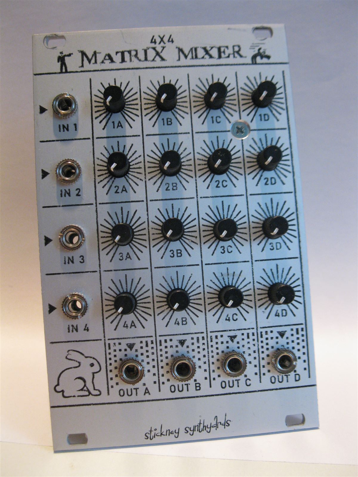

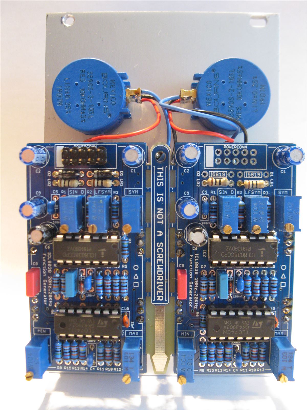

I had/have some time of from work so did some soldering and build 5 new modules.
1x 4x4 Matrix mixer, my first SMD PCB design (can be expanded)
2x ICL8038 Dual function generator using a design by Thomas Henry
2x Bucket Rogers Delay with an MN3007 BBD chip (thanks for those Cfish!!)
Played around with them yesterday which turned out quite different than I was expecting.
You can find the video on twitch (for the next 14 days): https://www.twitch.tv/videos/733559035
and I will probably post the audio (starting from around 1:40:00) here on EM later.

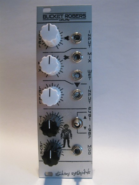

And the Bucket Roger Delay.
I didn't notice the opamps being upside down in the schematic, so I had to fix that afterwards by soldering directly to the opamp pins. Rolling Eyes .

Thanks, Phobos! I used an old printer PCB for the sequencer panel. I hadn't settled on using the Eurorack 3U standard at that point. I don't really recommend it, There was some pretty nasty dust in the cutting process.
The underside of the boards? but that's where all the shame hides! I can get some pictures later today, haha. And yes the wiring is very bad at this point... I always intend on shortening the wires after getting confirmation that the modules work, but I haven't gotten around to that yet. I think using some standoff posts would be a huge improvement too.

Wow, Phobos. Nice boards and panels! Is the solder mask opacity an aesthetic choice or does it serve a purpose? I've been wanting to get into PCB design but that seems like a whole new layer of troubleshooting. I've only done some very small boards by cutting traces out on a copper clad board with an exacto blade.

Not sure if you are referring to the effect the copper pour between the traces has which will make it a bit harder to see the traces on the photos,
or the actual solder mask. Solder mask is standard when ordering PCBs (I think it's more expensive without) it's useful when soldering especially
with SMD since it reduces the change of shorts between pads. If you look at the top right of the Matix Mixer PCB there's an opamp which has 2 pins
bridged with some solder. For some reason the 2 opamps on the right side both didn't work so I had to replace them. In doing so I lost some of the
soldermask between those pins, and since they are connected with a trace the solder happily stuck to it. I could have tried to remove it a bit but that
would have probably done more harm than good.
The color choice on the other hand is for aesthetic reasons:
The Matrix Mixer had to be green of course.
I choose blue for the function generator because of all the blue components, especially all the blue pots.
For the Bucket Rogers Delay I looked up some images of Buck Rogers and his ship and saw a lot of white/grey so I went with that.
Usually I don't use the white solder mask as the black silkscreen always seems of lesser quality, it also obscures the traces a lot
(maybe that's what you were referring too) and it looks a bit messy with the solder flux. But for this one I made an exception.
