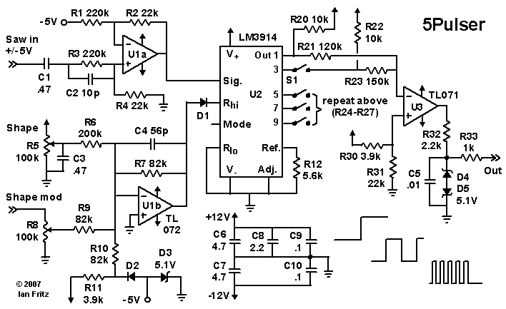

I'll show you a waveshaper Exclamation
The most effective waveshapers are the radical ones that produce multiple peaks per input cycle. There have been a number of these designed over the years, of course, but most are fairly complicated circuits.
A while back I discovered that the LM3914 LED bar-graph display driver chip can run at very high frequencies -- crisp square pulses well above the audio range! Operation of this chip is quite simple. It is basically a stack of window comparators, which fire one at a time as the input signal increases. The total span of the comparators is set by an external voltage.
From this I figured out how to make an interesting waveshaper that puts out a variable pulse train. The waveshape control voltage changes the span of the comparators, so an input sawtooth leads to a train of pulses from a single square wave up to a train of five pulses in less than half a period as the control voltage is varied. (The more traditional wavefolders use a VCA on the input signal to vary the waveshape.) The circuit is quite simple for what it does -- a dual opamp for the input signal and CV conditioning, the LM3914 and an output opamp summer to combine the pulses.
The original unit had some problems due to cross coupling via radiation from the narrow pulses. I've just finished a circuit board design that eliminates these problems by having the digital section built over a ground plane. I might do a run of these if people are interested in trying it out. Please let me know if you are.
Photo, schematic and sound clip are attached. In the sound clip, the drone uses a continuously varying waveshape and the other parts use an ADSR to sweep the timbre with different depths and initial waveforms.

That's very interesting. I am usually interested in new designs that approach old problems differently.
I would be interested in buying a board, should you do a run. It doesn't look like a very complicated circuit, either, which is very refreshing for waveshapers.
However did you conclude that the LM3914 was capable of this? Listening to the sample, I see what you mean about concentrations of pulses. It sounds very smooth though, not at all like harmonics are stepping in.

PostPosted: Sat Jun 30, 2007 7:21 am    Post subject: Reply with quote  Mark this post and the followings unread
Don´t know if the chip offers any protection, but it´s possible that it won´t like it if you apply a saw greater than +-5v, since it´s run between + and ground.
So a simple diode protection might be a good idea.
Also changing the saw ofset might result in some interesting sounds. maybe.

I tried that once. It doesn't work well for a sequencer, because there is some overlap of the pulses.
I found out just out of curiosity. I've built several double pulse generators over the years, and I was familiar with the LM3914 from trying it as a sequencer. So thinking about doing something similar to the Serge folder I realized that I could get multiple wiggles from a comparator chain, and being lazy I wondered if the bar-graph chip would work. I was amazed at how fast it is. It splashes so much RF all over the place that it didn't even work right on a solderless breadboard until I carefully isolated all the signals.
Yes, the multiple pulse evolution is very smooth sounding -- another surprise at first. The reason is that the pulses evolve continuously from zero width. A very narrow pulse has a very high harmonic content, as I'm sure most people realize, but its total energy is very low, which many may not think about. So its contribution to the sound builds up gradually.
Another interesting feature: as a pulse evolves it becomes wider as it is born, but then narrower as it is shoved to the left. Also, the pulses vary in position as well as in width as they evolve. These properties lead to a fairly strong "phasey" sound.
Good thinking. Yeah, if you dig into the fine print the chip's input is internally protected. A 20k series resistor and a diode to ground. (Also the input opamp attenuates the input signal by 10x). So I think it would be pretty hard to abuse. Smile
And, yes, using different input signals is fair game. Some of the demo was actually done with a saw+tri input.
I was trying to figure out how it would look on a scope. The description you give makes sense, and how then the harmonic spectrum shift would occur as these pulses get shoved around and vary in width. That makes perfect sense given what I'm hearing.
Which of course, means that as your CV gets less regular, you can get some more complex effects out of this, especially at high CV frequencies, right? You mention that the LM3914 has a rather impressive high frequency response.
The schematic diagram shows a bit of the evolution. The first waveform is the initial square wave (large voltage on the divider chain); the second waveform shows the first pulse narrowed and pushed to the left, while the second pulse is about half formed (lower voltage on the divider); and the third waveform shows all five pulses formed and moving to the left (lowest voltage on the divider).
And sure, you can modulate throughout the audio range, if you want to. I'm not convinced how useful this is, but it works fine. Smile
Ok, I've gone and looked up the spec sheet. I actually get more understanding from the block diagram. At least I can see where you're getting the pulses from. I don't get what S1 is accomplishing, other than tying all the control inputs together.
And yeah I'm looking at the schematic much more closely now. How creative, Ian. I'm not saying elegant yet, because I still don't understand some parts, but I'll ask questions tomorrow after I've printed out the schematic and looked closer. Wink It is a very novel use. I want one. At least. Very Happy
Oooops, that's not very clear. Embarassed
Those are four separate switches to turn the corresponding pulses on or off. So you can use Pulse 1 with any combination of Pulses2-5.

that's awesome. but i'm really confused
is it processing an external sound or generating its own?
if the latter then what is it's control?
speaking of control I dont see any potentiometers (which are arrows that point to the middle of a resistor "/\/\/\/\" right?)
so how is the waveform being manipulated? excuse my naiveity
i now see "saw in" so I'll replace that question with this:
if I use another wave, (even a declining saw as opposed to an inclining,)
would the math make the circuit fail to fulfill its purpose?

Ok, so it's not a single switch, it's S1-S4 and the "1 3 5 7 9" aren't pins, they are the 1st, 3rd, 5th, 7th, and 9th comparator outputs, which you sum via the little resistor networks into U3.
The "saw in" could be any regular voltage but a saw will give the chasing of pulses in the right order. Presumably an inverted saw would chase from the smallest pulses in the opposite direction to the largest pulse?
And the "shape" and "shape modulation" are just moving the "ref hi" voltage which means the width (or is it spacing) of the pulses change, if I am right.
So the only component of an input signal is the frequency, and the only output is a train of pulses - albeit a very nice sounding train of pulses.
Right. Actually U3 is a comparator that fires whenever any of the U2 outputs does. So the resistors are performing an OR function.
The inverted saw will have the same pulse pattern -- at a given control setting -- except it will run in the opposite direction on the scope. Ie, the pulses will be pushed to the right as the CV is increased rather than to the left.
Both change. Smile
Maybe this will help your thinking: Picture the comparator stack as a ladder. Every time you step up one rung one of the 3914 outputs is activated. Since only every other output is used, think of alternate rungs as green (circuit output high) and red (output low). Now imagine the ladder next to the (upramp) saw waveform. Every time the saw passes a green rung the circuit output goes high and every time it passes a red rung it goes low. Now imagine that the ladder is stretched by different amounts. If it is stretched all the way out, the saw only passes the first rung, not quite making it to the second, so you have a square wave output. If the ladder is scrunched way down, then the saw passes all the rungs and even more. So you get all five pulses compressed into less than the period of the saw. Draw some pictures of this and the idea should click for you. Very Happy (I hope.)

I think I understand it now. Very original idea, I'm impressed.
What happens if you put a square wave in? Do you get extremely closely compressed sets of pulses, or would it be to fast to react? Must sound great with a sine wave in. It would have a semi-useful effect on noise too wouldn't it?
EdisonRex
Joined: Mar 07, 2007
Posts: 4579
Audio files: 172
PostPosted: Sun Jul 01, 2007 9:13 am    Post subject: Reply with quote  Mark this post and the followings unread
I think any other questions I will have will be answered when I build one of these things... Smile
Garret: It's so retro.
frijitz
Joined: May 04, 2007
Posts: 1734
Location: NM USA
Audio files: 54
PostPosted: Sun Jul 01, 2007 10:06 am    Post subject: Reply with quote  Mark this post and the followings unread
Sounds like you got it. The purpose of C2 is to speed up any sharp edges so the LM3914 doesn't respond. If your edges aren't real sharp then you may get some tiny pulses during the steps, but these are inaudible, as far as I have seen. So when you put a square in you get either nothing or a duplicate of the square, depending on where the CV is set.
Noise? Hmm ... have to think about that one. Smile
