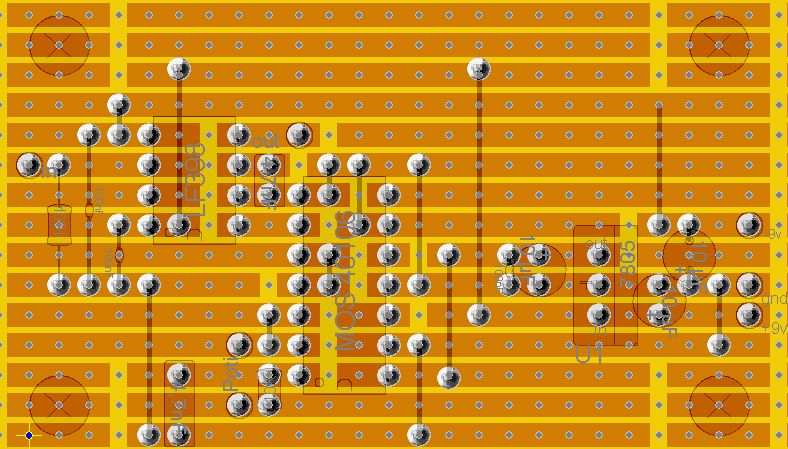

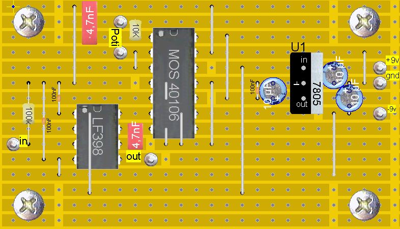

I did a simple LF398-version of the circuit. Works fine.
Mike
 Filesize:  76.74 KB
 Viewed:  1338 Time(s)
 Filesize:  94.71 KB
 Viewed:  1006 Time(s)
Last edited by modularkomplex on Wed Sep 05, 2007 10:42 am; edited 2 times in total

PostPosted: Sun Mar 04, 2007 5:24 am    Post subject: Reply with quote  Mark this post and the followings unread
Nice work! Well done & thanks for posting!
I'd been wondering on doing one with the LF398 - its edge triggered, right? So no need to make the trigger signal into a really narrow pulse..
http://www.bugbrand.co.uk

PostPosted: Sun Mar 04, 2007 5:44 am    Post subject: Reply with quote  Mark this post and the followings unread
Yes, no need of a narrow pulse here. And the other difference is the need of a hold-cap - the 100nF between the ICs. This should be much smaller than the stated 100nF, I think 0.1-10nF would perform better. I still have to do some experiments here.
Mike
PS: I've tested various values for the hold-cap. Best audible results are with 4,7nF. 1nF and lower will result in a whistling background-sound (but that could be from the used NPO - had no foil-caps left at these values). I've updated the above posted pictures.
