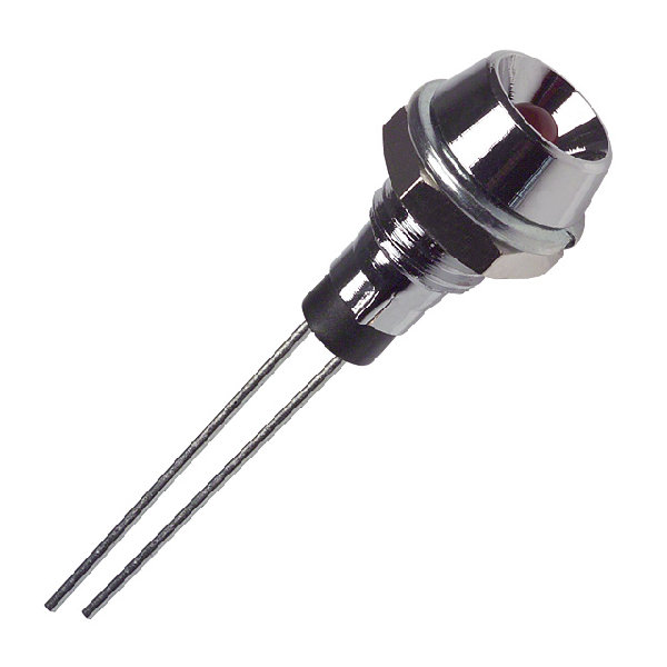

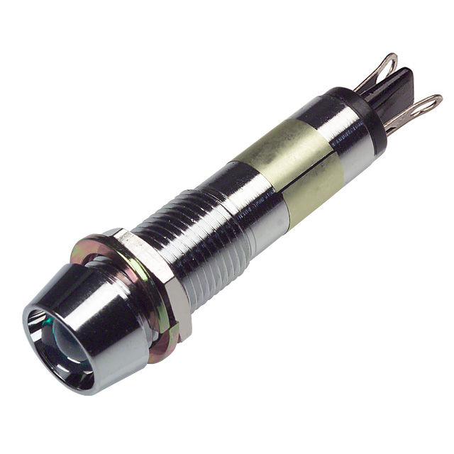

Viewing through digikey online catalog, i found these panel mount LEDs, which draw about 20mA each - therefore, i assume they are not applicable because of that..
Thanks in advance...

Here, shown below this message, are T-1 3/4 size LED's that are of the 2 MA low current type you need for hte Klee to work correctly. You can then use any LED holder that fits your fancy Wink I use the Cliplite LED holders. They work well. The attached data sheet will show you all the details. Just make sure you choose a holder that they recommend for the T-1 3/4 LED size. Also, be aware of the panel thickness when ordering LED holders so that they will "snap" of mount correctly. My panel thickness is 3 MM and they fit like a glove ! Digikey and Mouser both carry these "Cliplite" holders for these LED's.
GREEN:
Digikey PN 516-1327-ND
Mouser PN 638-HLMP-4740
RED:
Digikey PN 516-1325-ND
Mouser PN 638-HLMP-4700
YELLOW:
Digikey PN 516-1326-ND
Mouser PN 638-HLMP-4719
Hope this information will help you in your quest for LIGHT !!

Also, i believe Switches fonik used, do have pretty nice feeling touch, so i'd be interested using them as well... Would be more than glad if someone can point my nose to the source.
Just give Fonik a shout ........ he is a real nice guy and does not bite either Very Happy Very Happy Very Happy Very Happy Very Happy
Just another word on the LED's, whatever you do, don't use the 20MA low efficiency types with the 6.8K limiting resistors called out (you will see this on the schematic when you get it) , you may not get uniform brightness.

Bill, With the 2ma LED's you specified, you are not using any current limiting resistors?
Posts: 2810
PostPosted: Sun Mar 09, 2008 1:54 pm    Post subject: Reply with quote  Mark this post and the followings unread
Yes, as with any LED, you should use a limiting resistor. The forward voltage for this LED operating @ 2MA is 1.8V. Scott uses the CD4034 to drive the LED's and that IC puts out about 15V when using a 15V supply. He uses a limiting resistor of 6.8K. So, caluclating that LED current becomes easy: Vresistor=15-1.8=13.2
13.2V/6800 Ohms =1.94 milliamperes ........ just about right my man Very Happy

PostPosted: Sun Mar 09, 2008 3:21 pm    Post subject: Reply with quote  Mark this post and the followings unread
The LEDs I used are in fact the "20mA" ones, or something very similar. I didn't even look for low current types, 'cos I knew I'd have hassles trying to find them.
I found I could get those LEDs (they come fixed in that chrome holder, although you can punch them out and replace with other 5mm colours if you like) from Dick Smith for about $1 each. I bought 40 or so and then started testing.
Using a 15V supply and an array of 6K8 limiting resistors I found that with only 2mA going through them the brightness of the red ones was just fine. I hooked up 6 at a time and weeded out the 3 or 4 out of 40 which had an odd colour/brightness.
Scott actually used "standard" LEDs on his breadboard while testing the Klee. (a process which took a year or so) The main thing is to keep the limiting resistors at 6K8. This ensures that you won't cook your 4034s. These pattern LEDs really don't need to be very bright anyway, as there are often lots of them "on" and you only need to see whether they are on or off. They don't need to light up your studio/stage. Laughing
The 6 other LEDs are all driven by a 2N3904, and I found that the green version of that chrome bezel LED was quite dim with the 6K8 collector resistor. In this case you can drop the limiting resistor (as I did, to 4K7) as you're not stressing any chips in doing so. Wink

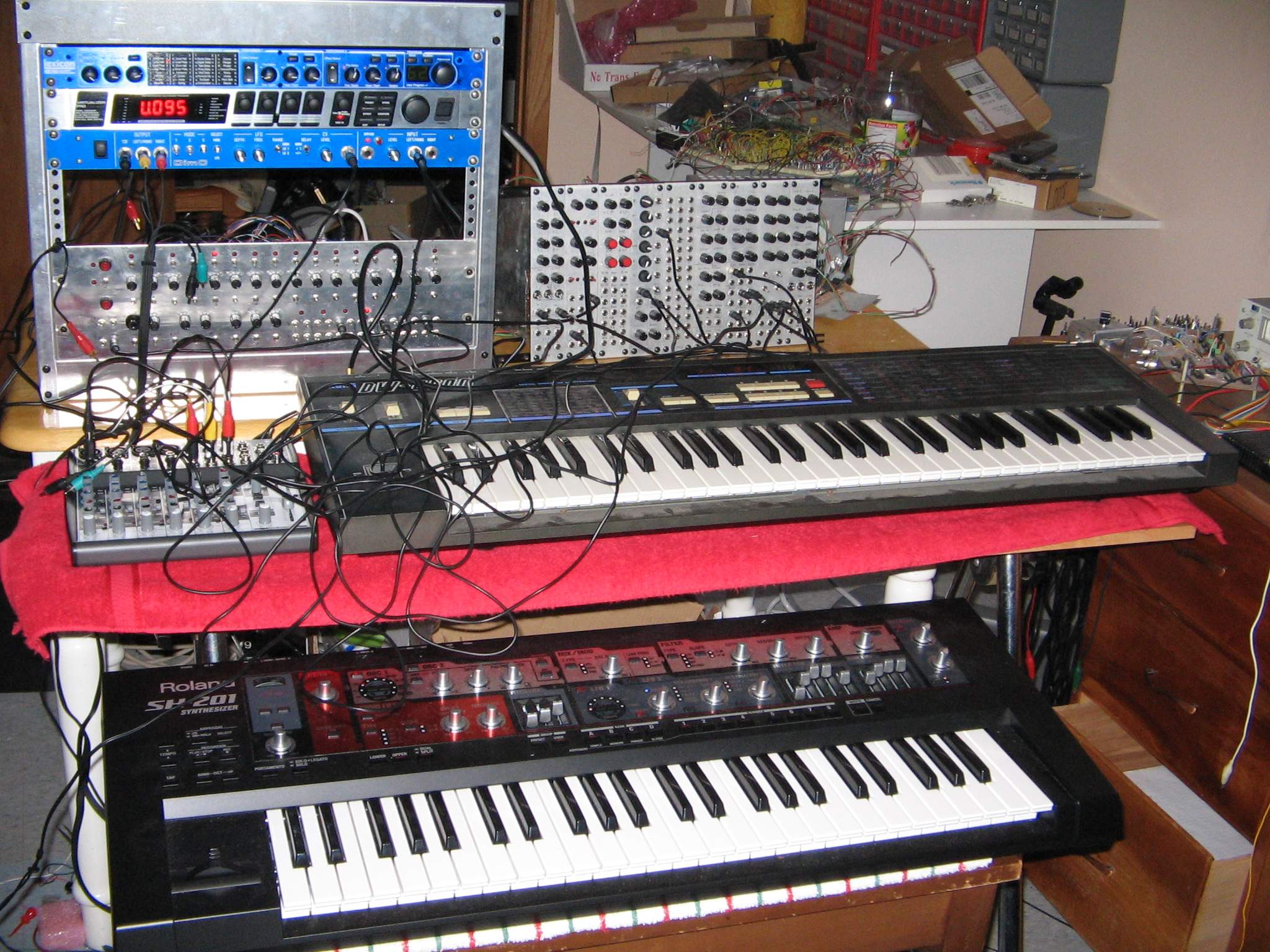

Uncle K and State Machine got it right - specifying 2 mA LEDs was a means to ensure people got consistent results. On the breadboard, I used regular old red LEDs - they were in a bag I got from somewhere, sometime. I was surprised at the brightness I got using 6K8 resistors, 6K8 being a much higher value than one normally associates with LED current limiting resistors. I was suspicious that perhaps other people would get LEDs that didn't perform as well, so the solution was to specify an LED I knew would work. I never tried green LEDs, BTW, if memory serves me.
Anyway, once I got the 2 mA LEDs to install in my Klee, I really couldn't see much of a difference, if any. Let me tell you, the brightness on the LEDs is just fine - they are no more bright or any less bright than the LEDs on my other equipment. I love watching that Klee run - you can just see the musical patterns it's batting around with the pattern and gate bus LEDs. Also, it's a real kick to turn out the lights and just watch the thing interact with everything else.
Here are a couple of pics of the Klee, integrated with some of my other stuff "Lights on" really was taken with a flash (it was daytime when I took the pic yesterday). "Lights off" is with no flash. You can see that the Klee LEDs are just the same brightness as the LEDs on the FX and synths. For the trivia lovers out there, to the right and in the background is the original Klee breadboard.
And, what the heck - here's a sample of what the pictured pic sounds like (after all, I'm logged in at a blazing 37333 bps). In this sample, the Klee is controlling the DSC2000 for the percussive sound, and it's also controlling the Dim C - take a look, you can see the Klee is patched into the Dim C control input. I have the Klee set so it rocks the voltage up and down sharply, and you can hear the rhythmic effect in the sample, synced to the percussive DSC2000. Recorded "live" (no multi-tracking or over-dubbing). God I love my Klee and Dim C.......
