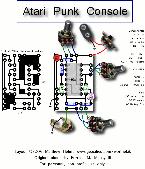

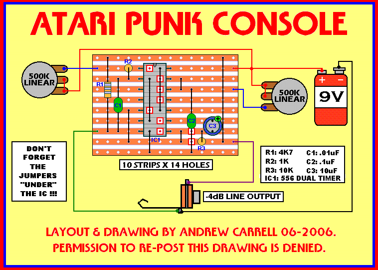

Does anybody have a vero layout for the 556 APC? the one listed in this thread has been taken down. I can’t seem to find any online. I’ve tried and failed to build the dual 555 apc. I’d really like to finish an apc successfully. I don’t know enough about circuits to attempt building a vero version from the PCB layout. Can someone help? I would be eternally grateful…
Danno Gee Ray
Joined: Sep 25, 2005
Posts: 1351
Location: Telford, PA USA
PostPosted: Mon Oct 15, 2007 7:07 am    Post subject: Reply with quote  Mark this post and the followings unread
I found these.

oootini
Joined: Oct 15, 2007
Posts: 80
Location: ireland
PostPosted: Mon Oct 15, 2007 7:34 am    Post subject: Reply with quote  Mark this post and the followings unread
thanks. i've found those diagrams too. the thing is that i'd like to see a vero layout for the 556 APC because i don't want to try and make a 556 vero one based on the above diagrams in case i get it wrong again...

 Filesize:  27.2 KB
 Viewed:  37995 Time(s)
 Filesize:  30.82 KB
 Viewed:  678 Time(s)
oootini
Posts: 80
Location: ireland
PostPosted: Wed Oct 17, 2007 7:03 am    Post subject: Reply with quote  Mark this post and the followings unread
cheerss steven. that second one was what i was looking for. i know what your saying about getting my head around circuits. for a first project i just wanna make some cool noises without worrying about how their made. thanks again...
