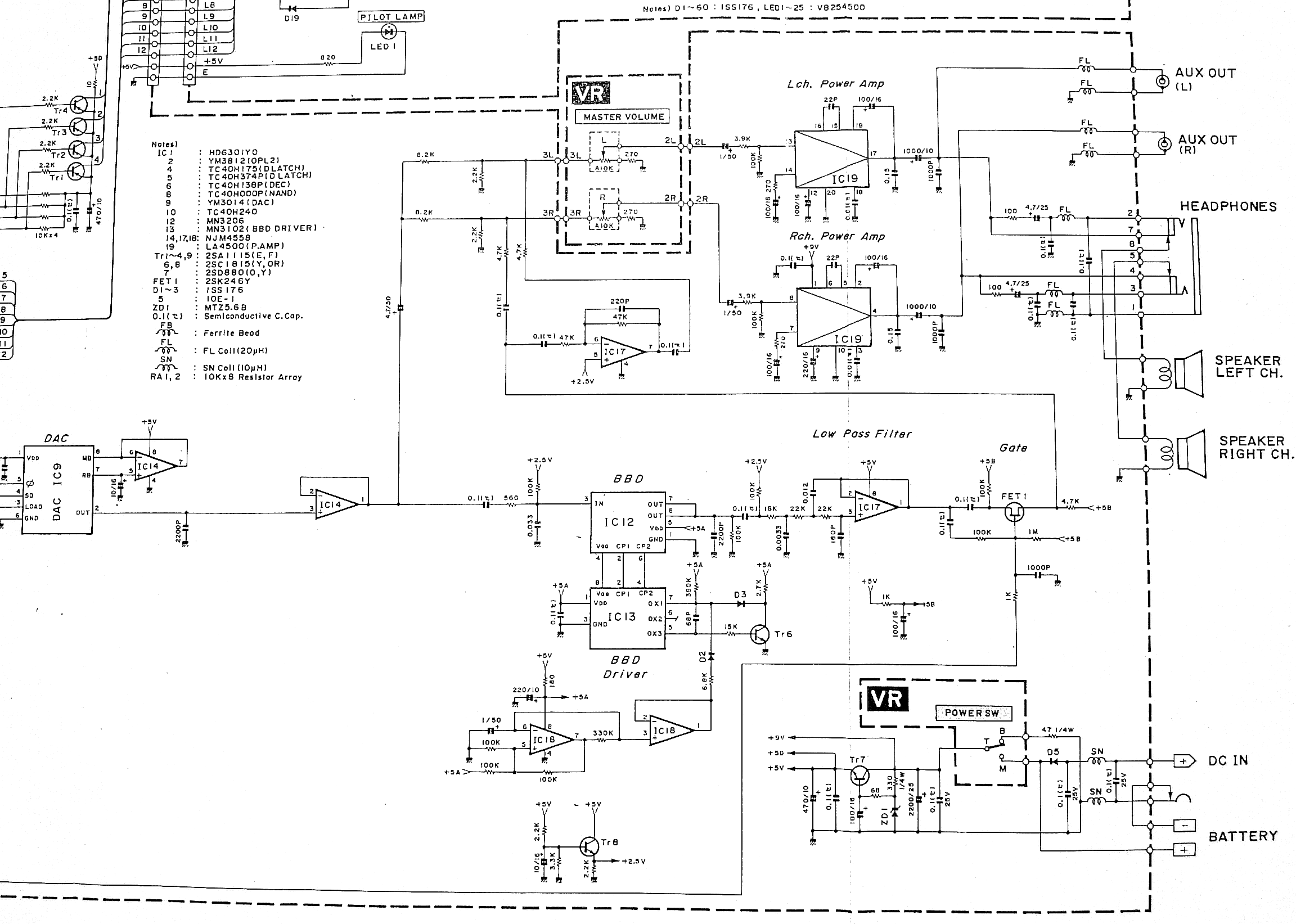

Okay, here's a digital pic of the LFO & BBD section of this board for bending purposes. Sorry about the quality, but hopefully it will do the job for now.

I replaced the BBD with an MN3207 and added a 47uF capacitor in parallel with the LFO's 1uF capacitor for MUCH slower modulation. It now gives a nice ambience/chorus effect that I like, sort of like the Roland Dimension C chorus. Interestingly it's completely mono-compatible (when the channels are summed, only the dry sound is heard, as the delayed sound is mixed in out of phase). I think I'll add an external input to use it with my 4-track.
I believe the modulation depth could be controlled by altering the gain of op-amp IC18A.

Thanks for the scan! I have a PSS-270 that seems to have the same circuit.
For fellow dial-uppers, I took some bytes out of your scan without reducing the size...

Hey PD: Glad you got something you like. An external input would be cool! Might have to watch the level and high-freq content from your 4-trk though, since there's very minimal signal conditioning on the BBD input.
Hey Ickystay: My pleasure. I was worried about readability because it's actually a digital pic, not a scan, hence the enormous size. But your reduction is still very readable. Thanks!
BTW, I have a PSS-270 also and the stereo symphonic circuit does look pretty much the same. No Digital Synth function on that one, but I wouldn't be surprised if the possibility for it lies dormant within the circuit. Somebody with more experience would be able to say, as well as give pointers on how to coax more settings from the sliders on the 460/470 (I've read somewhere there are more options).

Here's a 150dpi scan of it. Page 16 is the schematic diagram of everything. (Careful if your browser doesn't like really big images)

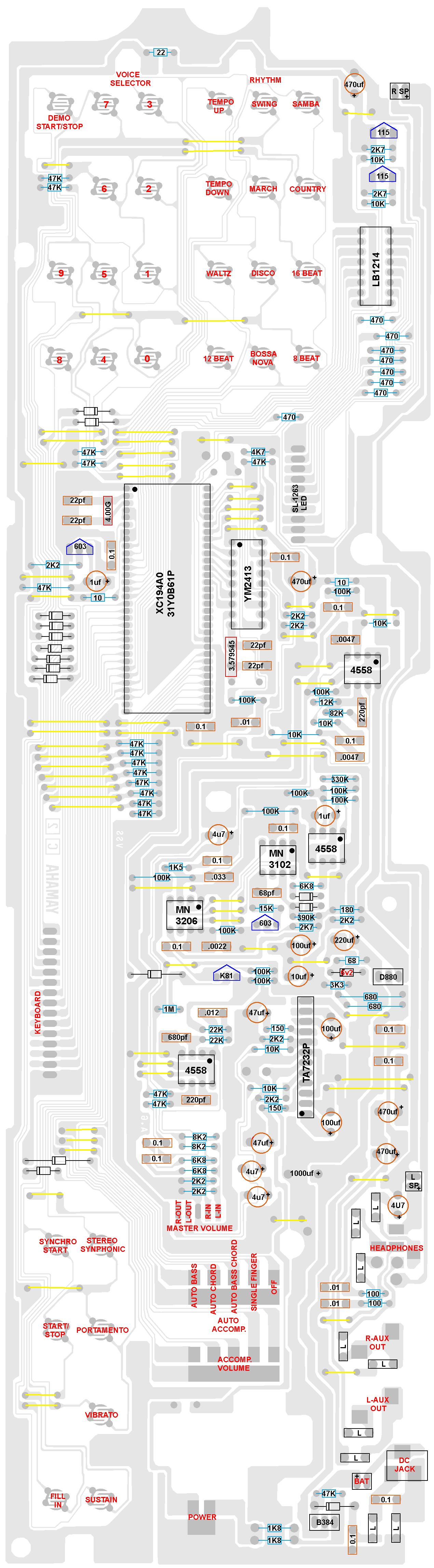

Edit- Attached a board drawing of the 270. Looks like a no-go on the added controls.

Glad to be of help guys! Nice work piecing the schemo together Paul, thanks. And thanks for the 270 board shot ickystay.
