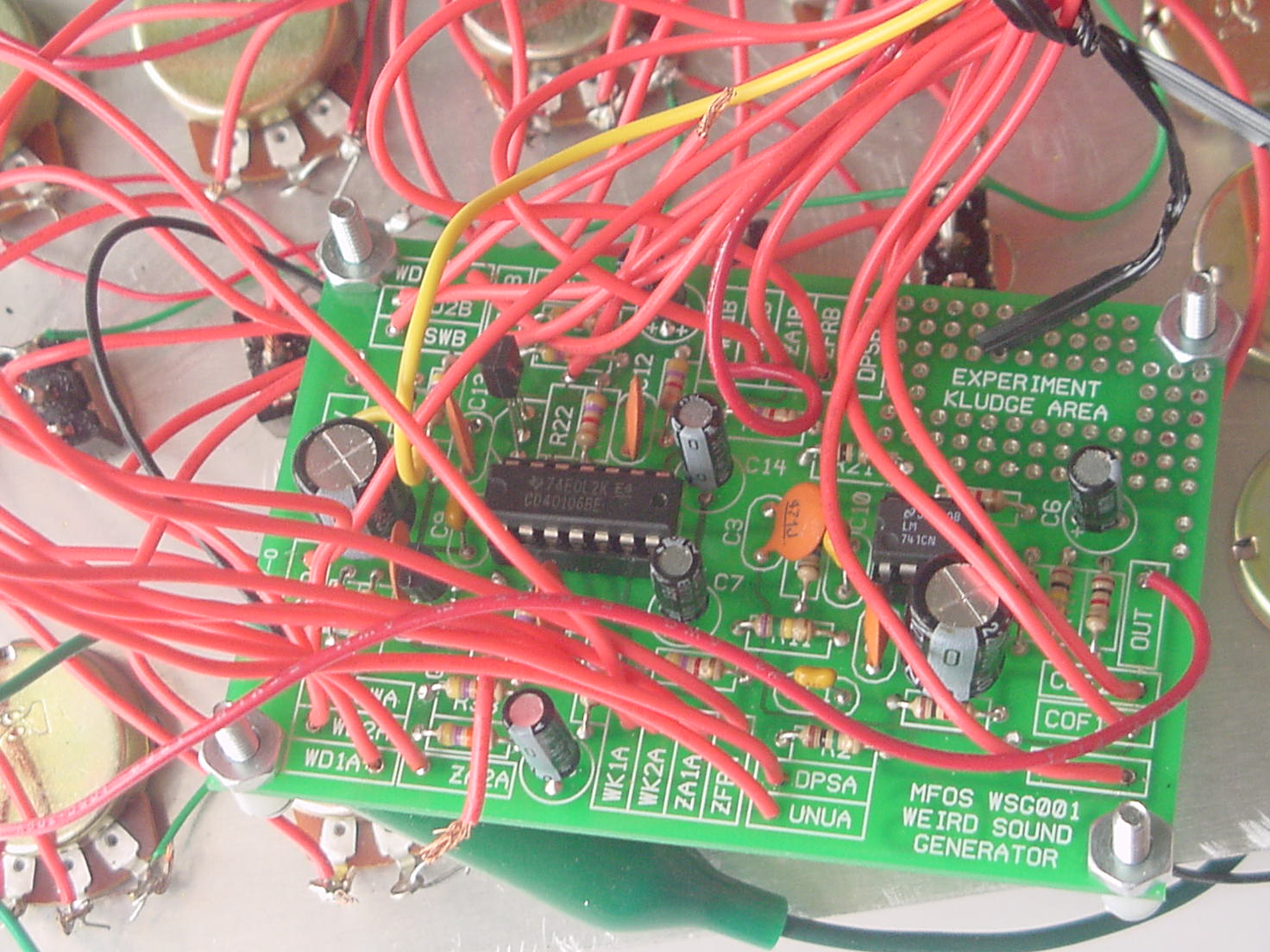

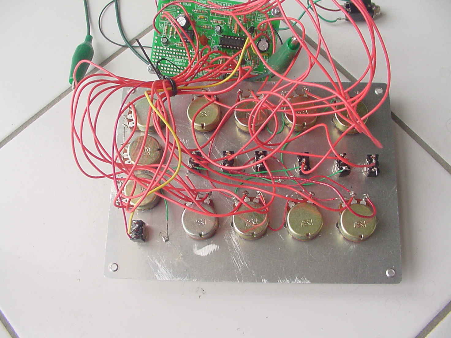

adhdboy
Joined: Feb 16, 2005
Posts: 57
Location: denver
PostPosted: Mon Oct 15, 2007 8:09 am    Post subject:  Take some pictures
Subject description: A picture is worth a thousand posts
Hi
Why don't you take some large, clear, color photos of the unit showing the front panel wiring the top and bottom of the PC board and the wires going from the pc board to the panel.
Maybe one of us will spot Shocked the issue.
Ray
There 10 kinds of people in this world that understand binary those that do and those that don't.
Tronato
Joined: Sep 21, 2007
Posts: 274
Location: Florida
PostPosted: Mon Oct 15, 2007 8:55 am    Post subject: Reply with quote  Mark this post and the followings unread
Hello:
These are the highest resolution pics I can achieve with my camera.
The green alligator clip is substituting the faulty SPDT switch.
The cabling doesn't allow you too much freedom nor allows you to see much... that's why the two 1 Meg resistors are underneath the PCB to allow easy connect / disconnect to circuit.
In any case there are maybe better pics of the PCB on page 2 of this post.
Hope this helps. If more pics are needed of specific things let me know.
Have a nice day!
Thanks
TRO
