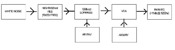

I have to preface this by saying that I'm a little more obsessed with sound of analog handclaps/"smashes" than most average humans. This is probably because I grew up in 80's listening to Yaz/Devo/Human League, etc. Lucky for me, Logic has the Ultrabeat drum synth which is optimized for this kind of nonsense. I have a favorite "handclap smash" sound that I use all the time. It started as one of their 808 clap emulations, but I tweaked it... the biggest thing I did was remove the three cycles of LFO amplitude mod that give it the "multiple hands clapping" sound; so it now it's a bit more like whipcrack. Blah blah, get to the point... bear with me.
I'd like to DIY a module to make this sound. Instead of making a module for my modular synth, I'd actually like to mount it inside my Pearl DRX-1 drum module. It's an obscure beast much like a Simmons SDS-V with kick, snare, and three tom voices, drum pad/trigger inputs, no MIDI (not for long!), and eight kit memories. The reason I want to build it into the DRX-1 is that I'd like to use it live.
So with all that established, I went ahead and reverse engineered the sound from Logic Ultrabeat (block diagram attached). I then set about recreating this "for real" on my modular. I used my Ken Stone digital noise> .com state-variable high pass>.com ladder filter with no res in 12/db oct mode >VCA. I also plugged the out of the modular into a Boss GE-7 graphic EQ stomp box for the boost (the freq wasn't right on, but it was close enough).
It doesn't sound exactly like Ultrabeat... as usual in real analog world, it sounds even better! And there's a fair amount of tweaking options with the filters and env settings. Gotta love modulars. Love using about $1500 worth of synth to make a clap!
But back to my point (I'm pretty sure I had one...).
Anyone think there's an easy way to build such a creature in a somewhat small and simple package? Roland must have, right? I'm just not sure what could be trimmed down. I tried using a single bandpass filter in place of the highpass/lowpass combo, both in Logic Ultrabeat world and on my modular, but in both cases, it didn't sound nearly as good (made it too middy, and lost lots of impact as a result)... maybe this could improved upon with the right bandpass filter.
I don't want this to be the kind of thing with a million controls; I was thinking just to have trimmers for cutoff/res and maybe it'd be cool to bring the env releases out to the front panel. Maybe trims for the EQ....
Any suggestions? Think this is too nutty for a small and simple thing?

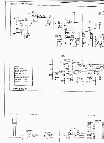

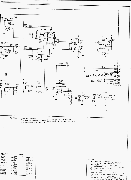

here´s the amdek/boss schemo if it could be of any help,
posted it to matixsynth some time ago...

Thanks, synth_ollie!

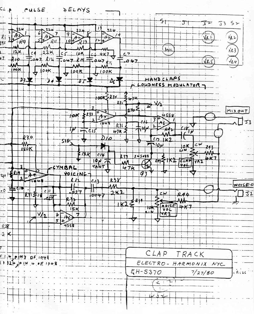

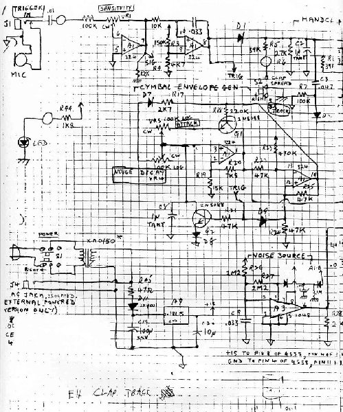

and the EH:

Interesting circuit. They use the micro to produce the multiple triggers required for the envelopes. Cool.
This is very, very similar if not partly identical to the 808 clap. Different noise generator, but the same envelope generator.
http://www.casia.org/modular/

Many thanks for the EH circuit - has anyone spotted the CA3094s ? Personally, any form of music that employs hand claps is to be avoided at all costs, with the exception of early Gene Vincent and Elvis!
