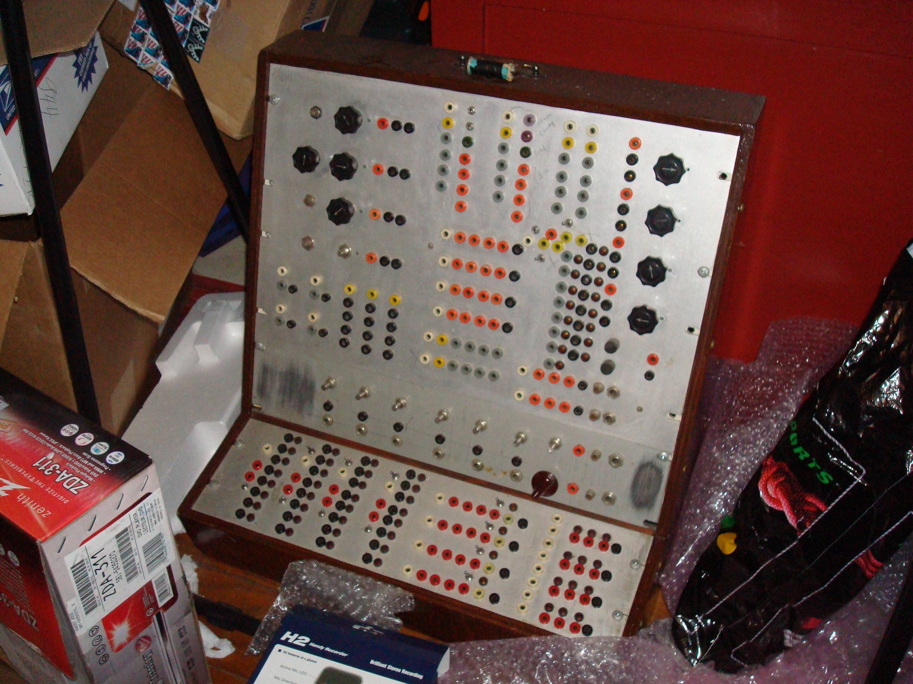

Sorry, I didn't see this.
Stan taught us about the joy of the surplus electronics stores, and he was into building really simple digital circuits that clocked at audio rates. For example, you make simple oscillators using digital inverters with RC networks. If you uses NAND gates instead of inverters, you get some sort of neat modulation when you hook up another oscillator to one of the free gate inputs. Run the osc into a modulo-N converter and you can get different pitches based on the code you put on the four inputs.
All these simple circuits, usually just one "naked" IC, are hooked up to banna jacks so you can make patches.
Shift registers were used a lot as were up/down counters, filp flops, and whatever we could find in the surpluss stores. We started with RTL, moved to TTL and then CMOS. Experimentation was the only rule.
Stan was always miffed that we called these instruments Lunettas. He said he felt honored, but he really wasn't the designer of them. He's great attitude made us want to call them Lunettas even more.
Most Lunettas probably don't exist any more because by their very nature they were never finished, but I still have mine. This was one of the fancy ones, included a lot of lights - means buffers - and even had built in stereo amp. Woo woo... Laughing
Mosc's Lunetta - circa 1971

I'm very interested. The second I saw that box with all those bananas and led's and stuff, I was instantly intrigued. Please share the build info.

I'm damn excited by this thread! I'd not heard of Lunetta before, but the picture of Mosc's old system makes me smile! A lot!
