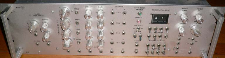

A friend of mine got these from U. Mass. decades ago and gave them to me to scavenge for knobs and switches. I'm about to dismantle them but am wondering if anybody here knows anything about this handmade gear. They don't seem worth reviving but they certainly are rich in switches and pots. This one has some nice small rotary switches too.

It's Daisy! Don't take it apart until you can find out if it works or not!
That is, I'm almost positive it's one of John Roy's Daisy units - pseudo-random multi-channel control voltage sequencers similar to the one I used at the CEMS studio at SUNY Albany in the 70s. John Roy was affiliated with UMASS, so this is very likely one.
If it still works, it would be a valuable device in any analog synthesis studio, and it's a piece of EM history besides - there can't have been more than three or four made. Please, try to see if it works or not.

More: It's been about 30 years since I used this, but I think this is how you can test it if you have any kind of VCO available.
The V and P outputs are Voltage and Pulse for each of the four channels. You'll need an 1/8" to whatever cable to interface with your VCO. Set the Clock Freq Range to somewhere in the middle, the first Time Base Select also in the middle, and the Clock Rate Switch to LO. Set the first Offset to zero, and the gain to 12:00. Flip up all the switches under the Sequence Length Thumbwheels, and set Sequence Length to just a few steps.
Patch the first V output directly into your VCO, and power Daisy up. Flip up the V Enable switch, and press Auto Reset Enable. If it's working, you should hear pitch changes from the VCO. Flip up the RAND switch, and you should hear random pitch changes.
If the first output stage doesn't work, try the others. If none work, just try wiggling the Time Base knobs around - it may be running at a very low rate. Or flip the CLK RATE switch up to HI.
Let me know if you can get it working, please.

Wow, what an informed group! Aside from the RSG panel there are two PWG-2 (has several step-level adjust knobs) and one M-AG-10 (M is for mixer and AG is for analog gate).
Restoring them doesn't seem realistic. There are parts missing, no documentation and I don't know what it supposed to do. I suppose all of that could be overcome but is it worth it? Richard seems to think so.

Historically, Daisy was among the first digital music devices intended to interface with analog voltage-control systems. Musically, it was a multi-channel control-voltage sequencer with the ability to generate randomized output - essentially, controllable outputs that never repeated. At the time, in the pre-computer era, this was a big deal.
I contacted my composition teacher, Joel Chadabe, the director of the SUNY Albany electronic music studio and designer of the CEMS, the world's largest integrated Moog modular studio. Joel was also a good friend and colleague of John Roy. I also met Roy as a student a few times. Joel tells me that John Roy passed away a few years ago, and that he made probably less than 10 Daisy units. He didn't know what the other units you have might be, so those might be a dead end.
But Joel did say that Daisy does still have value, even if non-functional. Joel is now the director of the Electronic Music Foundation, and asks that you consider donating Daisy to the organization, for which you would receive a tax deduction far beyond the value of the knobs. Please think about it.

I also wrote to Warren Burt, a fellow composition student of Joel's at SUNYA, now resident in Australia, about this thread. Here's his reply:
"Hi Richard!
It's definitely a Daisy. He should donate it to EMF. In the 70s we ordered 2 daisies and the gates unit from John Roy for the La Trobe Uni Studios. It was used to control our large Serge System, which I specified and built. A photo is attached. Eventually, the analog studio at La Trobe Uni was closed, and the equipment sold off. (This was in the mid-80s - La Trobe Music was shut down in 1999.) Then, around 1995, I was in the 2nd hand electronix junque shop run at the time by the Melbourne synth designer Paul Francis Perry. There, in the corner, was our Daisy! He said someone had gotten it from La Trobe, but had just traded it to him for some other piece of gear. I offered him $200 for it on the spot. He said, "Oh, no, not that much!" but I insisted. (This was in a time when I was freelancing and didn't have a lot of money.) I immediately went to the bank, took out the money, went back to his shop, paid him and got a cab home with Daisy in tow. The last time I used Daisy publicly was in a 1997 performance at Theatre of the Ordinary, Melbourne - an improvisational piece for Daisy and an Ensoniq EPS called "Daisy Feeds The Temporal Piano Attractor" which is on my CD "Four Experimental Computer Pieces 1995-1997, which is available at Tropicapricorn, my never finished website. Daisy is safely in storage in our garage. I last took her out of the box to check for damage (there was none) in February 08, after the big floods here, which hit our garage, fortunately without much damage to anything. But we did have to clean and reorganize the garage, hence I checked all the gear in storage. In 97, the last time I turned her on, Daisy worked perfectly. Whether the ensuing years have had capacitor death, I don't know. So there is a Daisy system in Russell Vale, New South Wales - she is not dead, but lies dreaming - as HPLovecraft said of Cthulu.
Warren"
