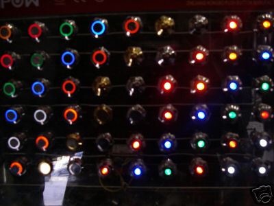

PostPosted: Wed Apr 16, 2008 3:18 am    Post subject: Reply with quote  Mark this post and the followings unread
i think i gonna plan my klee with this type momentary:
they have very nice look and feel of course,
and can be obtained with illumination as well.
they're costy but they well worth the elevator operator feeling! Cool Laughing

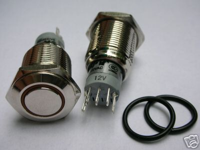

PostPosted: Tue Apr 29, 2008 2:41 am    Post subject: Reply with quote  Mark this post and the followings unread
Found the bezels cheaply online,
no need to buy them locally for twice-triple the price.
look on ebay for Item number: 290225273918
for about $11 for qty of 50, shipping included.
