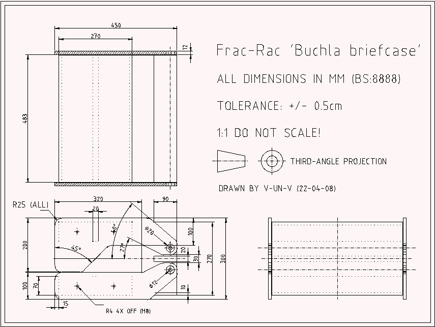

There comes as time where one has got to stop taking and give a little bit back. Well that time has come, and celebration of me coming to the end of my degree, I've been knocking up a little special 'something' for everyone.
I was blown away by GlassX's DIY Buchla cabinet (In fact one of the reasons for originally doing my industrial design course was so that I could afford a Buchla 200e!!). GlassX sent me his design, but I felt a little extra could be added, especially as now I am supposed to be a graphical computer draftsman.
This first offering is designed to be a three section dual-tier portable 'Buchla' cabinet for a Frac-Rack system. I chose Frac because it seems to be the most popular size for all those on a 'budget' as such- but you could always modify the design so it fits other systems, but as this one stands, each section is 19" across by 2x 5-1/4" high. (Please note that my drawings are in millimetres- as mm's are to British Standards).
However, this is not all. I am at present designing the same system in Solidworks 3D, (complete with STL files for direct input into a CNC mill & also, complete sheet metal drawings/ specifications etc), and will post this as soon as it is done (by this week end fingers crossed). If I can pull it off, there will be a 3D demonstration in Flash too (this is just to satisfy part of my dissertation!). For convenience, 2 drawings as png files are here, as there seems to be a bug with QCad v2.2.0.0 at the moment- Ribbonsoft are on to it apparently Very Happy Also included (hopefully, if I can get it to load) is a DXF file. This file may be difficult to open in ACAD (blame Autodesk!!), but it will open in QCad, and you won't have to buy QCad either just to open this file.

PostPosted: Tue Apr 22, 2008 7:58 am    Post subject: Reply with quote  Mark this post and the followings unread
Of course there is no way of stopping the existing design (above) from falling over- but I'll work on that Very Happy

This is fantastic, these drawings are great!!! Very Happy
I'm looking forward to the Solidworks stuff! This project was great fun to design and to execute, I reccomend it to everyone!

PostPosted: Tue Apr 22, 2008 9:11 am    Post subject: Reply with quote  Mark this post and the followings unread
A couple of updates;
1. The angle on the top half, right hand side cheek is partially obscured. This should read 40 degs.
2. The positioning dimensions of the main hinge holes have been accidentally ommited. These have now been updated in this new dxf file. Smile

PostPosted: Tue Apr 22, 2008 1:17 pm    Post subject: Reply with quote  Mark this post and the followings unread
This really incredible work, both of you.
I'm wondering though, where would you start, if you had these designs (as we now do), and no other design training. I downloaded the CAD/ST, I think it was, and was able to open Glass X's design. Not entirely sure what to do with it.
I'd like to render it into a real cabinet as Glass X has already done. I suppose I might just take the end panel dimensions to someone who cuts wood.
Is there an easy way to change one dimension (like panel height? I'm using 4 unit height for my modules), and keep everything in scale?

PostPosted: Tue Apr 22, 2008 1:29 pm    Post subject: Reply with quote  Mark this post and the followings unread
That's basically the idea, if you don't know how to read engineering drawing diagrams. All the arrows with lines, just tell the cutter where to fut the knife so to speak.
Hang in there, because the Solidworks version is on its way (it's looking pretty good already Smile ). I should mention now that halfway through my drawing for the 2D work, I switched from centermetres to millimetres, and this has confused one or two dimensions- I will fix this as soon as I've got a moment (or my ears aren't being burned by my wife! Shocked Laughing )
Tom

PostPosted: Tue Apr 22, 2008 1:38 pm    Post subject: Reply with quote  Mark this post and the followings unread
The Frac rack frames are significantly deeper than the Buchla so folding it up is not going to be compact. Is just for non-portable table top use or am I misunderstanding something?

PostPosted: Tue Apr 22, 2008 2:47 pm    Post subject: Reply with quote  Mark this post and the followings unread
yes you are right- there has to be a compromise in the design, in order for the unit to fold. In this case, (no pun intended!) it is the depth of the cabinet. The front panel height is measured for each cabinet to carry two rows of modules each, but the circuit boards will have to lie flat against the front panels. If I put the actual frac depth in, the unit would cease to be portable for obvious reasons.

PostPosted: Tue Apr 22, 2008 3:11 pm    Post subject: Reply with quote  Mark this post and the followings unread
I should also mention that the middle cabinet is slightly deeper than the top and bottom ones. This was mainly to allow for the PSU.

PostPosted: Tue Apr 22, 2008 6:02 pm    Post subject: Reply with quote  Mark this post and the followings unread
...the circuit boards will have to lie flat against the front panels.
So, what are you putting in it? DIY stuff? None of the Frac Rack modules I'm familiar with are flat like that. Cwejman maybe?

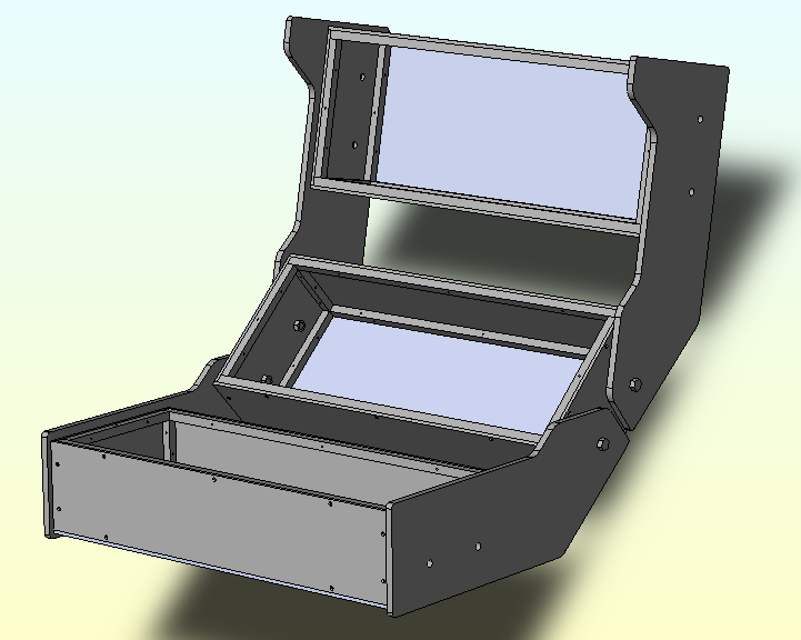

ericcoleridge contacted me off list and suggested that the boats could be made from wood- 4mm ply in fact, instead of sheet metal (although I can very easily do sheet metal if anyone wishes- in fact it is easier to do metal than wood!. Wood was a wise choice also because it means that almost anyone can now knock one of these up- providing they read from the plans. At the moment, as you see, I have a case that looks like a 200e but because I was going by eye, some of the dimensions are a bit strange to say the least!
The boats are 178mm high and 100mm deep. This makes the cab look lop-sided, but then the 200e is probably full of surface mount components and therefore only needs a shallow box.
I won't have this properly finished for at least another 3 or so weeks, but here's a preview of the thing in Solidworks, opened out.
 Filesize:  60.18 KB
 Viewed:  599 Time(s)
