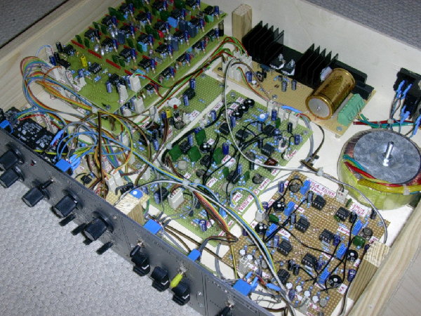

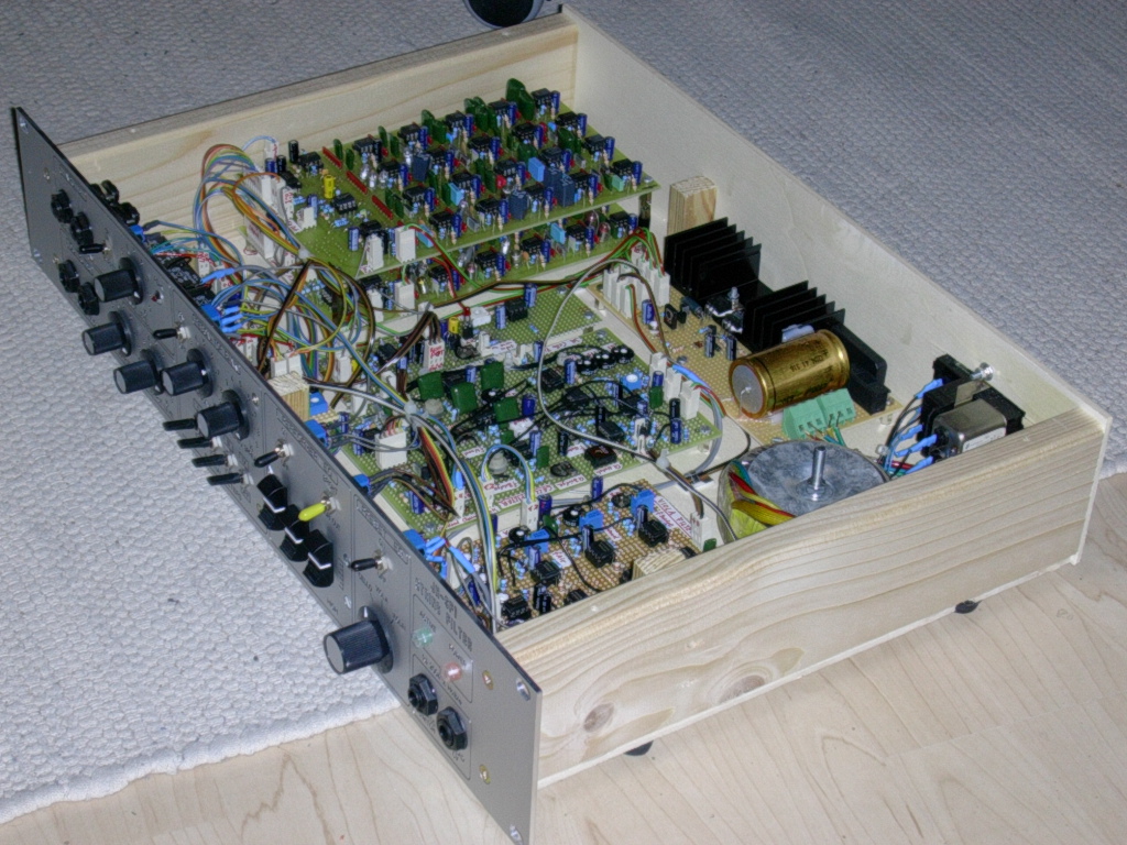

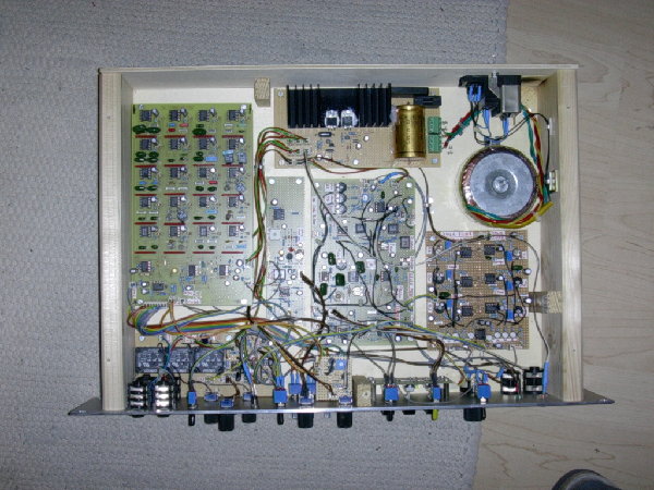

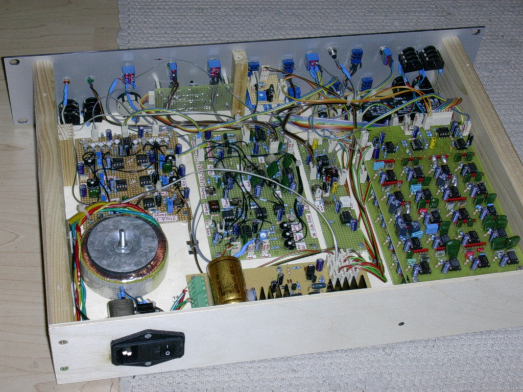

germaniac wrote:
Will your PCB include all those features? (The stereo spread control especially interests me).
The two boards that are stacked on the left side are the 40 BPF filters.
That'll be the main thing on the new boards, too. Plus, I add some of the overall circuitry, like feedback control, stereo spread, etc.
The plan is to have a self-contained 40-band filter with just these two boards. This is enough to get the effect demonstrated in this sample:
http://jhaible.heim.at/string_filter/jh_string_filter_resonance_ob8.mp3
For (more or less) realistic emulations of string instruments (like in th esecond part of this sample: http://jhaible.heim.at/string_filter/jh_string_filter_benadecello_cs50.mp3 ), you need the 40-band filter plus a few broader resonances that I have created with a 3-band parametric EQ for each of the thre "presets", violin, viola and cello. (Thats the big veroboards with loads of trimpots).
Now, I expect much bigger interest in the 40-band filter than in the preset section, so I think I'll offer the 40-band filter PCBs separately. (Actually, these will be two equal boards for 20 bands each.)
I'm still looking for the best solution of the Para EQ stuff.
Maybe I'll make it part of the "Famous Fixed Filters" project.
Maybe I'll recommend using the Moog Parametric EQ board for this.
Maybe most buyers of the 40-band Filterbank have enough means for parametric EQ-ing already, and don't need a dedicated board for this at all.
I'll try to find out. Smile
Meanwhile, I concentrate on the heart of it, the 40-band Filter Bank.
Back then, I used a design I thought clever - only to find out that it only was stable with NE5532 chips of a specific date code. Mad That's why I didn't publish the old PCB layouts in the first place.
Now, I go for a different circuit topology, that also has a lot of benefits over the typical single-opamp solutions.
These will be 2-opamp biquads, which utilize a negative resistance to create a non-inverting integrator. (Also known as Deboo-integrator).
The main benefit of this - apart from it's low noise - is the low reistor spread, and zero capacitor spread. Which means, you need a lot of ...
Any special parts one might start sourcing for the future?
... 10k resistors! Smile Smile
Yes, you need about 160 of these.
The layout will be such that you can either use ordinary resistors, vertically mounted, or 8-pin SIL resistor arrays. (You can see these components - in red - in th eold version, too.)
Don't worry, no obligation implied).
I'm pretty sure that I'll make this available, if these is enough demand.
JH.

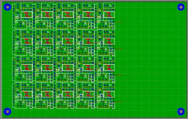

I plan to make the String Filter the next in line, after the Frequency Shifter and the Tau Reissue.
Board design is in a state that I can see where it's heading.
The 40 resonators will be distributed on two boards, as intended.
Also, there's the stereo spread stuff, a voltage controlled resonance, and an optional limiter.
The VC resonance will need a transistor pair like the LM394 or SSM2210 or MAT-02, or a selected pair of cheap NPN tansistors.
That's part of the whole concept, and therefore required.
The Limiter will need a Vactrol. I have yet do find out which type will work best, and the circuit can be adapted to use different types, too. It's a rather simple limiter - just to prevent harsh sounds from overdriving.
The Limiter is optional - you can simply omit the Vactrol and a handfull of passive components if you don't need it.
The Body, bridge and Air resonances for emulating "real" string instruments are not part of this 2-board project. That will be a different project alltogether, and will be handled separately in the future.
Each of the 40 resonators also has an individual output where you can connect whatever you want. If you like extemes, you can connect 40 slider potentiometers here and control each band separately.
If you want to do this, you have to wire the required passive components separately, though. (like, coupling capacitors to prevent DC on the potentiometers, summing resistors, and so on.) My boards will provide rudimentary means to go into that direction, i.e. it makes such a modification easier; but it will still be a modification, and not for the faint of heart.
All in all I'm getting along fine with this project - I'll even be able to include PSU electronics with heatsinks on one of the 160mm * 100mm boards. Unlike the Krautrock phaser, you'll have to wire the fuses off-board this time, however.
JH.

Update
PCB design finished.
Prototye board ordered from Olimex.
Updated and re-located String filter page:
http://www.jhaible.heim.at/string_filter/jh_string_filter.html
(Contains screenshot of PCB design.)

Even though this project is somehow related to the Moog String Filter, it's not a copy, but developed separately, albeit AFAIK going back to similar sources. My main sources are:
Ian Fritz, "Filter Bank Design", Electronotes EN#107,
Bernie Hutchins, "A 39-Channel Variable Q Filter Bank", EN#115,
Arthur Benade, "Fundamentals of Musical Acoustics" 2nd edition 1990.
The filter choice for the 40 BPFs (State Variable with Deboo-Integrator) is my own.
You can read all about it on my web site http://www.jhaible.heim.at/string_filter/jh_string_filter.html , which also shows some intimidating photos of the old version. Smile
The new version will consist of only 2 boards (or 3, depending on what you need).
Board 1 + Board 2 contain the whole 40-band filterbank part and the power supply (less mains transformer and fuses), with voltage controlled resonance and an opto-electronic limiter.
You can create sounds like this with Board 1 + 2:
(OB-8, first dry, then filter bank switched in, then resonance increased. Demo is from old version.)
http://electro-music.com/forum/phpbb-files/half_of_jh_string_filter_20band_113.mp3
(That's something with Board 1 only - 20 Bands)
And then, with some extra equalization, you can turn a synthesizer sound into a string-like sound like this:
(CS-50 dry first, then thru filter bank and Cello EQ)
The extra equalisation will be available later, on a separate board (Board 3).
I'll keep this separate, because I expect more interest in Board 1 and 2 than in Board 3, so maybe I'll combine Board 3 with something else, like a vocal filter (VP330 human voice maybe - this will be decided later.)
I think it's also possible to do the extra equalization with outboard equipment (parametric equalizers) - the filter bank is the tricky part, and that's what you buy with Board 1 and Board 2.
Right now, I'm taking pre-orders for Board 1 and Board 2 only.
I'll wait a couple of weeks before I put my order to the PCB house. It will probably take a couple of months before the PCBs are ready for shipping. But I need binding pre-orders now, to calculate if the project makes sense at all. You don't have to pay anything now - I'll only send invoices when I actually have the boards ready for shipping.
I'm only selling the printed circuit boards (PCBs) for this. You have to buy all the necessary components yourself.
I'll provide information how I've built my own string filter, using these PCBs (schematics, component overlay, BOM, etc.).
And I'll answer questions about it in this forum:
http://electro-music.com/forum/topic-20360.html
(I've you've sent me a mail before, showing interest in this project, please send an official order mail as described below, nevertheless.)
If you're interested, please send the following order form including the email subject line (important!), with the quantity you want filled in:
(just copy and paste the text, and fill in your personal data.)
Email subjet line: "String Filter PCB order [n] sets of boards"
Email text:
I'm ordering [n] sets of 2 PCBs for Board 1 and Board 2 of the JH String Filter project (the 40-band filterbank part)
for EUR 54.00 per set of boards,
plus EUR 8.00 for shipping and handling per order.

I've skimmed over this thread and I must say that this string filter thingie is just about the best thing since sliced bread! The audio sample was very convincing as are the comments and order requests of others.
I would like to make a simple version of it in ChucK as part of my guitar effects processing software, just to see how it sounds. I'm thinking that for a guitar I'd only need about 10 or 20 filters ranging from 80 Hz to 1.5 kHz. I'd use ChucK's BPF (band pass filter) model and put them all in parallel, neglect the additional instrument-simulating filters, and set the Q of each filter. Is that correct? If so, at what frequencies would I place the filters? Are they spaced logarithmically in frequency as you'd expect? If so, could I put them at 80 Hz, 160 Hz, 320 Hz, and so on? Also, what value of Q should I set the filters for? Oh, and more importantly, do you think the filter would be any good as a guitar effect? The guitar is already a string instrument but this filter might add sustain to each note for example.
Sorry if I should have learned the above from the web page or the thread. This thing is so cool that it must be ChucKed!

I've just recorded two short demos with the String Filter prototype.
First one is a fast Arpeggio from the OB-8, first dry, and then with String Filter switched on and off, and Resonance altered:
http://www.jhaible.heim.at/string_filter/jh_string_filter_2008_1.mp3
Second one is a String-like OB-8 sound, made more string-like with the String Filter Smile
Switched on and off between phrases, to display the difference:
http://www.jhaible.heim.at/string_filter/jh_string_filter_2008_2.mp3
Note: Unlike the older sample ( http://jhaible.heim.at/string_filter/jh_string_filter_benadecello_cs50.mp3 ), the above has *no* Cello pre-equalization (yet)!
String Filter web page is also updated (with the two new samples and pictures of the prototype):
JH.

Floppy wrote:
hello Jürgen
could you estimate how much the costs for all the parts are ?
maybe you could also name me a company where i can order them.
I haven't started with a BOM yet.
But I'll give you a rough overview:
You need 40 multiturn trimpots, 40 TL072 chips and 80 capacitors (10% tolerance or better) for the filter bank. Plus some extra opamps and one LM394 or similar dual transitor for the VC resonance, stereo spread, etc.
Plus a multitude of resistors and 100nF bypass capacitors.
Resistors: I recommend using 8-pin SIL arrays with four 10k resistors each; you need 40 of these. Alternatively, you can use 160 vertically mounted 1% metal film resistors of 10k.
If you want an optoelectronic limiter function, you need a VTL5C3 Vactrol.
(This is optional.)
JH.
