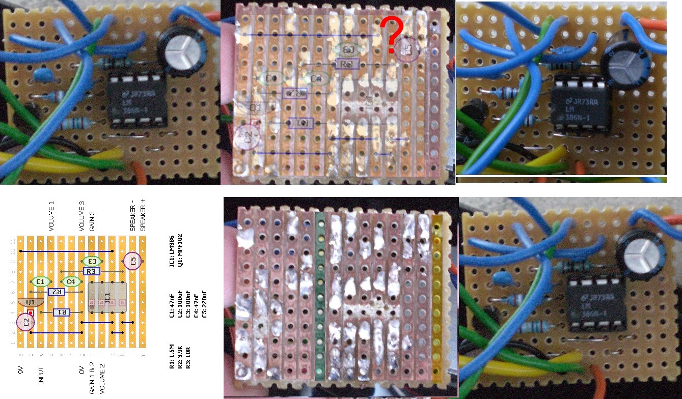

You do have the cut at b4?
Your 386 is the right way around?
The MPF102 is around the other way to what is shown on that stripboard layout?

Yes, I've double checked all three of those.
Is it significant that on both builds I seem to have too much voltage going to the Source pin on the FET? All the other values seem to be in the correct ball park. On the last build I had some buzzing coming from the speaker, on this one I have nothing so maybe I have made an additional error to the one I made on the last build?
I'll double check for cold solder joints when I get home as, for some reason, I found it hard to get the solder to stick to the copper rails than on the previous build.

PostPosted: Wed May 28, 2008 1:06 pm    Post subject: Reply with quote  Mark this post and the followings unread
Ok, here are the pictures:
I'm afraid I don't have time tonight to desolder all the wires, so it looks a bit of a mess from the component side. If you need me to I can desolder the wires tomorrow evening.

PostPosted: Wed May 28, 2008 2:38 pm    Post subject: Reply with quote  Mark this post and the followings unread
It looks like C5 is soldered in wrong?
I don't see it go to k9 (at the dot of the question mark)
And here is an image that made it easier for me to search ...

PostPosted: Wed May 28, 2008 3:31 pm    Post subject: Reply with quote  Mark this post and the followings unread
Wow, what an incredibly useful picture - thanks for taking the time to do that!
Fixed the C5 cap. Looks like that was an oversight on this build as I had it in the right place on the previous build. I had to take the cap from the previous build as I had cut the legs too short on this one. Unfortunately I've now got the same result as I had on the previous build - I get a buzzing sound when I turn both pots right up and clicks when I tap anything metal like the on/ off switch; the jack; or the guitar strings when I plug the guitar in.
One thing I've realised is that the C5 from the previous build (that is now in this build) was put in the wrong way originally, i.e. I had the polarity round the wrong way. Could this have damaged it significantly? Maybe I should buy a brand new one and try that tomorrow (eesh, this amp is becoming expensive!!).

I've just managed to put the C5 cap that was in the current build in the right holes - i.e. I'm using a cap that I know hasn't been put in the wrong way at any point in its life, so should be working correctly. Unfortunately I still have the same buzzing results.
Posts: 24489
PostPosted: Wed May 28, 2008 3:52 pm    Post subject: Reply with quote  Mark this post and the followings unread
C5 will not be damaged, anyway you are getting hum and crackle, so you do have low and high frequencies and amplification ... what happens when you take a small metal pin and touch pin 2 of the 386 chip with it (maybe disconnect the wire that goes from there to the volume pot temporarily). When you get increased hum the 386 part seems to be working, it already does seem so IMO, but just to be sure.

The buzzing and clicking all sound very good for this circuit when there is no input connected. So I'd be checking the front end. Check that your guitar cable is okay and that it works when plugged into another amp.
I'm suspicious about the point where your input is soldered to track C. The solder blob looks very close to shorting with track B. I also don't like the look of some of the track cuts. Make sure none are connecting to anything they shouldn't be. Especially that track C is not shorting to either of the track B parts or track D.
I think we've got this fault on the run. Very Happy

I've tried it with two different cables with the same results. The clicks occur when I touch the guitar strings so there must be some signal coming from the guitar. Does the fact that it clicks whenever I touch anything metal (ie. the metal on/ off switch or the input jack) mean that I haven't grounded the circuit properly?
PostPosted: Thu May 29, 2008 1:37 am    Post subject: Reply with quote  Mark this post and the followings unread
I'd say the buzzing and clicking when touching various metal parts points to the input not being tied down. ie: if the input isn't connected properly there will be no path from the input connection to ground, and therefore the input will act as an antenna. If the input is connected directly to ground you should get ground - nothing. If there is a guitar pickup between the input and ground you'll get the guitar signal. If there is no connection at all between the input and ground, you'll hear a lot of mains hum, static discharges, radio frequencies, Pink Floyd bouncing off the dark side of the moon, various Satanic transmissions from somewhere inside the Vatican, Cliff Richard, etc. etc. etc. (the last two sound very similar actually Shocked )
And it sounds like that is where you are now. Make sense?

Wow, it works!! Can't believe I'm finally hearing my amplifier work! Turns out I did in fact have the wires soldered onto the wrong points on the 1/4" jack socket.
Thank you so much everyone who offered advice in this thread - special thanks to Uncle Krunkus and Blue Hell who persevered with me right to the end!
