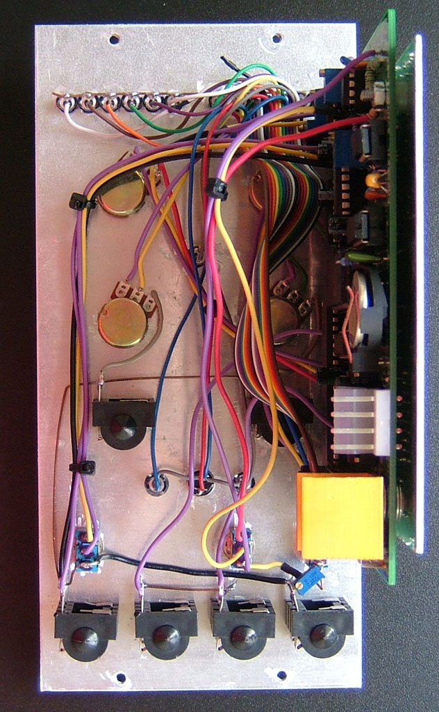

I finally started to build the Quantix-8.
I have some question:
1)
U19A is a unity gain inverter ... as most VCOs on the market provide down saw waveform
instead of upsaw , you may want to bypass U19A (= bad idea) or to add a switch to choose
direct or inverted input...
I can't find an easy way to do this with only a switch, I think I have to switch
from direct to inverted input but change the configuration of the opamp too.
Am I right?
I find easier adding another opamp in an inverter configuration and bypass
it with the switch.
2) Sorry for this one, but I have to ask again wich opamp to use that is better
than a TL072.
I will use the Quantix-8 mostly as a Wavetable,
and in a less degree as a sample player and quantizer.
So, low offset is not too important (I think), but good sound is.
I can't find most of the opamp from the list Marc post.
At the moment my options are:
LF442
4558
CA3240 (I was referring to this in my previous post, but I mistyped 3140)
NE5532 (I will try to avoid this because the current consumption).
I know I could try to find wich one sound better by myself, but most of this
opamps are expensive (especially where I live), and are from different
stores, so any advice will be very helpful.
Thank you.
Sebo

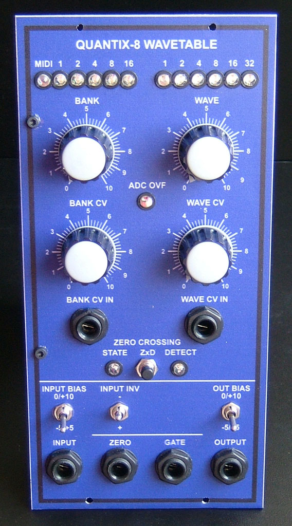

I just finished the Quantix-8, it is working, I managed to solve most of the
issues I had, except one or two.
I want to detail the mods I did and the solved problems I had.
First I uploaded a Bank and downloaded it without problems, then tried to
do the same with a full wavetable, but here is my first big problem, for
some reason the banks don't change when upload/download the wavetable,
so it uploads all banks to the same bank in the Quantix, and downloads
only the current bank again and again when trying to download the
wavetable.
The Banks change OK from the frontpanel and from CV. I think could be
something with the configuration, as I haven´t had much time to learn to
use the software editor yet. Anybody can help me here?
I installed the battery and checked if the RAM retains the data, all OK here.
One note here, I used a compatible RAM that the guy at a local store sold
me, it is working right, I don't have the Quantix here, but I will post wich
RAM is, in case somebody wants to know.
Then I calibrated the output as 1V/Oct, I didn't have any problem here
except that the output is inverted!!! 0V is at highest note and 10V at the
lowest.
I don't think this is normal, but I don´t care much about it by now, in any
case I will invert the scales.
Next I Checked the clock of the ADC (I used the ADC0820, and installed
the 1K trim), it was really high so I turn the trim all the way up, but the
clock still a little bit over 600KHz, at this point the ADC wasn't working.
I changed the trimm for a 1K6 resistor without luck, so I changed it for
a 2K resistor and the ADC started to work, but very erraticaly, the
waveform lost bits, and the RAM got corrupted (when I downloaded the
bank I saw the same missing bits as in the oscilloscope). I started to think
the problem was the RAM, but finally changed the resistor for a 2K7 one
and all started to work correctly.
The clock is running at 417KHz aprox (I used the grid of the oscilloscope to
calculate the frequency), is this frequency too low? I could try a 2k2 resistor,
but since it is working now I want to keep it that way.
Next I calibrated the input, I did the mod to switch between non inverted

Hi:
Here are some pictures of my finished Quantix-8.
Are there any news about the issues I posted before?
None of them are taking my sleep away, and the module are working good apart
from that, but I want to get it to work as it should.
Thank you Marc for this great project.

Hi Sebo, so in the end, what's behind your INV switch ?
Sebo
Joined: Apr 27, 2007
Posts: 564
Location: Argentina
PostPosted: Sat Jun 27, 2009 2:47 pm    Post subject: Reply with quote  Mark this post and the followings unread
Hi:
Sorry to take so long to respond, but for some reason I didn't get a notification in my mail.
I ended doing what Marc said, I changed R54, R55, and R57 by 100K, but
kept R56 Trim at 10K (I didn't need much gain as my modular works at 10 Vpp).
I pulled a the leg of R54 connected at the out of U19A, and inserted wires there, going to a double inverter switch.
In one position the out of U19A is connected to R54 (non inverted input) in the
other position the input is connected directly to R54 (inverted input).
Hope I explained it well (sometimes my english is hard to understand).
Also I'm using it a bit more, and I love this module. I love to use it as a waveshaper.
I did a track using it as a distortion waveshaper, and the texture I get is amazing.
Sebo
