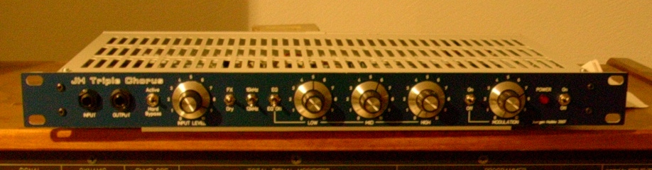

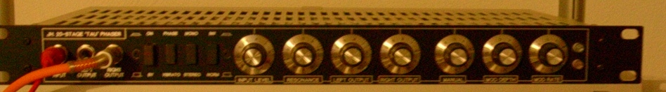

I guess I just start posting pictures. Smile
Sorry for the low resolution.

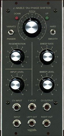

PostPosted: Tue Feb 19, 2008 3:37 pm    Post subject: Reply with quote  Mark this post and the followings unread

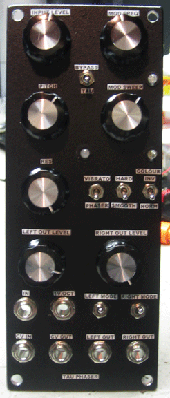

I built the JH-Tau-Phase and add it to my yusynth modular, here is the finished module :

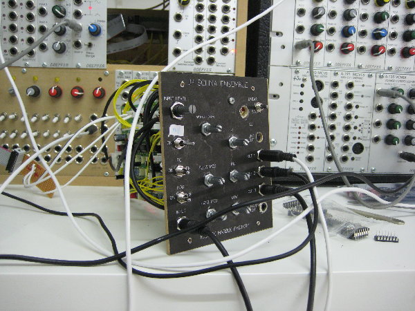

Hi, I thought I'd treat ( Wink ) you to a photo of my Frac Chorus in a temporary panel for testing, hope you like,
Usine
Paper and MDF

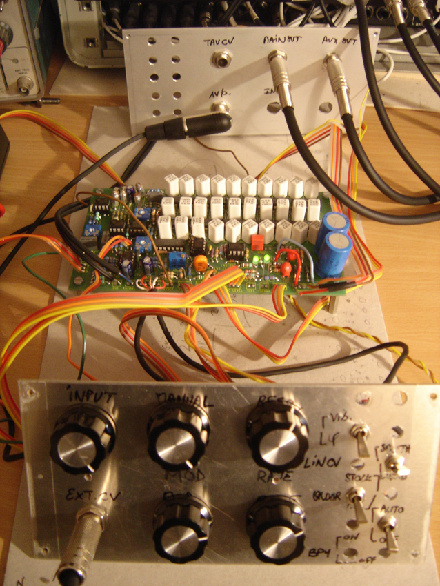

PostPosted: Mon Mar 17, 2008 4:41 am    Post subject: Reply with quote  Mark this post and the followings unread
Big caps tau !
Cool

funkyfarm wrote:
Big caps tau !
Cool
Polystyrene?
JH.
funkyfarm
Joined: Jan 21, 2007
Posts: 583
PostPosted: Mon Mar 17, 2008 4:50 am    Post subject: Reply with quote  Mark this post and the followings unread
surely...1% type...the last forth row is under the pcb Embarassed

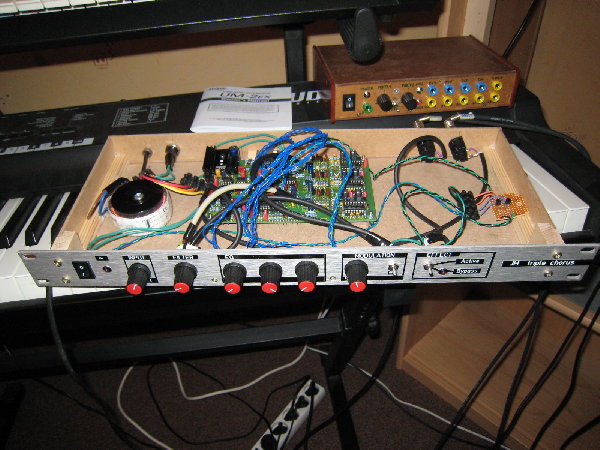

PostPosted: Mon May 05, 2008 12:10 pm    Post subject: Reply with quote  Mark this post and the followings unread

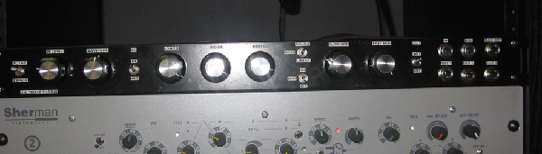

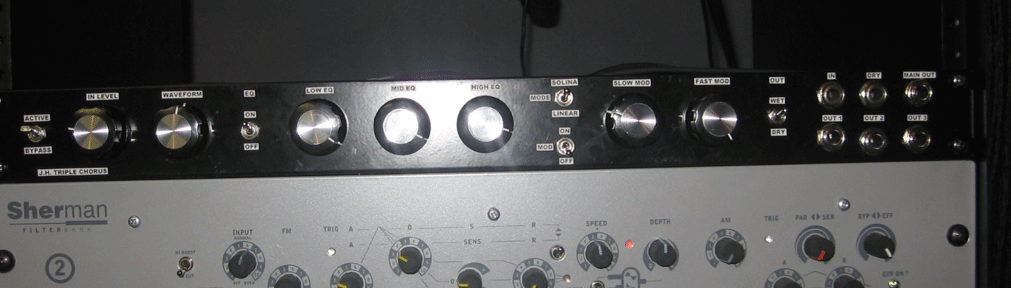

My "traditional" triple chorus in his cas (1U rack) cool.
Thank you Jürgen,

PostPosted: Mon May 05, 2008 2:37 pm    Post subject: Reply with quote  Mark this post and the followings unread
Nice to see somebody else combining a wooden enclosure with a metal front panel. I did this a lot myself - it's unexpensive, and in the rack , you only see the front panel anyway.
Keep those pictures coming, of what you've built!

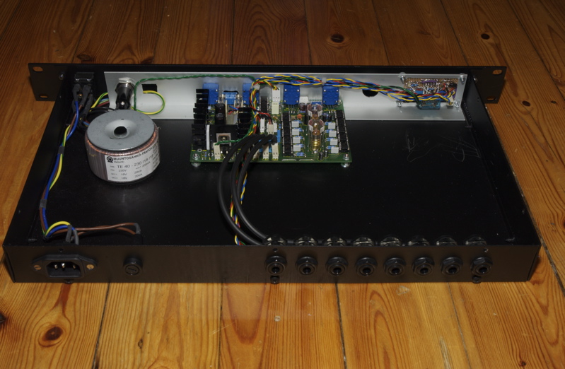

PostPosted: Mon May 12, 2008 3:52 am    Post subject: Compact clone Reply with quote  Mark this post and the followings unread

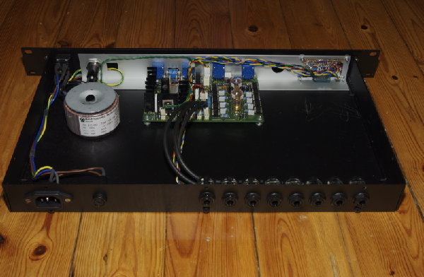

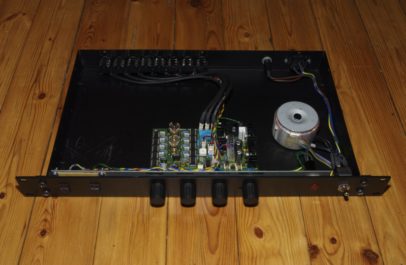

Hi all. Here my 1U rack version of Compact clone and first post to the board.
I've added some extra features here. The manual switch is done with the same relay + CD4007 circuit as in the bypass switch. Mainly for looks of the front panel... Wink
On the back there is two extra jacks for CV IN to drive lamps with sequencers etc. (as JH mentioned over here) and CV OUT from the oscillator to use it with other gear. These are not tested yet and I think some sort of buffering (opamp as voltage follower) would be good idea to use with the CV OUT.
The sound of this phaser is awesome! Thanks for sharing this project.

PostPosted: Mon May 12, 2008 10:58 am    Post subject: Reply with quote  Mark this post and the followings unread
Looks great.
Very clean, and you're using good potentiometers!
But tell me please: how do you fit the lamps and LDRs into 1U height?

jhaible wrote:
Looks great.
I cutted the lamp sockets legs so the bottom of the socket touches to PCB. This made those about 3mm shorter. Secondly the studs are the shortest ones which I founded. 40mm inner height of case height helps alot too.
I had a plan b to drill holes big enough to mount lamp sockets trough the PCB.

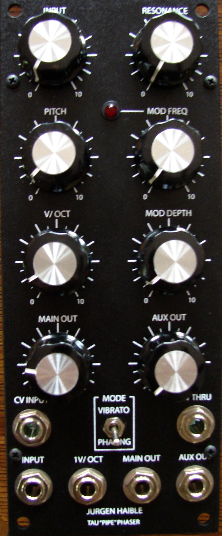

Here's a Tau Pipe Phaser built w/ a Bridechamber panel, a custom "shallow" build for a portable cabinet.
It sounds so amazing!!

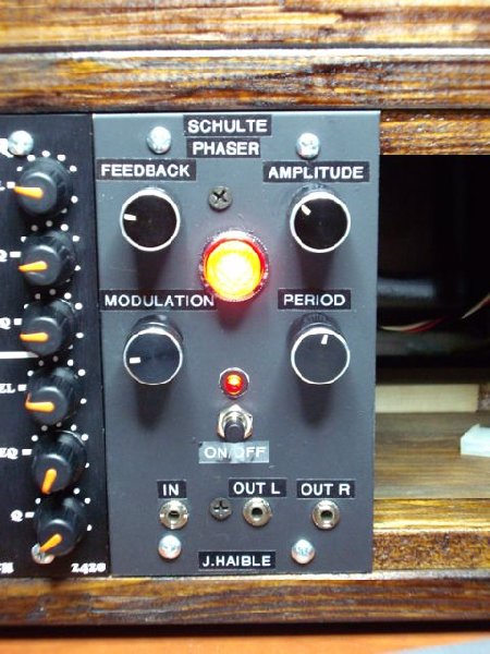

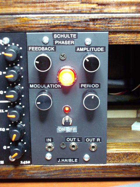

This is my "DIY" panel for the great sounding Schulte Phaser Smile

Glad to see this working!

Yeah, learned a lesson while building the kit; never trust a component supplier on resistor values. Always check!
I had the 2.43K labeled as such but replaced with a 243K. Spent days on this until a run a complete resistor value check of the board to find the error.

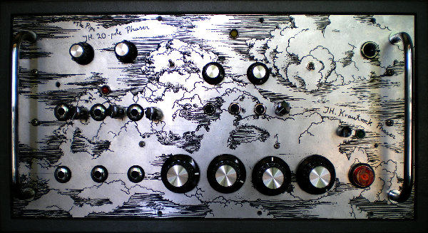

PostPosted: Sun Jul 13, 2008 5:12 am    Post subject: Two Phasers in a Box
Subject description: Finished Panel
This my Two Phasers case.
JH. 20-pole Phaser and JH. Krautrock Phaser.

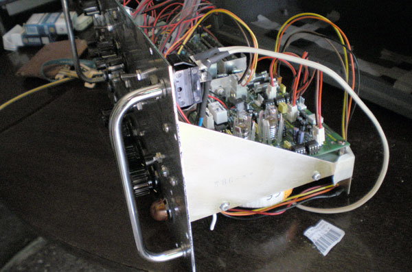

I found the case on the street and removed everything (UHF video gear). I am using its mounting brackets inside to fix boards and transformer. When everything gets wired I will post a picture of panel+brackets. 20-pole Phaser is not finished yet. Krautrock Phaser has some issues (Bypass led and 3rd lightbulb not working).
I had an aluminium panel cut to substitute the original panel, and my friend (who is into DIY engraving/printing) etched for me some clouds. No names for pots, switches and jacks, because I was not yet decided on how to do it.
BTW, I found two identical cases. The second one is waiting for another project.

PostPosted: Sun Jul 27, 2008 3:39 am    Post subject: Two Phasers in a Box Reply with quote  Mark this post and the followings unread
Both Phasers are finished and working.
The case.

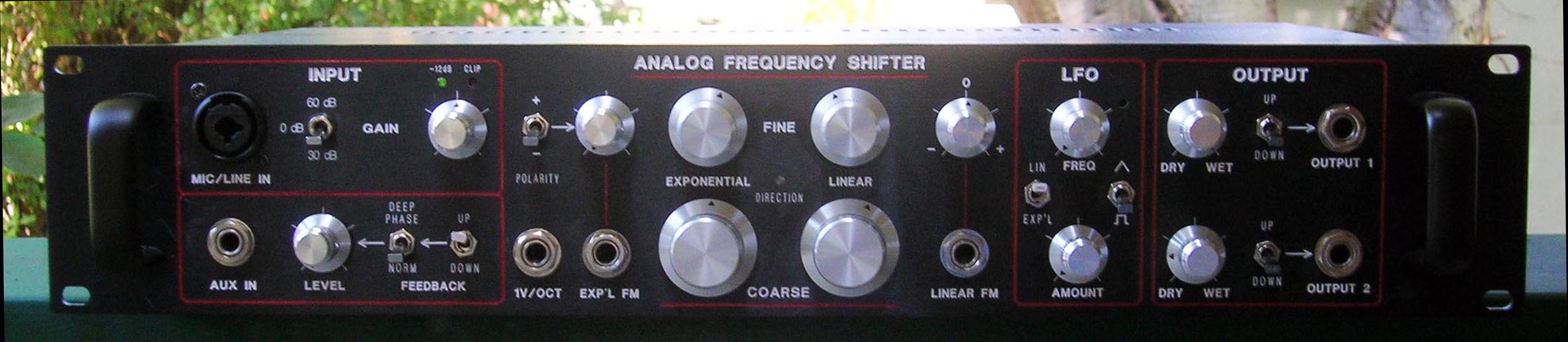

PostPosted: Thu Sep 04, 2008 10:56 pm    Post subject: JH Frequency Shifter
Subject description: Pic of Freq Shifter
I just finished building Jurgen's Frequency Shifter and it sounds - quiet and clean. I'm so used to hearing digital pitch shifters that I was surprised not to hear the window glitching. For small shift amounts this one can't be beat.
Very impressive design. It sounds amazing for "natural" sounds such as voice and instruments, but is also a great timbral modifier for synthesized sounds. I've always wanted a pitch shifter and I wasn't disappointed. It was a big project, but I had a lot of fun building it. Thanks Jurgen!
I had the front panel ecthed at Front Panel Express up in Seattle Washington. Nice folks and they did a great job. The panel is based on Jurgen's orginal hand drawn design with a few small mods. I'm happy with the control layout.

hey good work
it is good to see some completed FS-1s
inspiration indeed. i dont think ill start mine till next year unfortunately

This looks beautiful!
I wish I'd found the time to put mine into such an enclosure; my FS-1a prototypes are still bare PCBs mounted on a piece of plywood ...
