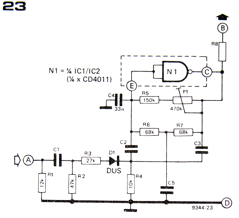

In the Electronic Drum Cookbook, Tom Henry notes:
"One of the earliest methods used to create percussive sounds was the Twin-T oscillator. This kind of circuit was really popular in the 1960’s and all sorts of portable bongo projects using it appeared in the magazines of that time. In those days, the active device which formed the heart of the circuit was the discrete transistor. By the 1980’s, the transistors were replaced by CMOS inverters configured to operate in a linear mode."
Anybody have any example schematics of a TwinT built around CMOS inverters? Sounds interesting.
thx,
bbob

Elektor had such twin T CMOS drum oscillator.
C2,C3 and C5 are capacitors that you have to select values for the drum tone you want to achieve.
Taken from French edition of the book "Le SON" (The sound), publish in 1980.

I would hazard a guess that you could use a CD4069UB (instead of 4011).
- one thing is that that may give a ?better sound as these are used for CMOS overdrive effects
- you'd also then have two spare gates, one particular use of which could be a simple sum (inverting opamp arrangement) and overall distortion (drive those 4069s!)
I'd like to try out this Elektor one - thanks for posting it Yves.
As a guess / from other TwinT Drum schems, possible C values:
Hi (Woodblock or Tom) - C2 = C3 = 470p or 1n &&& C5 = 4n7
Lo (Bass) - C2=C3=4n7 &&& C5 =47n
--- ie, C5 is generally kept 10 times larger than C2 and C3 (which are equal)

Refering to Elektor here are some values
HB : R8=390K C1,C5=33n C2,C3=20n
LB : R8=390K C1,C5=39n C2,C3=12n
BD : R8=100K C1,C5=150n C2,C3=47n
CD : R8=390K C1,C5=56n C2,C3=18n
CL : R8=1M C1,C5=4.7n C2,C3=1.5n
Yves

So in the elektor circuit, what sets the decay?
Also, is R8 effecting the frequency or the volume?
yusynth
Joined: Nov 24, 2005
Posts: 1314
PostPosted: Thu Aug 28, 2008 4:21 am    Post subject: Reply with quote  Mark this post and the followings unread
R8 is acting on the volume, it is a simple resistor in series with the output.
The decay is set by resonance (inverse of the damping) of the twin T filter.
it is fed with a brief pulse and the filter auto-oscillates and damps. The damping rate is set by the trimmer P1.
Yves

Couldn't get it to work on a 4011. I swapped it out for a 4069 and used one gate and it worked right off the bat. Pretty smooth sound.

Hrm I think I spoke to soon. Now I'm having problems getting it to trigger on the 4069. I'm running it on a 9V and sometimes it works sometimes it doesn't. It tends to work 90% of the time when I put a pot in series with pin 14 to +9V and adjust it.
Do ya think you could give this is a shot and see if it works 100% for you?

what chip did you use ? I didn't have much success with the 4011 but the 4069 worked for me (used it in my RGB Shroom drums).
I don't think you need a seperate gate > trigger converter as that's already taken care of in the circuit.

Hm, i did it with the 4069 right away, since i read this information in the thread already. I maybe scribble a schematic and make a pic of the breadboard, maybe then you can help me find the error. Thanks so far.
btw: what does the (D) in the schematics mean? If it means connect it to the negative side of the battery, i am right.
edit: it's working now, it was completely my fault, just couldn't read the schematics in the right way Very Happy Thanks for yo Help anyway...

The letters are most likely marked pads on a PCB or points that are referred to in the text that goes with it (in the orginal book).
So you can ignore it, but yes it connects to the negative side of the battery. But it's not that "D" has a universal meaning of being that.
Have you tried triggering it with standard CMOS ? it might be that the 74HC series output isn't suitable for this circuit.
Also it's usually powered with 5V and I don't know if the drumcircuit works correct at that voltage,
I expect it would do something though. If you are using a seperate supply then don't forget to connect the GND's together.

as i edited in my last post, its working now! i forgot one connection in the schematics. sorry for that. gonna check double tripplie next time Wink

After every drumhit you can hear a little click. its always exactly halfway between two hits, so i suspect it to be the clock-sqarewave going back to zero. Any ideas how to fix this?
I'm surprised that all you hear between hits is a click: Those twin-T circuits will trigger on the rising OR falling edge of a pulse. If the pulse is too "wide" you'll get two hits from one pulse.
Try decreasing C1 or R2, or both in the Yusynth schematic, or increasing R3.

Thank you, increasing R8 helped Smile

Second (in relation to PHOBoS' Shroom Drums http://electro-music.com/forum/post-392036.html#392036), are all diodes in the circuit supposed to be Shottkies or just the one marked? What is the purpose of BAT85 and other diodes in this circuit?
https://en.wikipedia.org/wiki/Schottky_diode#Voltage_clamping
The BAT85 limits the voltage triggering the twin-T to that diode's forward voltage. I believe an ordinary silicon diode could be used without ill-effect.
Third, how would you adjust the circuit if you wanted to change the decay time of the tones?
I've had some success with a pot in series with the cap to ground between the two 68k resistors. That, however, could only shorten the decay. Another possibility is to vary the 1M feedback resistor. That may or may not interact with pitch.
Any advice on my simulation? Rolling Eyes
Yeah; never trust simulations, particularly when using logic devices in the analog domain.
so many Edits
