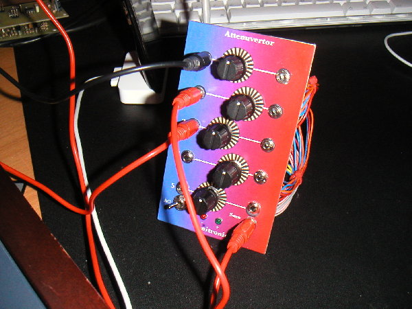

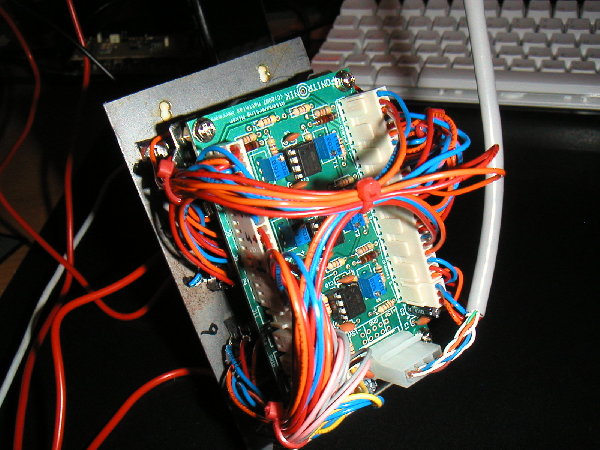

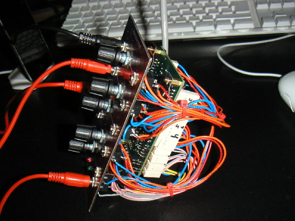

20 days into 2009 already and the builds continue. Post your stuff!
Here's last weekend's effort (mostly Saturday with some debugging on Sunday). I had a cold solder joint on of all things the power pin on U2. Silly me.
The connectors on that board are dense, so I ended up using 12-pin connectors, with some 3 pin ones on the end.
dense, indeed. i know that (mea culpa). however, i use stackable connectors, i mean you could put them in rows. i have 3pol and 2pol, so i can create any width i need.
anyways, nice built.

BTW edison. did you add the 100k resistor to GND right after the capacitor for AC coupling? i can't tell from the picture. it is necessary to install this resistor to make the AC coupling work (check out the lates documentation at my site: http://www.modular.fonik.de/pdf/f-mixer-rev2.pdf).

It is underneath the board, jumping from the underside of the terminal to R28's connection. Wink
It was easier for me to have it there.

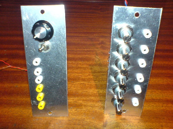

I had the vinyl printed at a graphic shop, and is covered with a satin
(kind of textured) transparent vinyl layer to protect the printing.
I just drilled the aluminium and then pasted the vinyl.
Is really cheap.
Here where I live (Buenos Aires, Argentina) laser engraving will cost me
about 35 dollars per panel, silk screening will cost me about 15 dollars per
panel, this method cost me about less than 1 dollar per panel.
