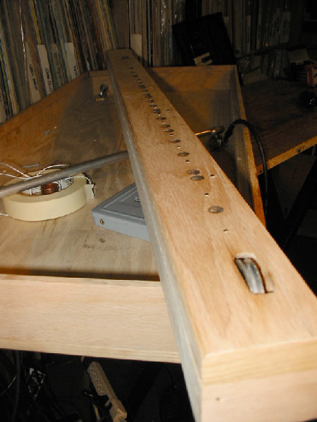

It's cool that so many people are interested in my homemade Martenot controller. Why did I make it? Basically, I didn't want to spend $2500 on a French Connection, and to buy a real Ondes Martenot (at around $30,000, if you can even FIND one) was out of the question. I gave up on the Theremin, Circon, and Ribbon Controller for playing actual melodies on. I was not really interested in just making scary or experimental noises --- I actually wanted to play real MUSIC. But the theremin is especially hard to sound good on. It's gotta be the most difficult instrument in the world to play well. Even skilled musicians can sound cringingly bad on it.
I really wanted the expressiveness of the vibrato of the theremin, with accurate pitch control, and also with voltage control ability to interface with my big modular's sounds. So, that's why I built this instrument. What attracted me most to the Martenot, was its' most ingenious design feature: Its' fingerboard, with its carved depressions for the finger to accurately land on the concert pitch. This greatly improves pitch control. With this instrument, you can still play a bad note, but it's not as easy!
I basically sat in a room with a computer, and did as much online research that I could. This included listening to lots of Martenot music, searching YouTube, and all other web resources. I still have not actually seen a Martenot in person. I just had to guess what was inside, and how it actually worked. Then, I modified what I knew about it, for my own needs. I drew drawing after drawing of various approaches to the design, before I started building this thing.
I'm lucky that my dad is a master craftsman, particularly good at woodworking, but also he's good at constructing most anything. I've taken advantage of his (free) services many times, for things I needed built in my studio. We worked together and brainstormed quite a bit. I did most of the idea work, but he did most of the actual construction, as well as revising a few of my ideas.
Eventually, I'll be making up a web page, documenting how we built this controller. Until then, attached are a few photos of some of the instruments' features... I'm waiting for one more part to come in, and then I'll be posting another YouTube video, showing the volume control working in great detail.
If anyone has any questions, I'd be happy to answer them here. BTW, I am NOT building one for you! You have to build your own...!
I'm happy to share any information I can...

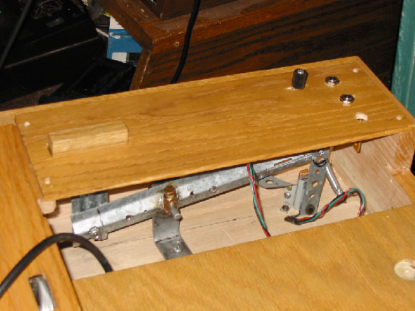

The left-hand volume control, with cover on.

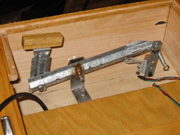

The volume lever assembly. It's a simple fulcrum design that pulls a lever potentiometer open and closed to allow the volume to be controlled. This acts as a simple envelope generator, as well as volume control.
