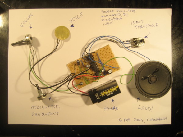

It's not a full-on modular Lunetta, but I did make it in a single afternoon with one of my students at a workshop in Copenhagen. Notable feature is "AM-style" modulation via a comparator built with TL072.
Single 4093 oscillator gated by input from contact microphone via TL072 comparator.

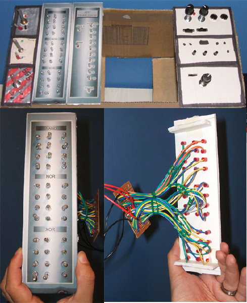

Here's the weekend's result. I'm breaking a few rules (most of them) but it's all for fun anyway, right?
I'm using bullet style connectors instead of bananna jacks because i can get a 50 pack really cheap. Connections will be done with alligator clip leads because i got 50 of them really cheap. I'm building most of it with cardboard and foamcore because (you guessed it) I'm really cheap.
http://farm4.static.flickr.com/3307/3299900482_f2a2475fd3.jpg?v=0
http://farm4.static.flickr.com/3451/3299922798_f477ce18ab.jpg?v=0
http://farm4.static.flickr.com/3563/3299093873_255c4694a8.jpg?v=0
Here's what you see:
1. A panel with three different sound cicuits.
-transistor multivibrator that i already had, from slow taps to buzzy buzzes.
-a basic electronic piano circuit with a pot instead of the resistor string
-a basic 555 square wave
2. NAND, NOR and XOR block
3. a 4017 panel, still need to do the wiring though.
4. 4 kits i already had, a guitar sustain thingy, a tone controller, and a little amplifier.
To Do:
-A panel of proper 40106 oscillators from the osc thread.
-Learn how to set up the dozen other ICs i have.
-A mixer.
-on/off switches on the oscillators (using just dual pins with jumpers)
-pulldown resistors for the inputs.
-a deluxe APC panel
-start working on the WSG, it calls to me
So far I've learned that patience pays. Don't cut before glue is dry!
The 4107, NAND, NOR and XOR were pretty straightforward with their inputs/outputs, but i'm having a hard time working out more complex pinouts on 10 other cmos ICs i have. I guess it's a matter of understanding their functions first, so this is surely a long term project. But I can't really plan a panel for something if I don't (yet) understand the general idea of it's usage. So the reading continues, it's pretty fun.
Questions:
-Do you guys have each IC connected directly to power and ground under the hood? Mine's going to run only on the 9v setting on my supply.
-for output to speaker or an amp, where does the ground connection come from?
-Would someone like to create a tutorial or set of plans for newbies to start with, especially how various ICs would be set up?
Thanks
s
 Filesize:  129.18 KB
 Viewed:  436 Time(s)
thats a great idea, no drilling, cheap and functional.
i worked from CMOS Sourcebook by Braga. basically any inputs get a pull down/up resistor, outputs straight to the panel.
i was conservative and connected all power and ground pins as per normal, but it sounds like it is worth wiring at least one of the oscillator chips power pin to a pot set up as a voltage divider

Thanks, I might redo the card to look neater, no so tattered at the edges. Or might just use black tape on the edges.
I'll have to chase up that book. Until then, this page is pretty helpful:
http://milkcrate.com.au/_other/sea-moss/
Great plain-language explanations. Will probably do panels for the ICs described next.
