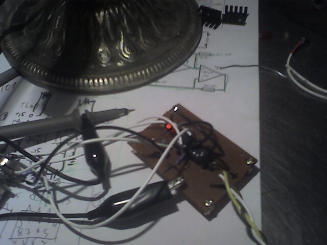

PostPosted: Mon Mar 02, 2009 9:48 pm    Post subject: Reply with quote  Mark this post and the followings unread
thanks for the simple lfo design nic
makes for a good test bench lfo
i made mine with 2 tl072s as i bought a truck load of them last week
it is running well at +/-15 as you would expect
 Filesize:  64.42 KB
 Viewed:  1005 Time(s)
