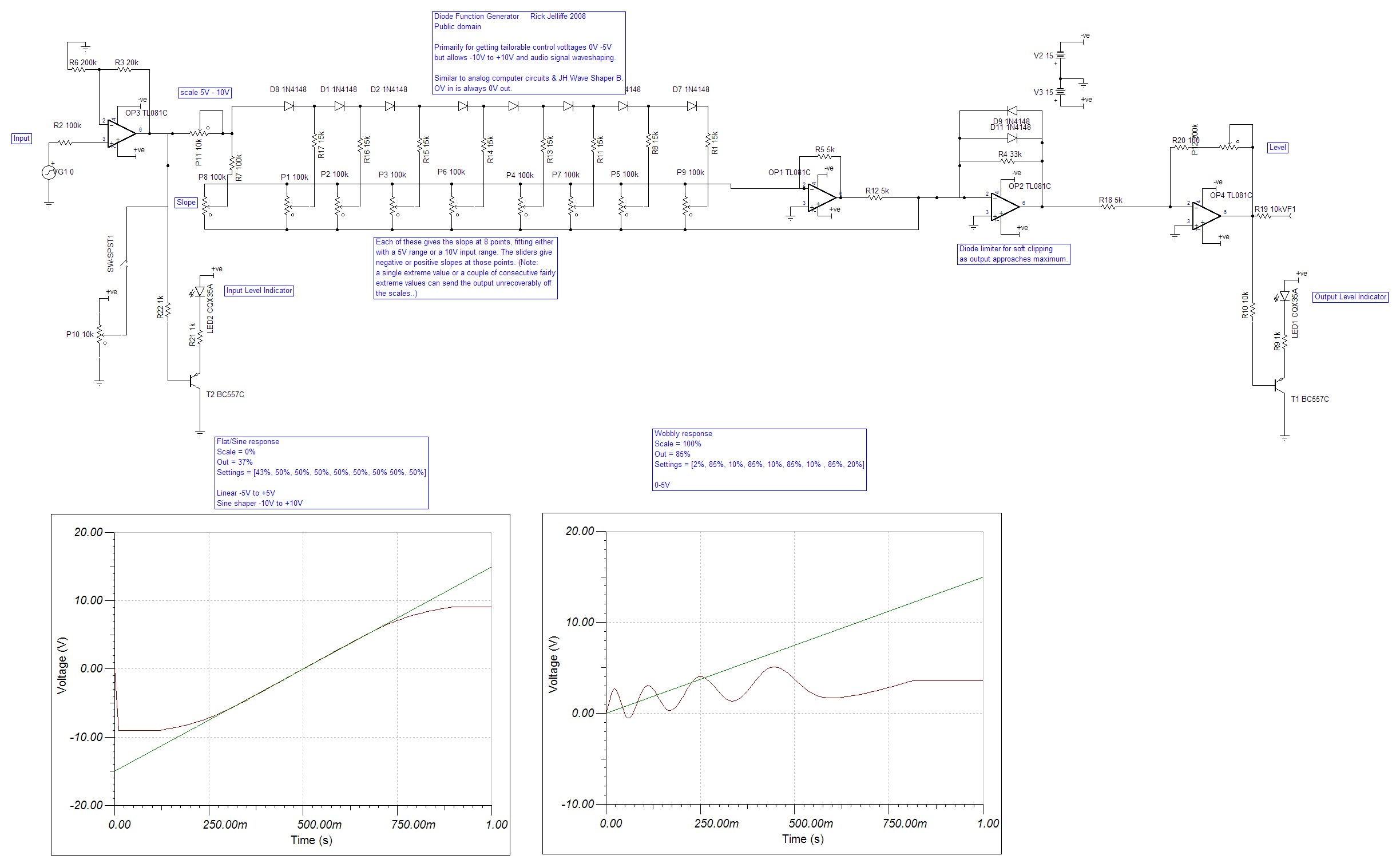

(Did I already post this?) I was looking at Analog Computers a couple of months ago, and worked up this version of a Diode Function Generator. Think of it as a more variable version of a diode waveshaper. (There is some interested archival material on the web, from the 50s and 60s!)
It would be easier to use if it could be used like a graphic EQ (like the bar display with dither circuit). As it is, each step effects every step to the right of it.
I haven't built this, just simulated it in TI-SPICE. There is a full version. (It is also a simplified version at http://electro-music.com/forum/topic-28527.html )
Rick
Schematic of full shaper

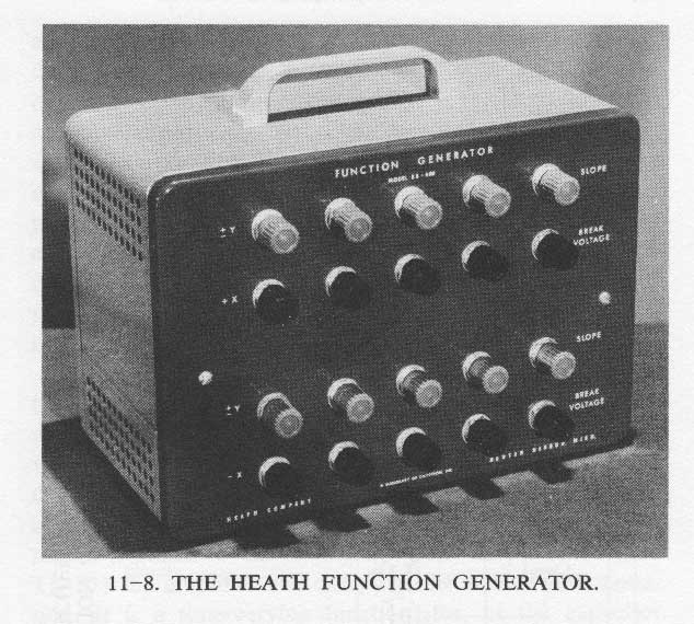

thanks for posting those. After building Ian's and others chaos circuits, i am developing an appreciation for the subtler uses of diodes.
here's an old Heath diode FG
this one has been on my list for a while
 Filesize:  83.52 KB
 Viewed:  543 Time(s)

Funny this shows up again
I have spent some time this week examining the diode breakpoint shapers in Mr Patchell's Vocal Filter - much the same as the circuit posted above by Ian.
and
(also this week) started point to point connections for the Heath diode function generator using a rack of hewett-packard 5725 pentodes.
100th monkey effect?
