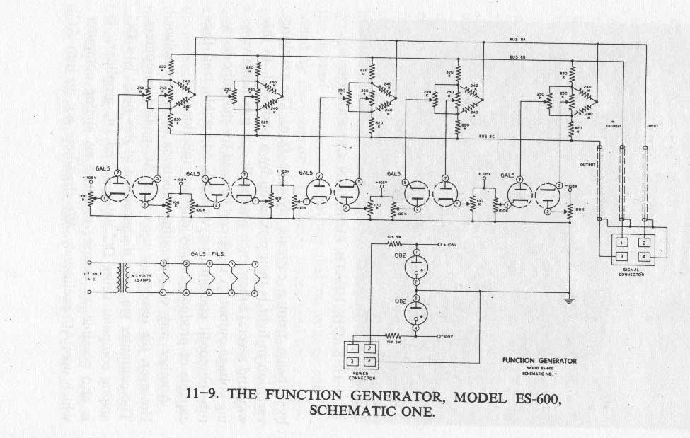

here's an old Heath diode FG
this one has been on my list for a while
 Filesize:  83.52 KB
 Viewed:  551 Time(s)
 Filesize:  77.56 KB
 Viewed:  726 Time(s)

Funny this shows up again
I have spent some time this week examining the diode breakpoint shapers in Mr Patchell's Vocal Filter - much the same as the circuit posted above by Ian.
and
(also this week) started point to point connections for the Heath diode function generator using a rack of hewett-packard 5725 pentodes.
100th monkey effect?
