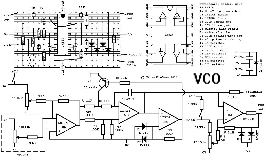

PostPosted: Fri Mar 06, 2009 3:56 am    Post subject: Super simple V/Hz VCO Reply with quote  Mark this post and the followings unread
The ongoing saga ... here is a VCO to match the ribbon controller http://electro-music.com/forum/topic-32651.html
This VCO does not pretend to be super accurate or be capable of a gazillion octaves of perfection. But it sounds pretty good and is definitely good enough to make music with. The idea is that it is simple enough to easily understand and be easily built in a couple of hours on stripboard using common components. It runs off +/-9V (ie two batteries). It expects a CV in the 0-7V range. The output is about 1V p-p which is suitable to run directly into your effects pedals, DAW, etc.
It is V/Hz which means that if you set it up to give you middle C at 2V, you should get C an octave lower at about 1V and C an octave higher at about 4V. My ribbon controller is similarly scaled so that each 1cm along the ribbon is a semitone higher or lower.
I haven't tested this stripboard layout yet - I would appreciate feedback so I can correct any issues in the drawing. My prototype is slightly different in that the PWM comparator is separate, so if anyone builds this, let me know how you get on.
If you want to try this on +/-15V it might be okay, but you may need to put in an additional protection diode for the transistor. As shown it gets subjected to about 7V of reverse voltage which it seems to handle in practice, but is actually slightly in excess of what the datasheet recommends. With higher power supply voltages the extra reverse voltage might be too much for it.
Nicolas

Did you try adding a fet as a switch across the cap to add sync?

Good idea, but the integrator op-amp inputs are not at virtual ground in this design, so feeding the fet is complicated slightly. I think it could work with the appropriate driver. Might have a play round when I get some time. The idea with this circuit is simplicity - if it starts to get too complicated-with-all-the-bells-and-whistles I would rather use one of the long-proven published circuits. No point in re-inventing the wheel unless there is some point of difference.

I hear ya. I would definitely like to see it kept simple. I'll try breadboarding it this weekend and see if I can come up with a simple and reliable sync method using a fet.
You may want to check out my schematics in the Lunetta forum. Really simple vcos and things there.

It's a shame that the comparator used to control pwm couldn't be used as a simple vca instead.
PS- great circuit btw!

One alternative use for that pwm opamp is to get saw output instead of pwm. As per this diagram.
If you wanted to use the opamp to as a VCA that would be fine too, just require 3 or 4 additional transistors (differential pair with controllable current sink) or alternatively a fet or vactrol.

Yes any additional opamp could be used to give you the saw out. If you have another spare opamp you can build that saw shaper circuit again and take the square feed from pin 14 instead of pin 8 and you should get a triangle output that will transition to an octave up as you twist the PWM knob or feed it from an LFO, etc. Fun addition Smile
The +6V is what I use in my synth as a stable reference voltage because my +9V line fluctuates a bit. You can try just using the +9V instead and see how you get on. If you hear crap from other modules bleeding through into your VCO, then sort out a stable 5 or 6V with a 78L05 or 78L06.

Hello! Sorry for resurrecting an old thread as my first post! BUT, I just built this lovely little VCO and am running it with a +/- 12V PSU. It works great although, I seem to be getting a pretty nasty 60Hz hum out of the TRI output (though not out of the PWM for some reason...). Is there any way I can get rid of this? Is the diode mentioned in the first post a possible solution? I plan on using this VCO along with a ribbon to make a sort of Tannerin type synth for live use... Any help is much appreciated! Also, just out of curiosity, I've got the ribbon CW terminal connected to +12 and the CCW terminal to -12 with a 100k pot on both in series... Any thoughts on a better way of connecting the ribbon or is this good enough? This is my first DIY analog synth so any pointers are much appreciated!

Hi Barry
The hum is most likely a wiring or earthing issue. Is the socket shield connected directly to the power supply earth or the VCO earth or is it not connected at all? Whichever it is, try the other two options to see what happens. Double check your wiring and double check the socket itself. Faulty sockets are common source of bad connections.
But it may be a power supply issue. Are you running it from the mains on an unregulated supply? I run mine on batteries. I specified a couple of 100nF caps to bypass the +V and -V lines, but you may want to try adding 10uF or 100uF electrolytics in parallel with the little caps.
But since the PWM output is okay, I would suspect that its the wiring to the Tri socket or the socket itself that is the problem. The two outputs should not be different except in the way intended.
Oh and about the ribbon - should be 0 to +12V. I don't think we want -V going into the CV of this VCO.

Oh I see. The problem is quite possibly that the ribbon controller is feeding hum into the CV input. The CV input on the VCO should relax to zero volts when no note is sounding. The fault may lay with the ribbon rather than the VCO. Feed the ribbon circuit from the earth (zero volts) and +12V. It should output a CV that is zero volts when not pressed, and range from about +1V to +6V when pressed. Fix the ribbon circuit first and your VCO hum might go away.

Since the PWM output is okay it is very very unlikely that there is anything wrong with the VCO itself. The things you should be suspicious of are:
1. the CV input, ie the ribbon controller circuit.
- with the ribbon not pressed, connect a guitar amp to the ribbon output and listen for hum, should be zero volts and silent, but a long ribbon may need a bigger value for C3 to quiet the hum.
2. the Tri output socket and associated wiring.
- especially check the earth wiring and watch out for socket faults.
