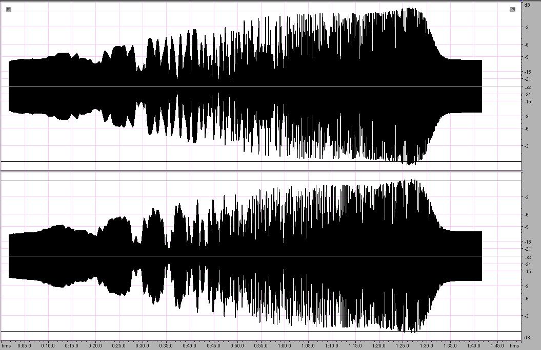

There's a frequency plot of a 20Hz-20Khz linear sine sweep through the unit (mode 4) attached to this post. Impedances on my converter (balanced connection) are 24 ohms on the input and 100 ohms on the output.
The low end as well as the high end are 9 db down compared to the parts in the midrange with the highest amplitude. This seems too much to me.
BTW, is the chorus made for +4 db level input?
Thanks for your time, it's great to get answers here so quickly!

jhaible
Joined: May 25, 2007
Posts: 2014
PostPosted: Fri Mar 27, 2009 3:37 pm    Post subject: Reply with quote  Mark this post and the followings unread
Yes, the service manual says so.
JH.

I've just checked the individual pathways. The input stage of the main board is fine. But the return signal from the BBD board is severly bandlimited, the signal falls steeply above 9,5 khz as well as below 70Hz (the latter one doesn't matter much in a real world application). Could this be caused by one of the ceramic opamp feedback caps having the wrong value? The problem is that a lot of them are unlabled (though I took care - I thought - to put them in correctly)...
Or could this be caused by a broken transistor?
Gregor
jhaible
Posts: 2014
PostPosted: Sat Mar 28, 2009 8:23 am    Post subject: Reply with quote  Mark this post and the followings unread
Band limiting the BBD signal is intentional. 10kHz seems about right.
I wouldn't call it "severe" - it's just the BBD path, and not the overall response, after all.
All in all, it means the highest frequencies are there - just a little attenuated, and not "chorussing".
JH.
