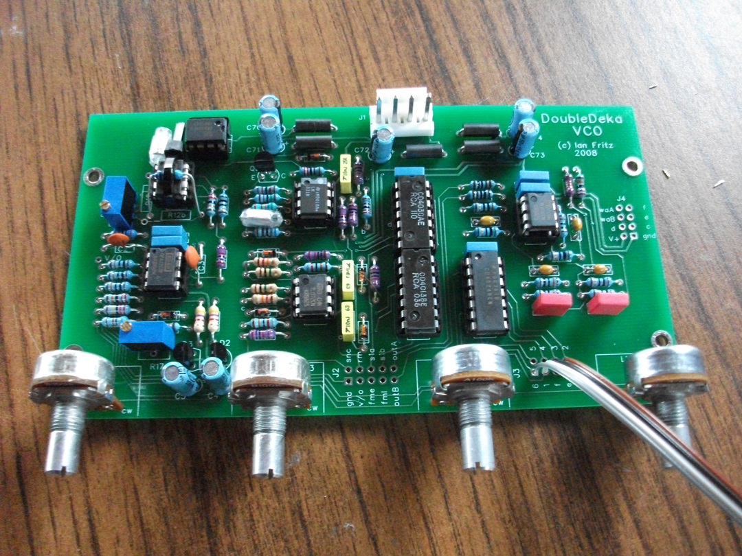

I just built #1 out of 2. This is one amazing module! The different timbres you can get out of it as a VCO are awesome, but I found that using it as a mod-source more than doubles its value. Audio rate modulation is amazing with this thing. Hooking one of its two VCO's outputs up to the V/O input on a filter and then tweaking the sliders creates some wicked sounds!
Great job Ian! Can't wait to get my second one built! Let the Audio Maelstrom begin!
(someone is going to have to put me away after I get these and my teezers going!)
ALSO several things of note regarding the PCB and the copy of the documentation that I received in 09/2008 (don't know if it has been updated):
1) The outputs on the PCB are labeled incorrectly. The pad marked OutA is really OutB & vice versa
2) The BOM lists a TL074 for U9 when it really calls for a TL072
3) On the BOM R30 is listed TWICE, the first value as 10kOhm & the second 1MOhm. R30 is supposed to be (according to the schematic 10KOhm)
4) R31 is not listed on the BOM, it is supposed to be 1MOhm (once again, according to the schematic)
-Jim
Thanks for pointing those out. Some of those have been corrected; I'll recheck them all when I get a chance.
Ian
frijitz
Joined: May 04, 2007
Posts: 1734
Location: NM USA
Audio files: 54
PostPosted: Thu Jul 09, 2009 7:51 pm    Post subject: Reply with quote  Mark this post and the followings unread
I can't find any error in labeling. Perhaps check you didn't switch the J4/J4a wiring?
This has been corrected.
This is a single typo and has been corrected. In the line "1 MOhm R30, R35", R30 should be replaced by R31.
Ian

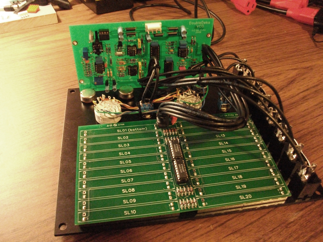

PostPosted: Thu Jul 09, 2009 7:55 pm    Post subject: Reply with quote  Mark this post and the followings unread
Just finished mine! Very cool sounding vco - haven't had a chance to do more than scratch the surface yet.
I didn't have any of the problems Johan had with the parts and docs I got from The Bridechamber. I was a bit worried about the out A and out B, but mine are labeled correctly. The way I had mine wired, if it needed fixing, it was going to be a big problem, and of course I did that bit of wiring the night before Johan posted about his problem.
The one thing I had to go back and fix is something that could be clarified a bit in the comments section - the wiring for the octave switches. For some dumb reason I assumed the letters on the pcb would correspond to the numbers on the switch - a=1, b=2, etc. But that's not how they work - it's backwards. Oh well, it didn't take long to fix.
Ian Fritz DoubleDeka VCO front
Ian Fritz DoubleDeka VCO back2
