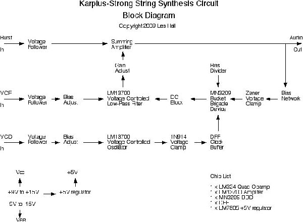

You know, it's funny, those thoughts of yours were the last thoughts I had before deciding to post the diagram as it was. So we're all thinking alike. In my case, my lack of modular synth knowledge led me to question whether the average synth could form appropriate signals, but I guess it can.
If we can eliminate the noise chip and the transmission gate chip, that reduces our chip count from 9 to 7, which is a step in the right direction. I also think I went a bit overboard on all the voltage followers, perhaps that can be done simpler.
Thanks for the suggestions guys, I'll update the diagram and post it for your review.
Les
Joined: Oct 13, 2007
Posts: 6221
Audio files: 267

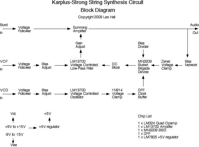

PostPosted: Thu Sep 03, 2009 4:17 pm    Post subject: Reply with quote  Mark this post and the followings unread
OK folks, I put in your changes and did some simplifying. The burst is simply an input now, so a modular user could use any desired signal for it. The voltage followers scattered about have been reduced from 8 to 4, removing one quad opamp. They have been replaced by appropriate bias networks. The VCF and VCD inputs now have a bias control such that one need not hook up inputs to them, and can work them from two front panel pots if desired.
This reduces the circuit to just five chips, one of which is just a three-terminal regulator, so only four big chips. The discrete count goes up though. I hope this will fit on the tiny boards proposed, because we just can't get any better than $51 for a set of prototype boards as far as I know.
Please let me know what you think, then I'll start working on a schematic.
Les
p.s. maybe we can add a switch to the Burst input, that way one could produce music using this module alone and no inputs would be required (though highly desired).
Revised Karplus-Strong Block Diagram

PostPosted: Thu Sep 03, 2009 8:38 pm    Post subject: Reply with quote  Mark this post and the followings unread
Dan, that sounds cool, in fact I changed the DFF into an MN3202 companion Clk/Divider chip which is 8 pins instead of 14. Now we only have two big chips, two little chips, and a 3-terminal regulator. I also added some nice features, outlined below.
Code:
Notes on Karplus-Strong Block Diagram
The board functions as both a modular synthesis module and a stand-alone eChucK module.  This is accomplished with three input jacks for the three modular synthesis mono input jacks as well as a stereo input jack for connecting to the headphones out of a PC.  A shorting switch can be engaged to cause the eChucK right channel to simultaneously control both the VCF and VCD.  Output is a single stereo jack wired with tip and ring shorted together.
The power supply may be a pair of 9V batteries or +/-12V or +/-15V so the board can be stand-alone or can run from a modular power supply.
The PWM block converts a PWM signal on eChucK right into a DC level which is then summed into the VCF and VCO signal paths.
There are two features that permit operation of the board with no input connections.  The Stim switch provides a front panel control which when pressed will cause a burst to occur manually.  Also two Bias adjust potentiometer circuits allow the user to dial in the VCF and VCD inputs if desired.  These should be adjusted to zero position when driving the inputs through the jacks.
The third revision, this one looks pretty good I hope

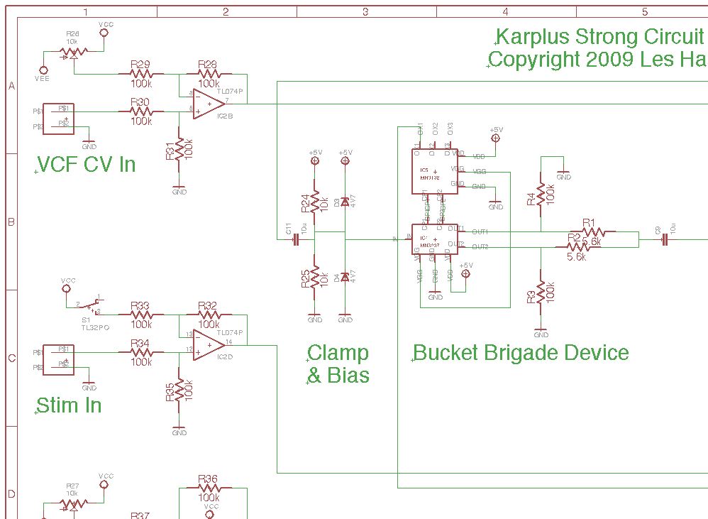

PostPosted: Sat Sep 05, 2009 12:37 pm    Post subject: Reply with quote  Mark this post and the followings unread

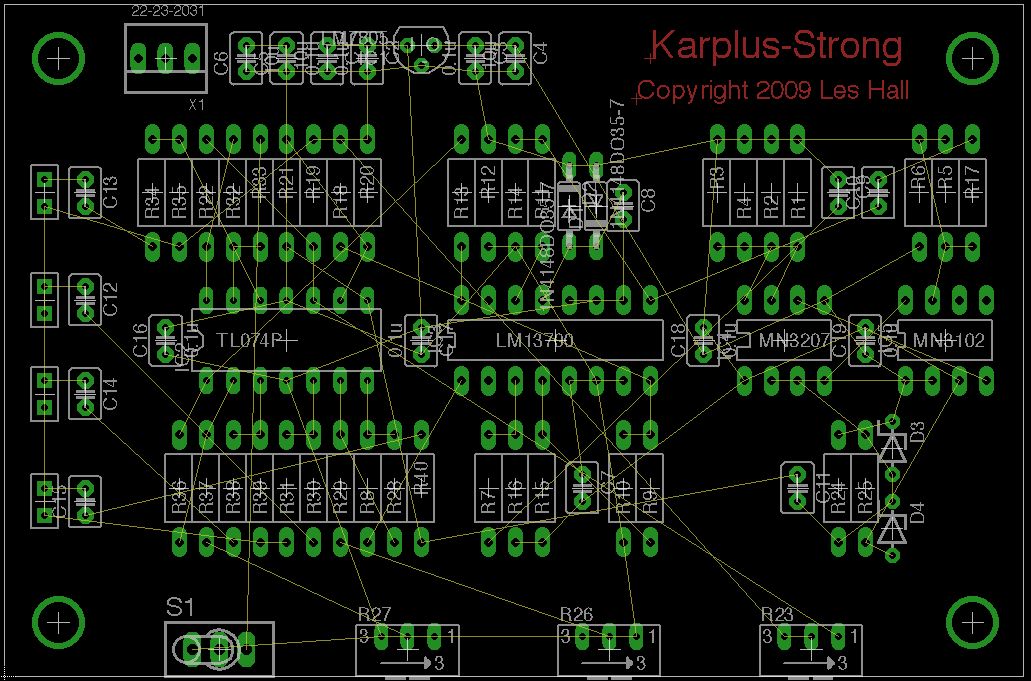

Since my last post I have completed a schematic and board placement for the Karplus-Strong board. Please see below for screenshots. Oh, i forgot to put a copyright on the schematic: schematic is copyright 2009 Les Hall.
I just have one question at this time: What is the pinout on the three pin Molex power connector?
Since the prototypes will be only $51, I feel no need to breadboard the circuit. Please let me know of any issues or questions you may have. Thanks.

PostPosted: Sat Sep 05, 2009 1:16 pm    Post subject: Reply with quote  Mark this post and the followings unread
Why a 3-pin and not a 4-pin? Most modular guys here use the 4-pin molex 0.156" spacing. Layout: +/0/0/-.
I think it's a better practice to breadboard the circuit before ordering a prototype board. You can easily adjust resistor and capacitors to get the best results. And there is no need to spend the money twice (if there is something wrong with the circuit)

PostPosted: Sat Sep 05, 2009 1:25 pm    Post subject: Reply with quote  Mark this post and the followings unread
Sure, I'm easy going. What you say makes good sense wmonk, thanks for the suggestion and the information. Next I need to work out the component values...

PostPosted: Sun Sep 13, 2009 6:07 am    Post subject: Reply with quote  Mark this post and the followings unread
I put in all the suggestions made so far except the exponential VCO/VCF feature, there just isn't time or room for that in the first version. Below you will find an updated schematic with component values, text notes, and some other changes like the level shifter that Jan suggested.
Here is a digikey/smallbear order that I have prepared. Am I missing anything from the orders?
Les

PostPosted: Sun Sep 13, 2009 6:21 am    Post subject: Reply with quote  Mark this post and the followings unread
Where is the 4017 in the schematics? I thought you replaced it with a 4040?

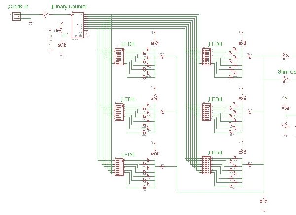

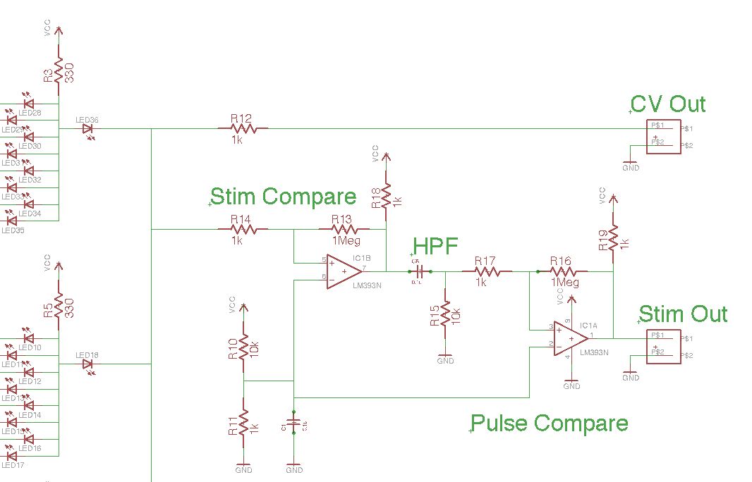

PostPosted: Sun Sep 13, 2009 1:58 pm    Post subject: Reply with quote  Mark this post and the followings unread
With a little time on my hands I decided to work a bit on the Boolean Sequencing board. It's the new version that does only Boolean Sequencing, nothing else. I'm not too sure if folks will be happy with the way that I'm generating CV, but I think it will be OK. There's not much room on the little 2.5" x 3.8" board. It can be wired up to a Karplus-Strong board directly, all you need is a clock source at 4Hz or so.
Comments welcome as always.
Les

PostPosted: Sun Sep 13, 2009 3:00 pm    Post subject: Reply with quote  Mark this post and the followings unread
Am I wrong or are the LEDs in the LEDILs reversed?
Posts: 6221
Audio files: 267
PostPosted: Sun Sep 13, 2009 3:06 pm    Post subject: Reply with quote  Mark this post and the followings unread
I *think* they're OK. There are six AND gates feeding into one OR gate. The AND gates go low if any output is low, so that's good. Then if all inputs are high or open, the AND gate goes high. The diodes are reversed to do the OR function so that if any input is one the output goes to a low value of one. Any more outputs going high drives up this voltage to create a CV. Then a comparator circuit picks up the rising edges and creates a narrow pulse. Am I correct?

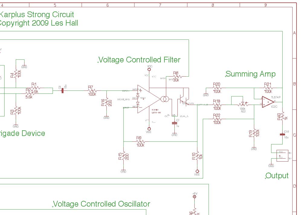

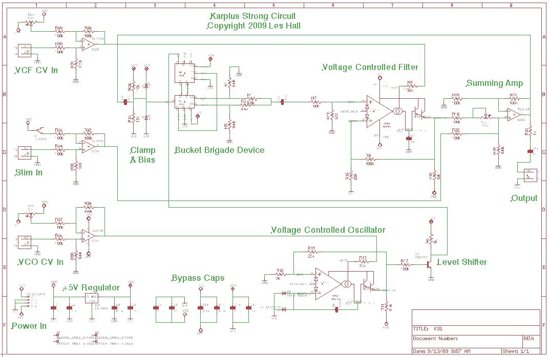

PostPosted: Mon Sep 14, 2009 5:39 am    Post subject: Reply with quote  Mark this post and the followings unread

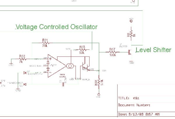

not sure why BUT I CAN NOT read any of the values on your schemeatics for resitors, caps,etc
I tried ONSCREEN and printed.
a shame as i really really want to try this KS circuit.
thanks so much
loss1234
Joined: Jul 24, 2007
Posts: 1536
Location: nyc
PostPosted: Mon Sep 14, 2009 5:45 am    Post subject: Reply with quote  Mark this post and the followings unread
also...i noticed in your block diagram that you have echuck inputs...however i see your sequencer scheamtic. so my question is, can i do this entirely in the analog domain or does ECHUCK need to be part of the setup?
thanks so much
Posts: 6221
Audio files: 267
PostPosted: Mon Sep 14, 2009 2:47 pm    Post subject: Reply with quote  Mark this post and the followings unread
loss1234, I am quite happy that you plan to breadboard the KS circuit, hopefully together we can get it to work. Below are four close-ups of the schematic which should give you a clear indication of component values. Any questions, just post.
Regarding the eChucK component, I found that the board would not fit so I removed that feature. Now it's strictly a modular or perhaps stackable board. The VCO and VCD inputs can be left unconnected and just set by their potentiometers. The BS and KS boards are designed to work together but you can actually just drive a narrow pulse train into the KS stim input and adjust the pots to get different sounds for test purposes. Also there is a switch on the stim input which is intended to allow stand-alone operation for test, just hit the switch to get a burst of sound from the KS circuit.
Hope that helps.
Les

loss1234
Posts: 1536
Location: nyc
PostPosted: Mon Sep 14, 2009 4:49 pm    Post subject: Reply with quote  Mark this post and the followings unread
Ok

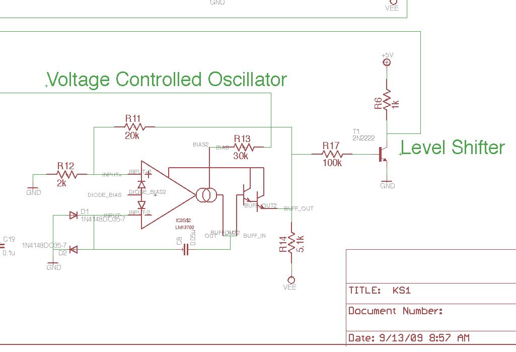

i think the only thing i am stuck on (still cant read) are the BBD chip and BBD clock chip PIN NUMBERS
other than that, i can read it all! I have been spending the last 2 weeks on nothing buy BBD circuits so this will fit right in.
I had been using a 4046 for voltage control, but this method makes more sense to me.
thanks!
Posts: 6221
Audio files: 267
PostPosted: Mon Sep 14, 2009 5:53 pm    Post subject: Reply with quote  Mark this post and the followings unread
ok dan, I made an extreme close-up of the BBD section for you. There are no pin numbers but the pins are sort of labeled. Sorry, I don't know how to make proper library parts yet so the text is like all over there or something, but you should be able to make it out. Best of luck to ya!
Les
