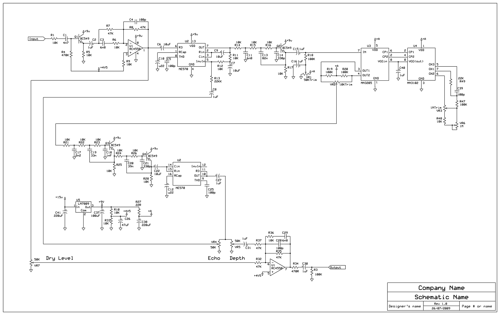

PostPosted: Tue Sep 08, 2009 4:06 pm    Post subject: Reply with quote  Mark this post and the followings unread
Here's the schem for the basic delay module. I'm thinking I'll build three of these and then modulate them and interconnect them separately. I still want to breadboard this again to check that the levels are fairly closely matched.
Does anyone have any ideas, critiques?

PostPosted: Thu Sep 10, 2009 3:17 pm    Post subject: Reply with quote  Mark this post and the followings unread
It should work fine for the XX3207 as it's partly inspired by the DimC schematic. Keep in mind though that the pinouts for the MN3205 and the MN3207 are very different. Check the datasheet, and check it again! Laughing
Yeah, I had quite a time getting this happening, partly because the example on the MN3205 datasheet has the power rails reversed! Rolling Eyes
I have come a long way though. Now I just need a bit of alone time to do the stripboard! Rolling Eyes This idea might be finished by the 30th of Feb!! Laughing

PostPosted: Fri Sep 11, 2009 3:11 pm    Post subject: Reply with quote  Mark this post and the followings unread
It's actually the VC clock which is the part I wanted to check, so maybe you've found an error which I hadn't seen yet. (that's partly why I wanted to share it, so I could get some others interested in understanding how it might work (or not)!!) Laughing
The clock lines should both have a sqaure wave of almost 6V around 30-80khz depending on the speed.
The "tape quality" pot is really just a low pass filter to take the top end off the delay. I'd rather develope this circuit to give the best response first, then if you want to take off the top end, you could put it through a filter later.

PostPosted: Fri Sep 11, 2009 3:33 pm    Post subject: Reply with quote  Mark this post and the followings unread
No, you won't have fried your chips.
The only part of the VC clock I haven't checked is the summing node. Everything left of the 5K6 resistor is tested and works fine.
You do have a cap connected at the "delay range" point to ground? Without that, the clock will be dead.

PostPosted: Fri Sep 11, 2009 3:46 pm    Post subject: Reply with quote  Mark this post and the followings unread
Yeah,
100pF between 5 & 7
100K between 6 & 7
