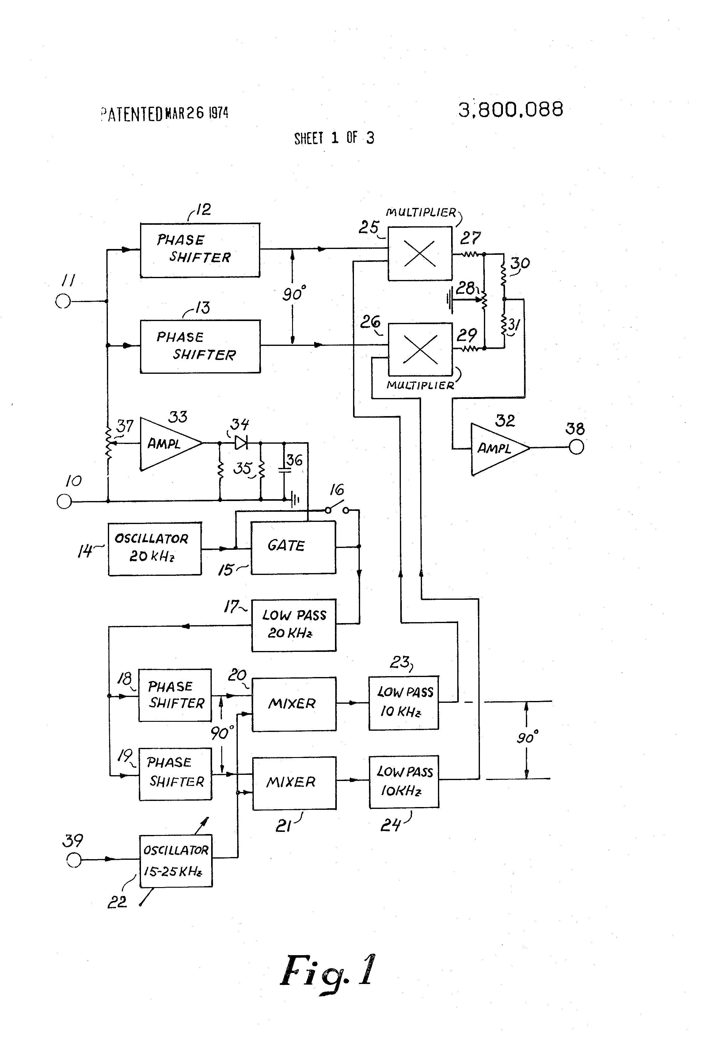

PostPosted: Fri Jul 17, 2009 11:37 am    Post subject: Reply with quote  Mark this post and the followings unread
Good link, thanks. Here is the block diagram from the patent itself.
Block diagram of the Bode Frequency Shifter from Patent

PostPosted: Fri Jul 17, 2009 1:06 pm    Post subject: Reply with quote  Mark this post and the followings unread
Here is a comment from the author of the excellent web page that Blue Hell cited, describing the difference between ChucK's PitShift and what we want to create for mosc:
It's important to note that this effect is a frequency shift and not the pitch shift effect currently available in modern digital effects boxes. In a frequency shifter all frequency components of the input signal are offset by a specific number of Hz while in a pitch shifter all frequency components are multiplied by a specific factor. The former sounds something like a ring modulator while the latter sound something like playing back a tape at a different speed.
If I understand it right, we don't want to make the sound of a tape being played back at a different speed, which is what ChucK does with the PitShift UGen. Rather, we want to make the sound of an RF modulator with the upper and lower sidebands available as separate outputs.

Posts: 24673
PostPosted: Sat Jul 18, 2009 7:09 am    Post subject: Reply with quote  Mark this post and the followings unread
Hmm .. that seems wrong ...
the low pas filters in the schematic above would cause the upper side bands of the first mix to be filtered out, I assume, at least when I calculate with that the output frequency would be shifted by the difference between f1 and f2, thus yielding only one shifted output.
I dont however see that it would shift by the absolute value of the difference, I just get :
fout = fin + f2 - f1
provided that the low pass filtering is perfect. Which means that a pretty high frequency should be used for both f1 and f2, but also that when f1 is smaller than f2 an upshift would occur.
Code:
sin( fin) * sin( f1) = ( cos( fin - f1) - cos( fin + f1)) / 2 = P
sin( fin) * cos( f1) = ( sin( fin + f2) + sin( fin - f1)) / 2 = Q
perfectly low pass filtering these gives
R = lpf( P) = cos( fin - f1) / 2
S = lpf( Q) = sin( fin - f1) / 2
then the 2nd mixer gives us :
sin( f2) * R = ( sin( f2 + fin - f1) + sin( f2 + f1 - fin)) / 4 = T
cos( f2) * S = ( sin( f2 + fin - f1) - sin( f2 + f1 - fin)) / 4 = U
now T + U = sin( fin + f2 - f1) / 2 = sin( fout) / 2
so fout = fin + f2 - f1
Kassen

Posts: 24673
PostPosted: Sun Jul 19, 2009 5:30 am    Post subject: Reply with quote  Mark this post and the followings unread
Maybe there is an issue with negative frequencies ... sin(-x) would be -sin(x) (for positive x) but cos(-x) would be cos(x)

PostPosted: Tue Oct 13, 2009 12:47 am    Post subject:   Reply with quote  Mark this post and the followings unread
For shifting down, you need to subtract the 2 mixers outputs
instead of adding them...
(i.e. instead of the sum, you need the difference...)
Posts: 24673
PostPosted: Tue Oct 13, 2009 12:01 pm    Post subject: Reply with quote  Mark this post and the followings unread
Interesting ... and welcome
then we get
Code:
and - U = ( - sin( f2 - fin - f1) + sin( f2 + f1 - fin)) / 4
now T + ( - U) = sin( f2 + f1 - fin) / 2 = sin( fout) / 2
so fout = f2 + f1 - fin
So fout gets smaller when fin goes up in this case.

Posts: 24673
PostPosted: Tue Oct 13, 2009 2:39 pm    Post subject: Reply with quote  Mark this post and the followings unread
I think you'll need pretty high frequencies ... the carrier tones should be filtered out by the filters for it to work.

PostPosted: Wed Oct 14, 2009 12:59 am    Post subject: Reply with quote  Mark this post and the followings unread
(scratch head...)
Somehow I had fig.3 of the Bode patent in mind...
In the ChucK-case this would probably end up inverting the sin(f2 t) of the second oscillator to minus sin(f2 t), (i.e. turned around by 180°),
and then adding the 2 mixed signals at the output again, like before?
Sorry if I mixed things up and spread confusion...

Posts: 24673
PostPosted: Sat Oct 11, 2014 2:47 am    Post subject: Reply with quote  Mark this post and the followings unread
Was looking into this again, wanted to do a Wren module for it ... found some info about the use of Hilbert transforms for shifting, and it looks easier than the quadrature methods sketched above.
http://www.mikrocontroller.net/attachment/33905/Audio_Hilbert_WAR19.pdf
http://www56.homepage.villanova.edu/scott.sawyer/fpga/II_frequency_shifting.htm
I did not try it yet, maybe later this weekend.
Edit: OK, the Hilbert transform is just what the dome filter is in the analog implementation. I've seen digital filter implementations for that.
Edit2 : and the filter implementation seems efficient for making a Hilbert transform.
Edit3: https://github.com/swh/ladspa/blob/master/bode_shifter_1431.xml - an implementation for Ladspa by Steve Harris - currently trying to implement that one.
