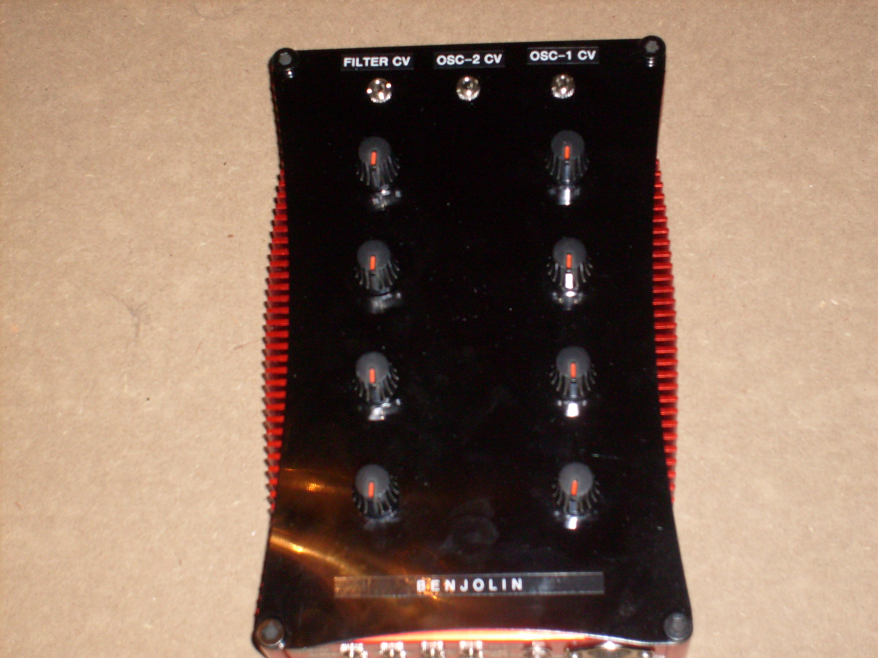

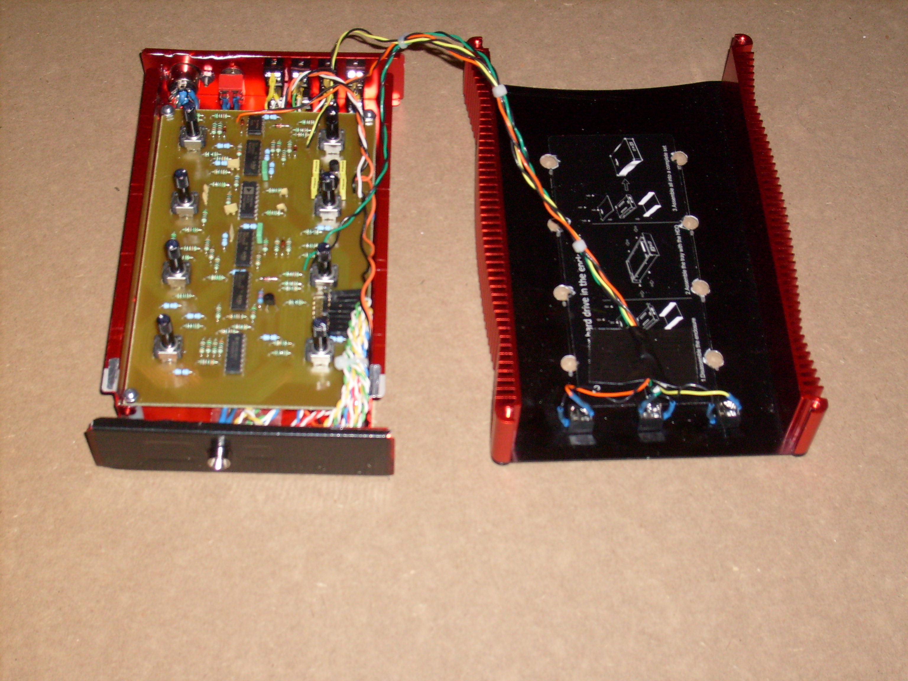

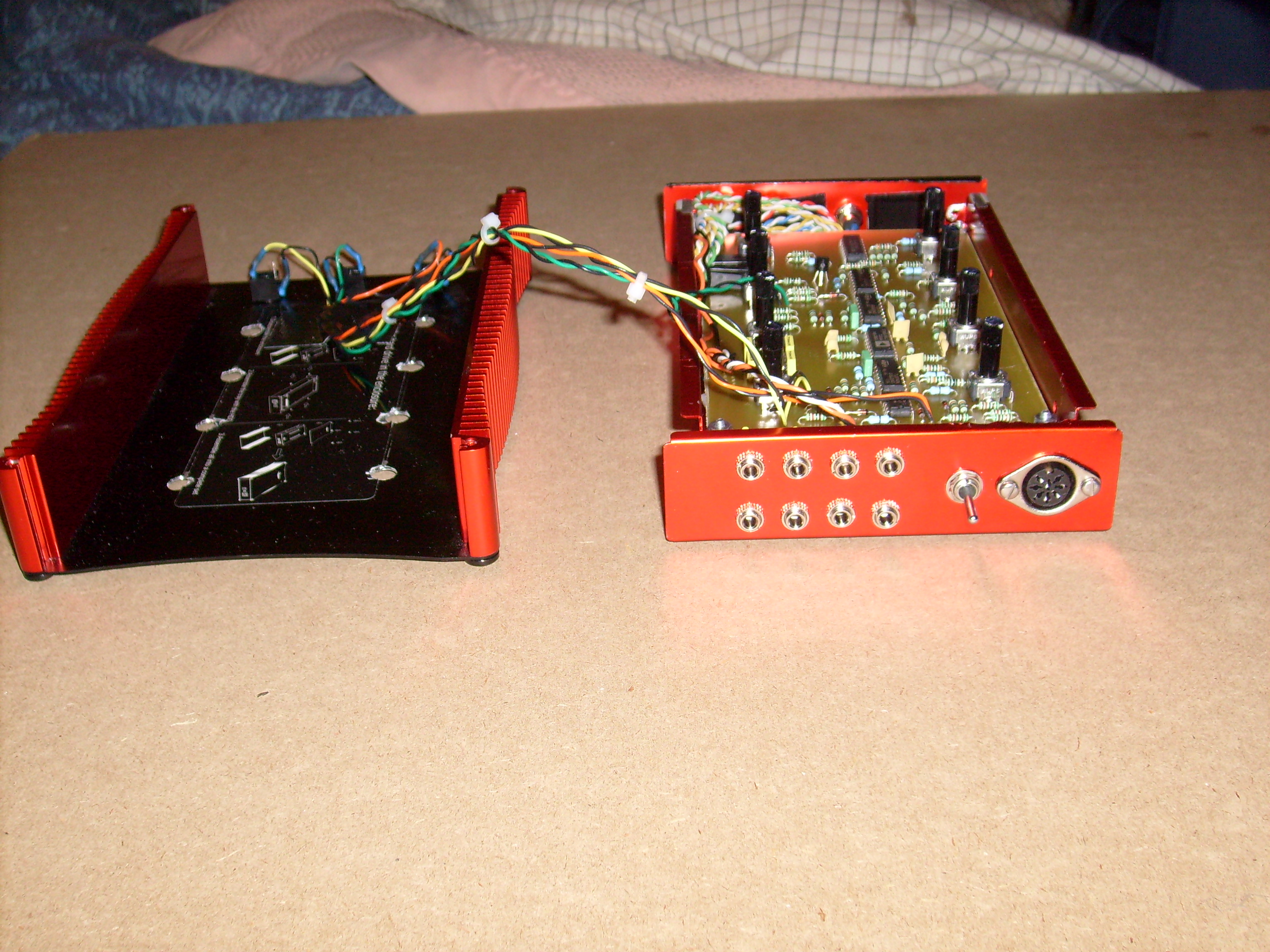

Here is my Completed case for the Benjolin.
I agree that sockets would have been greatly appreciated. The PCB was very high quality for a home etched unit. Kudos to Rob and Joker for the workshop.

A couple more...

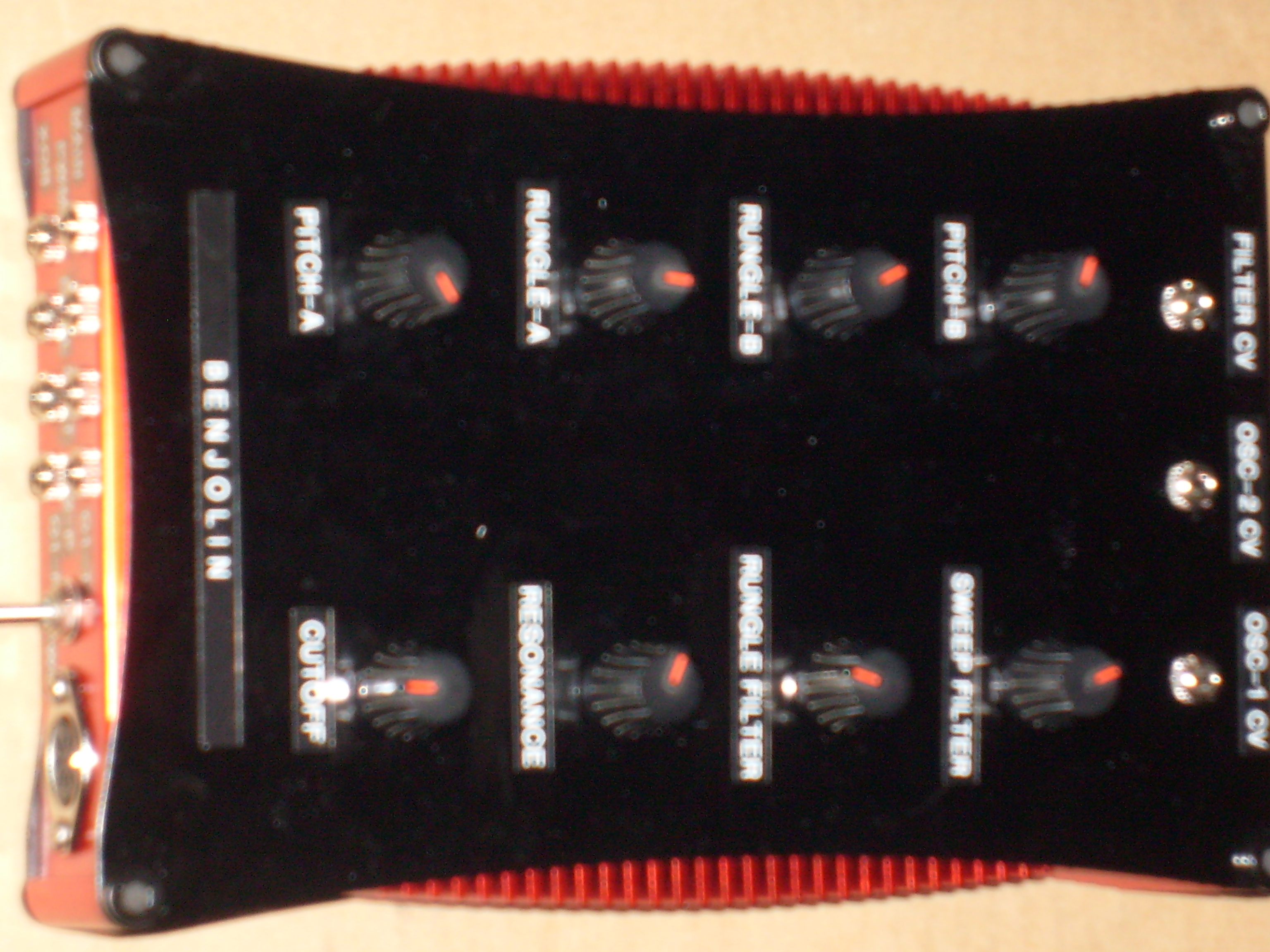

Here's the labels for the knobs.

Wow, that is nice work, you were right about the case Cool
Posts: 2810
PostPosted: Tue Nov 03, 2009 4:06 pm    Post subject: Reply with quote  Mark this post and the followings unread
Holy cow Dan !!! That is really beautiful. I love it. Looks like a hard drive enclosure. Nice idea !! Now you have no excuse not to jam at EM 2010 Wink

Thanks,
Yes it is a Hard Drive enclosure. The USB circuit in the enclosure had failed. Seemed just perfect use for the thing.
Worked on the case two days straight. I rather like it.

Just figured out that in my haste, I put the knob labels on incorrectly. I've replaced the photo. Sorry for the fuzzy image.

So, lables according to Dan:
Benjolin circuitboard with the knobs labeled

PostPosted: Tue Nov 03, 2009 6:35 pm    Post subject: Reply with quote  Mark this post and the followings unread
Yes, see this link for verification:
http://web.me.com/klangbureau/DIY/making_of.html
