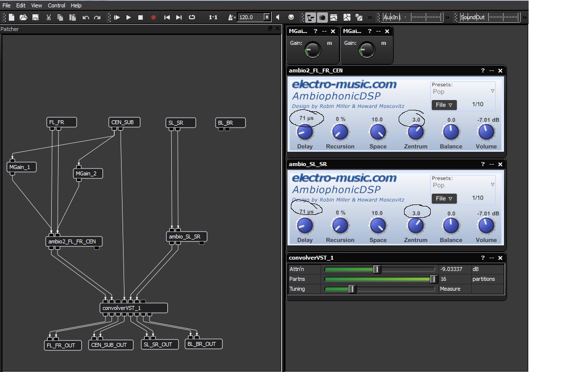

janderclander14 wrote:
Hi! I'm also using audiomulch as vst host to process multichannel audio applying ambio+DRC. I'm very interested on how have you configured and routed signals in audiomulch. Currently, I'm applying ambio correction for every pair of speaker combinations using several instances of the VST plugin. Could you post your audiomulch layout? Thanks
Hi janderclander,
because i use single drivers with sub for front and single drivers w/o sub for rear ambiopoles it´s a simple layout:
http://img260.imageshack.us/img260/23/amulch.jpg

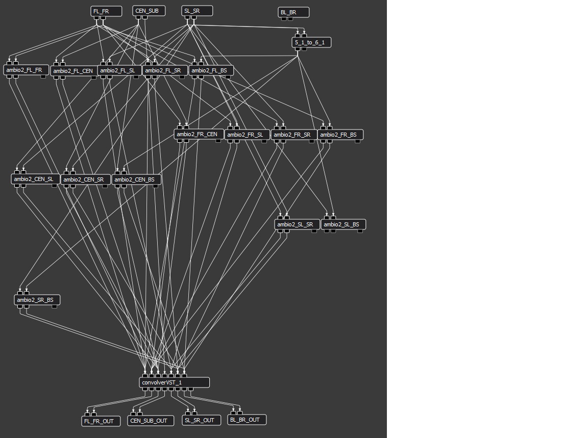

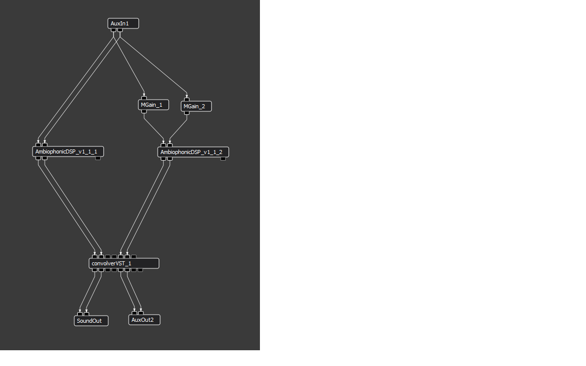

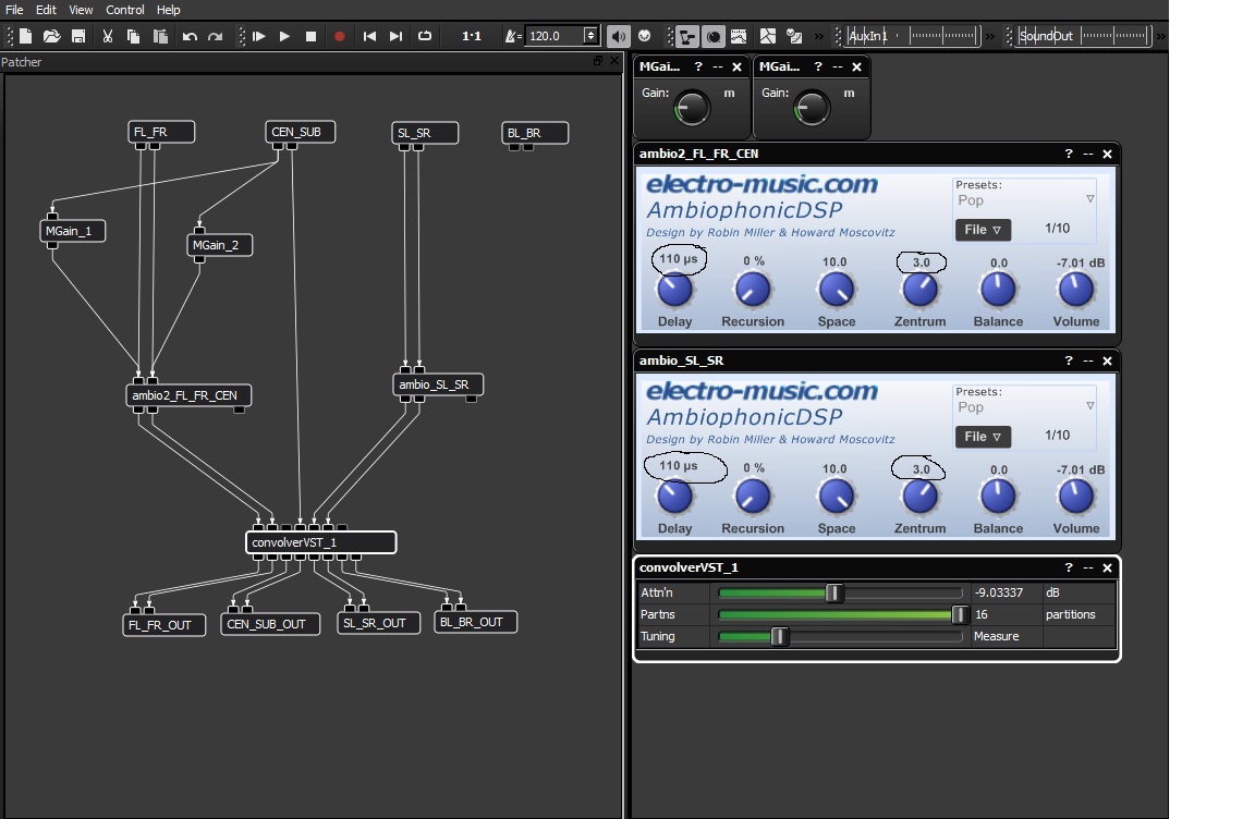

Thanks again rmiller for your answers. A fully multichannel ambiophonic plugin would be awesome! From what I've tested in the past (both hardware and software), only multichannel DRC arrives at the same level of dramatic sound improvement.
Previously, in my 6.1 setup, I used audiomulch and several ambioVST instances for EACH pair of speakers, all with all (i.e. FL & CEN, FL & FR, FL & SL, FL & SR, FL & BS; CEN & FR, CEN & SL and so on) (see the attachement "full 6.1. ambiophonics"). My idea was to use all the speakers at the same time but cancelling the crosstalk between ALL of them.
If I understood correctly, in order to implement ambiophonics over a 5.1/6.1/7.1 input, the center channel should be mixed in both front left and right channels (with half the volume on each one, I suppose) and the center speaker is no more needed. The same goes for the Back surround channel (I removed it since is was matrixed from surrounds). Is this true even in a non-ideal 16 angle separation setup (i.e. 30-40 degrees)? I'm a little reluctant to remove the relatively expensive center speaker... Wink
I attach a capture of the current audiomulch setup for this configuration ("4.1 ambio"): FL and FR channels go to the input of an ambioVST instance, each one mixed with an attenuated copy (-3 db) of the center channel. SL and SR channels go to another ambioVST instance. Each output (in conjunction with the original LFE signal) goes to the corresponding input of a multichannel convolver for DRC correction.
You can see that I modified the delay and Zentrum parameters for both instances from the default values in the "Pop" present. However, the problem is that when I save the layout and re-open audiomulch, the Zentrum value (3) is properly loaded, but the delay value is resetted to the original value (71 us). The same problem appears for "global" parameters such as balance but not for "local" ones such as recursion or space. Is anybody experiencing this problem?
Regards
[ However, the problem is that when I save the layout and re-open audiomulch, the Zentrum value (3) is properly loaded, but the delay value is resetted to the original value (71 us). The same problem appears for "global" parameters such as balance but not for "local" ones such as recursion or space. Is anybody experiencing this problem?
Regards
This was a conscious design decision. The thinking was that when you adjusted the delay, balance, and volume, these should stay. It's annoying to find the correct delay and then change presets and it goes back to something else.
We can reconsider this for a future update. I think that something can be done to accommodate both situations.
Keep those cards and letters coming... Smile
As for Audiomulch not restoring presets... I believe that if you save the layout, it will save the knob and preset values. This is that way most VST hosts work.

Hi!
I agree on the behaviour regarding parameters which are common to any present such as delay or balance. The problem is that as far as I've tested (I've used audiomulch v1 and v2.03) they are not properly re-loaded after saving the layout.
I assume that this may be a problem concrete to my configuration or maybe I'm doing something wrong. So, it could be great if someone can confirm if those setting are properly loaded by audiomulch when modified.
Regards
I have tested this with Ableton Live which is perhaps the gold standard for VST hosts. I can recreate your problem. Every time I restart the "global" parameters are reset. It's not a problem with your set up. We need to rethink this decision to separate these functions from the presets.
Robin and I usually get together on Tuesdays. We'll discuss this and come up with a fix. Thanks for the feedback.

Dear janderclander14 and others interested in Ambiophonic DSP for 5.1...
I believe that janderclander14's 5.1/6.1 "multi-pairwise approach," showing 15 instances of DSP, goes beyond what is necessary, and may have unintended consequences, generating audible artifacts.
Regarding the need: In normal hearing (live or reproduced) we use small, unconscious head movements to confirm localization, usually horizontally on the order of a few degrees, but up to about 45deg max if a bus is about to hit you from behind. Headphone listening thwarts this, but Ambiophonics allows it to occur naturally. (Ambio could be called "virtual headphone," without the discomfort or in-head sounds, or "speaker binaural.") Since our ears are on the sides of our head, we'd need to be turned uncomfortably beyond 45deg up to fully 90deg on either side to hear binaural between side pairs (in 5.1 terms, between L and SL or between R and SR). In any case, most commercial 5.1 recordings have irrelevant HRTF-binaural information between side pairs, as surround mics are typically many meters from front mics, or surround signals are generated artificially.
Furthermore, Ambio DSP between Center and SL or SR has little meaning. Note that most commercial 5.1 music recordings and movies only pan spot mic signals to C, and so contain no binaural information, and therefore C is not paired spatially with any other channel. (Distances are too great for HRTF-binaural in the case of movie music typically using Decca Tree L-C-R mics; OCT 5.1 micing works, but hasn't gained the traction it deserves.)
Add the unintended consequences: In the multi-pairwise approach there is the artifact of crosstalk-cancellation (XTC) signals introduced, say for the FL-SL pair, into the FL speaker that are not canceled in FR, and similarly for any other partner of a pair either in front or in back, where within normal head-turning range, binaural perception IS at work.
My advice for using Ambiophonic DSP for 5.1 surround as I do is to keep it simple and only use two instances of Ambiophonic DSP, similar to your simpler diagram above (except you need only one control and therefore one instance of MGain for Center signals as the output can be wired to both channel inputs of the following ambio2_FL_FR_CEN contraption). The result is artifact-free 5.1 reproduction within a reasonable range of head-turning.

Thanks again, rmiller, for the very informative answer.
I can confirm that the simpler two pairs ambio setup is prefferable and more natural. I've been enjoying it all the day providing a seamless integration of the expanded front stage and the widen surrounds (wider than even using a 7.1 speaker configuration with 4 surrounds).
A final question: currently I'm using as back ambio speakers a pair of dipoles. As those speakers use a diffuse radiating pattern, do you think they may affect the ambio principle and it would be better to use monopoles?
Regards,

janderclander14
Joined: Dec 02, 2008
Posts: 28
PostPosted: Sat Nov 28, 2009 7:20 am    Post subject: Reply with quote  Mark this post and the followings unread
So far I've been enjoying AmbioDSP for both stereo music (using a vst bridge for foobar) and 5.1 movie soundtracks via the audiomulch setup posted above (two pairs of ambio front-back).
A part from the little anoyance to re-set the configuration delay (as stated above) which I suppose it can be easily fixed in a new revision of the plugin, I can confirm that the listening experience is highly improved. For movies I found that, even using dipolar speakers, the fact that they have been DRC corrected supposes a quite satisfying integration with the expanded front stage, but providing a wide and diffuse soundfield which actually came from the room, not confined to the speakers. The only consequence is that surround sounds are harder to localize that front ones, but I found this quite desirable. The result is an amazing almost 360º sound envelop.
Now I am interested on trying the bi-ambio setup stated previously for stereo music (i.e. using also the back speaker pair). If I understood correctely, I have to replicate the stereo front signal, attenuatte it (6 db) and feed it to back speakers (FL-> SL; FR->SR?) through a new ambio dsp instantance. I'm attaching the audiomulch audio layout fo this setup. Could you please confirm if it is correct?
Another question: in order to apply a multichannel ambio currently I use a VST host and a virtual audio cable application which, in conjunction with ASIO drivers, redirect the sound from the player's output to the host (to apply DSPs) and from that, to the soundcard's outputs (my soundcard does not support rewire or native re-routing). Even though this procedure works, I experience some sound drop-outs (no matter which asio buffer I use or how much I increase the latency and process priority) and I have to manually set the vst host every time.
In this sense, a directshow sound filter which could be loaded directly on the player (like ffdshow audio filter) will provide a much better integration with the application and a greater reliability. Do you think it could be possible to offer a directshow version of the dsp for multichannel audio (similarly to the multichannel convolver I'm using which offers VST and directshow versions in the same package http://convolver.sourceforge.net/)?
Regards,

rmiller
Joined: Feb 03, 2003
Posts: 42
Location: Bethlehem PA 18018 USA
PostPosted: Mon Nov 30, 2009 9:12 am    Post subject: Reply with quote  Mark this post and the followings unread
Quoting janderclander14 above:
...trying the bi-ambio setup stated previously for stereo music (i.e. using also the back speaker pair). If I understood correctely, I have to replicate the stereo front signal, attenuatte it (6 db) and feed it to back speakers (FL-> SL; FR->SR?)...
Correct, including your Mulch patch (tho you could simplify using stereo gain contraption "SGain" instead of two "MGain"). Attenuation for the back speakers may be -10dB depending upon how sensitive you are to the illusion that the direct sounds (sources "on-stage") aren't still in front.
BTW, the reason for duplicating the front signals in back is to further widen the front stage. It works because the brain figures that even though the added speakers are behind, say the FL and BL emit identical signals, which could only exist in the middle of your head, or on your left side. To paraphrase Sherlock Holmes, when you've eliminated all but one possibility, the last remaining illusion confirms the front has widened further, extending perception typically from up to 120deg for front-only speakers to 150deg (increasing from 2x to 2.5x the width of conventional stereo!), so even further into regions of maximum Listener Envelopment. The downside is that now in addition to a side-to-side limitation with a front-only pair for critical listening along the "sweet-listening line" that can accommodate 3~4 listeners max (depending on the dimensions of your layout), you now have (for given back level and delay settings) a front-to-back limitation as well, making it a true "sweet spot" (point) for just 1~2 listeners in a large layout (>12ft between speaker pairs). This is no problem for an electronic music composer and a guest, and the benefit is taking Ambiophonic DSP from astounding to unbelievable.
Just for others' info, you don't need to buy the second instance of Ambiophonic DSP, just open a second instance of it in AudioMulch or other multi-channel-capable host. (Or if you sit directly at the center of four identical speakers, just use one instance and attenuate from the AmbioDSP output to the host's back outputs, or in a still simpler case use a single instance within a 2-channel host and attenuate the power amplifier driving the back pair.) Eventually, you'll use the back pair for full, 5.1-compatible PanAmbio surround using four speakers (none interfering with your display), as discussed a page earlier on this forum!
Robin Miller

janderclander14
Posts: 28
PostPosted: Tue Dec 01, 2009 1:11 am    Post subject: Reply with quote  Mark this post and the followings unread
Thanks rmiller. As you said, the stereo separation is even more wide. I also have the illusion that the ambience of the recording is actually coming from behind meanwhile the soundstage is dispersed in the front. Very nice! I found that -10db of attenuation is better than -6db which makes the effect too obvious and a little distracting.
Another question: I'm currently using a 4.1 setup in which the four main speakers are monitors with low frequency content (below 80hz) redirected to a subwoofer (via the bass management of the soundcard driver). However, I was wondering, if bass content is typically mono an present in both stereo channels, when this signal is passed through the ambio plugin, it will create the cancellation assuming that it will be played through a pair of speakers. As the signal is redirected to the subwoofer, at the end, it will be forced to play the original signal and also the inverted one and may be producing a undesired cancellation.
Do you think it will be prefereable that, in a setup like this, to separate the bass content from the stereo signal with a crossover (with a vst component), to bypass the ambio dsp and to feed directly the subwoofer (much like the LFE signal in the 5.1 setup posted above) meanwhile the main speakers a feed with the ambio signal above 80hz?
And finally, considering that now a have some channels available in the soundcard, do you think it would be beneficial to add another subwoofer (I have a spare non-identical one) as an additional sound channel and to create a new "ambio stereo pair" with two subwoofers only for the bass content?
Regards,
