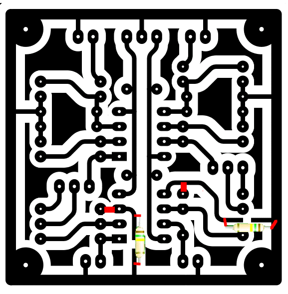

I think I have found the root of the problem. While doing the latest set of tests you suggested, I realized that I wasn't doing the adjustments while looking at the correct output. I was monitoring it from the final output (after the addon mixer).
Here is the input wave : (1 square = 5V)
After monitoring from pin 7 on U3b, and then pin 1 (U3a) for the balance, I could get the correct swaying waveform when un-shorting mod 1 from ground.
Pin 7 output :
Pin 1 output :
I also noticed that the output from pin 1 is inverted from the ouput from pin 7. The problem is, when this shifted, inverted wave is mixed with the original input wave (as is hardwired in my version - I wasn't too worried about quadrature LFO usage) the resultant wave is a square wave, and the effect is the same as PWM on a pulse output, as shown in these pictures :
Just wondering, is this the correct usage? Maybe I've wired it wrong, since I was expecting to be mixing 2 non-inverted sawtooths. |

OK I did some simulations and you are right, I did not realize that the waves were in opposite. I will let you know how to modify the add-on board to solve this. In fact I will propose a new add-on board !!! _________________ Yves |

Hi Kx
Here is how to fix the add-on board to obtain the right mixture.
I will also update the drawings above with an update version of the add-on PCB.
| Description: |
| The red arrows show which tracks must be cut and the blue arrows show the connections to be created with solder bridges |

| Description: |
| Once the wrong tracks are cut and the solder bridges (in red) made, solder two 150K resistors as shown |

OK I have changed the drawings at the beginning of this thread : new corrected addon-pcb _________________ Yves |

Hi Yves,
Thanks so much for adding those alterations, I applied them to my board this morning, and it works great. Sounds great too! My original 'imperfect waveform' does really well also, and in particular very interesting results come when using input from the 'skew' output of the TH XR-VCO.
Cheers  |
