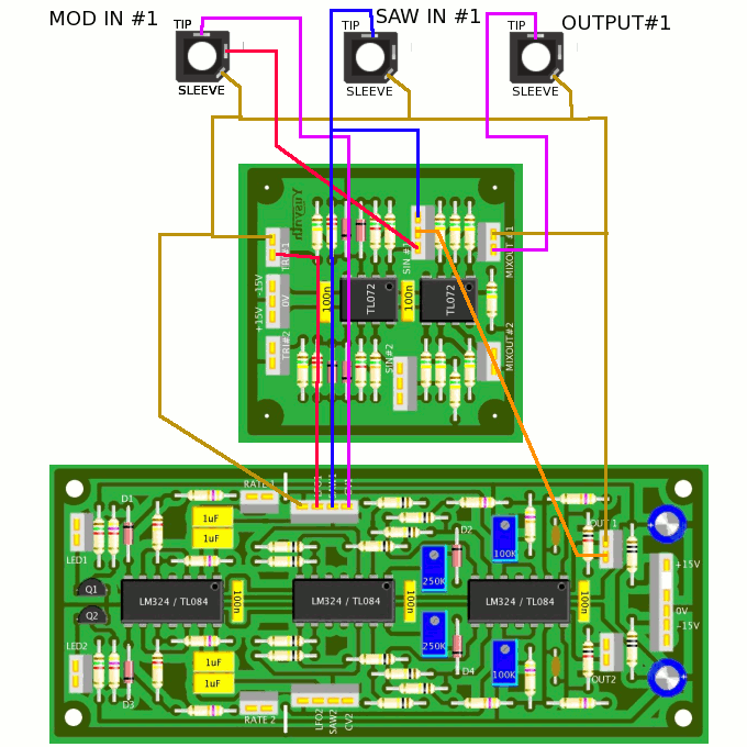

Is there an interconnection wiring diagram available for this add on board?
I'm not too great at reading schematics.
No, but I will try to draw one...
Yves

PostPosted: Tue Jan 04, 2011 10:10 am    Post subject: Reply with quote  Mark this post and the followings unread
My pcb is still in the backlog, but this is how I would wire it up. Not tested so it might be some errors!
For the first part, the waveshaper, exchange the red cable going from LFO to Mod in the original wire diagram with,
Code:
                     ________________
LFO ---> Triangle_in*| add on board |*Sine out --> Mod in
                     |______________|
and for the output,
Code:
                                    ________________
Dry Saw input       -->      Saw In*| add on board |*Output --> New Output
Original Saw Output --> Shifted Saw*|              |
                                    |______________|
"Dry saw input" is the same signal as you insert into the SAW pin, copper coloured.
"Original Saw Output" should the the purple output pin.
"New Output" is your output jack on the panel.
Do the same for both animators.
Yves mentions a switch on the output, that have not been added in this example. Havn't had the chance to try it out, so not sure if you need it.
yusynth
Joined: Nov 24, 2005
Posts: 1314
PostPosted: Tue Jan 04, 2011 10:17 am    Post subject: Reply with quote  Mark this post and the followings unread
Yes iopop3, your diagram is correct, nice ascii rendering by the way !
Yves

No LektroiD, your diagram is not correct. I sketched one very quickly that shows the wiring for one channel only in order not to overload the sketch.
Here it is :
 Filesize:  121.79 KB
 Viewed:  498 Time(s)
Here it is :
I wired up exactly as you suggested, but it doesn't work. I have attached an mp3 example of what I'm getting. It was working better without this add-on board, at least I had some kind of saw happening. The results are the same for both sides of the circuit (saw anim 1 and saw anim 2).
Basically I get clicks as the modulation cycles. you can hear the saw input as I switch it on and off. I also increase the rate up and down, once without the saw and second time, with.

PostPosted: Mon May 02, 2011 11:37 pm    Post subject: Reply with quote  Mark this post and the followings unread
Post a photo of the add on board track side and one photo of the components side such that I can check there is no mistake.
Just to be sure were you powering the addon board ? I did not show the power wire on the wiring diagram because it was obvious but one never knows...

PostPosted: Sun May 08, 2011 4:55 pm    Post subject: Reply with quote  Mark this post and the followings unread
Please let me know if those photos are ok, or if anything is amiss.
I left the saw in 1 tip connected to the switch terminal of saw in 2, would that cause any problems? It's the only wiring that's not mentioned on the add-on board.
Incidentally, has anyone managed to get their add on boards working successfully, or am I the only one who can't get it working?

PostPosted: Sun May 08, 2011 11:30 pm    Post subject: Reply with quote  Mark this post and the followings unread
The wiring diagram is logically completed by mirror symetry.
I know at least three other people beside myself who built it without a problem.
I cannot see any obvious error on your PCB however you may check with a continuity tester that there is no shortcut between tracks or a microbreak in a track.
Check that the ICs on the board are correctly powered (+15V on pin 8 an -15V on pin 4). Have you checked the AOP ICs ?
