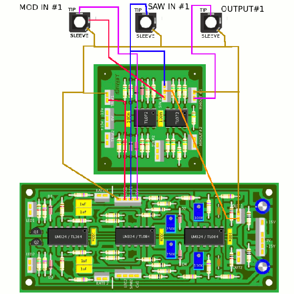

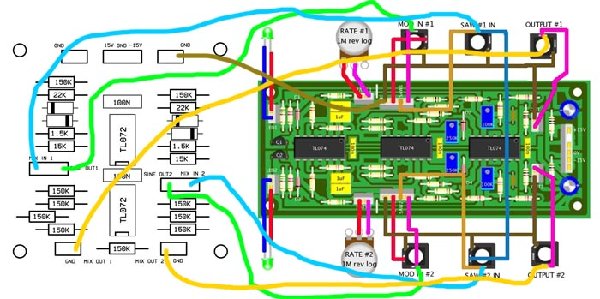

PostPosted: Thu Dec 02, 2010 11:40 pm    Post subject: Reply with quote  Mark this post and the followings unread
Is there an interconnection wiring diagram available for this add on board?
I'm not too great at reading schematics.
LektroiD
yusynth
Joined: Nov 24, 2005
Posts: 1314
PostPosted: Sat Dec 04, 2010 3:06 am    Post subject: Reply with quote  Mark this post and the followings unread
No, but I will try to draw one...
Yves

PostPosted: Tue Jan 04, 2011 11:10 pm    Post subject: Reply with quote  Mark this post and the followings unread
Can't really understand the ascii examples as there is only the add on board and not the main board showing, plus the labels you used don't match up with what's on the silk screen (I guess it's ok if you already know how it should be).

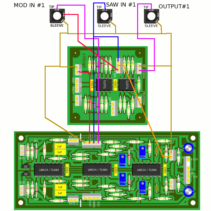

yusynth
Posts: 1314
PostPosted: Wed Jan 05, 2011 12:29 am    Post subject: Reply with quote  Mark this post and the followings unread
No LektroiD, your diagram is not correct. I sketched one very quickly that shows the wiring for one channel only in order not to overload the sketch.
Here it is :
 Filesize:  121.79 KB
 Viewed:  496 Time(s)
Yves

PostPosted: Mon May 02, 2011 7:54 pm    Post subject: Reply with quote  Mark this post and the followings unread
Here it is :
I wired up exactly as you suggested, but it doesn't work. I have attached an mp3 example of what I'm getting. It was working better without this add-on board, at least I had some kind of saw happening. The results are the same for both sides of the circuit (saw anim 1 and saw anim 2).
Basically I get clicks as the modulation cycles. you can hear the saw input as I switch it on and off. I also increase the rate up and down, once without the saw and second time, with.

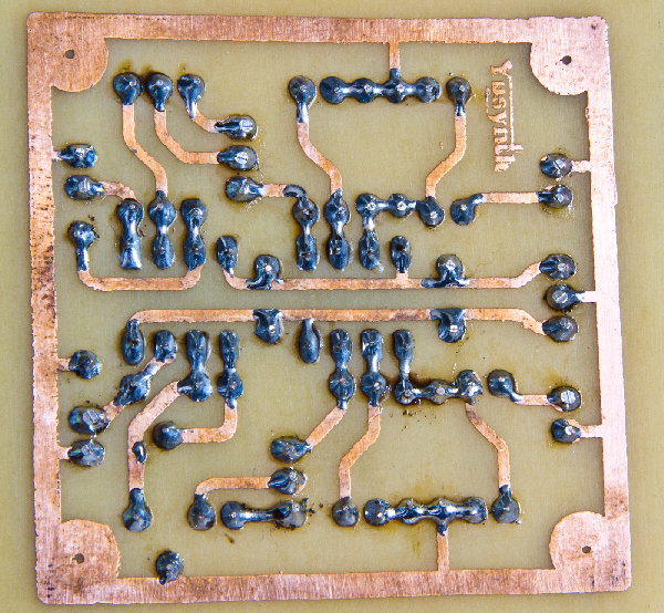

Post a photo of the add on board track side and one photo of the components side such that I can check there is no mistake.
Just to be sure were you powering the addon board ? I did not show the power wire on the wiring diagram because it was obvious but one never knows...
Yves
LektroiD
Joined: Aug 23, 2008
Posts: 1019
PostPosted: Tue May 03, 2011 5:20 am    Post subject: Reply with quote  Mark this post and the followings unread
I piggy-backed the power from the main board.
Top
 Filesize:  2.76 MB
 Viewed:  436 Time(s)
Bottom
 Filesize:  2.04 MB
 Viewed:  463 Time(s)

PostPosted: Sun May 08, 2011 4:55 pm    Post subject: Reply with quote  Mark this post and the followings unread
Please let me know if those photos are ok, or if anything is amiss.
I left the saw in 1 tip connected to the switch terminal of saw in 2, would that cause any problems? It's the only wiring that's not mentioned on the add-on board.
Incidentally, has anyone managed to get their add on boards working successfully, or am I the only one who can't get it working?
LektroiD
yusynth
Posts: 1314
PostPosted: Sun May 08, 2011 11:30 pm    Post subject: Reply with quote  Mark this post and the followings unread
The wiring diagram is logically completed by mirror symetry.
I know at least three other people beside myself who built it without a problem.
I cannot see any obvious error on your PCB however you may check with a continuity tester that there is no shortcut between tracks or a microbreak in a track.
Check that the ICs on the board are correctly powered (+15V on pin 8 an -15V on pin 4). Have you checked the AOP ICs ?
