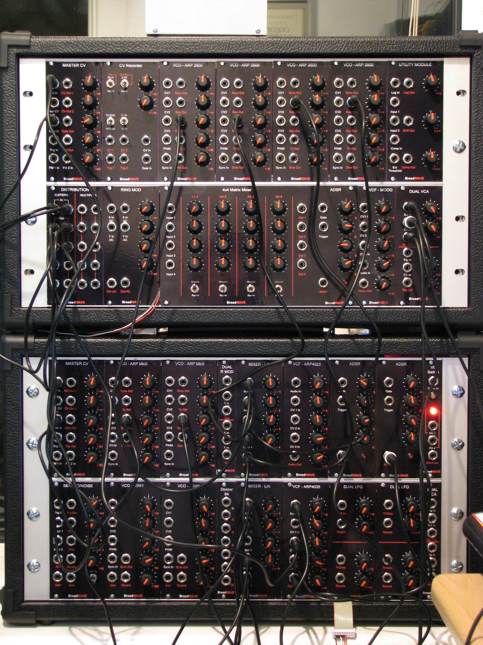

It's taken almost two years, but I've finished my modular (although it's tempting to add another cabinet or two!)
Top Cabinet:
Master CV (Buffers, Tune, Glide, 2 x FM inputs)
CV Recorder (AC PIC Sequencer)
4 x ARP 2600 VCO's with additional sync
Thomas Henry's Potpourri Module
CV Distribution (2 x Buffers, 2 x Multiples)
Ring Mod
4 x 4 Modulation Matrix Mixer
ADSR (Curtis CEM 3310 )
Moog VCF (Doepfer Clone)
Dual VCA (Curtis CEM3330)
Lower Cabinet:
2 x ARP Odyssey MkIII VCO's
2 x ARP Odyssey Ring Mod
4 Chanel Mixer
VCF (ARP 4023 12 db, Odyssey MkI)
2 x ADSR (Curtis CEM 3310)
Signal/CV Switch (ARP 2600)
S&H/LFO/Noise (ARP Odyssey MkIII)
2 x ASM 1 VCO
Clock Divider/Sub Oscillator /2 to /64
4 Chanel Mixer
VCF (ARP 4035 24 db, ARP 2600)
2 x Dual LFO with shape
There are several modules left over from experiments which I need to add at some point, but I need a break Very Happy
Many thanks to all who helped solve some major headaches.

what a beautyfull system! i love the colors and the potentiometers strictly put in columns.
and a realy nice module selection.
BTW what does the master CV module do?
Broadwave
Joined: Feb 16, 2007
Posts: 347
Location: Manchester UK
Audio files: 6
PostPosted: Fri Jan 22, 2010 5:12 am    Post subject: Reply with quote  Mark this post and the followings unread
Thanks, I'm seriously pleased with it - I couldn't come up with a layout that bettered the standard Euro Rack look (Doepfer/Analogue Solutions etc.).
The master CV module just provides 1v/Oct, gates and triggers from my Kenton USB Solo, to all the oscillators on a buss system similar to Doepfer.
The Aux CV, lag and FM inputs are summed to the main CV buss, to allow me to tune and modulate *all* the oscillators, without any additional patching. The VCO's can be disconnected from the main buss by inserting a dummy jack into the CV1 socket.
The 2600 VCO's make great VCLFO's just by patching in -15v, although I think 8 VCO's is too many!! - I may take out the ASM 1's and replace them with something more useful.
I think I could do with a few general purpose modules (inverters, audio in, envelope followers etc), but they will have to wait until I complete another project I'm working on Very Happy

Its very nice arp-like lookin' system u have there!
Cool

Nice Arp looks, where did you get the panels made? Are you using a MAC specific program for the artwork?

They're just self adhesive, inkjet printable vinyl labels (nothing fancy). I used Adobe Illustrator for the layout... How did you know I used a Mac??? Very Happy

Andy -- Are there any issues with the labels lifting off at the edges/corners?

I did initially have a problem with the labels peeling, mainly due to the Schroff 3U blanks being chamfered on the edges, which caused the label to lift - but because I didn't need the fancy brushed alu finnish, I stuck the vinyl to the "wrong" side (no chamfered edge) so the labels seem to stay put... It just takes a bit of patience to apply them without getting air trapped Rolling Eyes
I've now stopped buying Schroff blanks, as I've discovered that 3mm perspex, is just as good, easier it work with and cheaper.

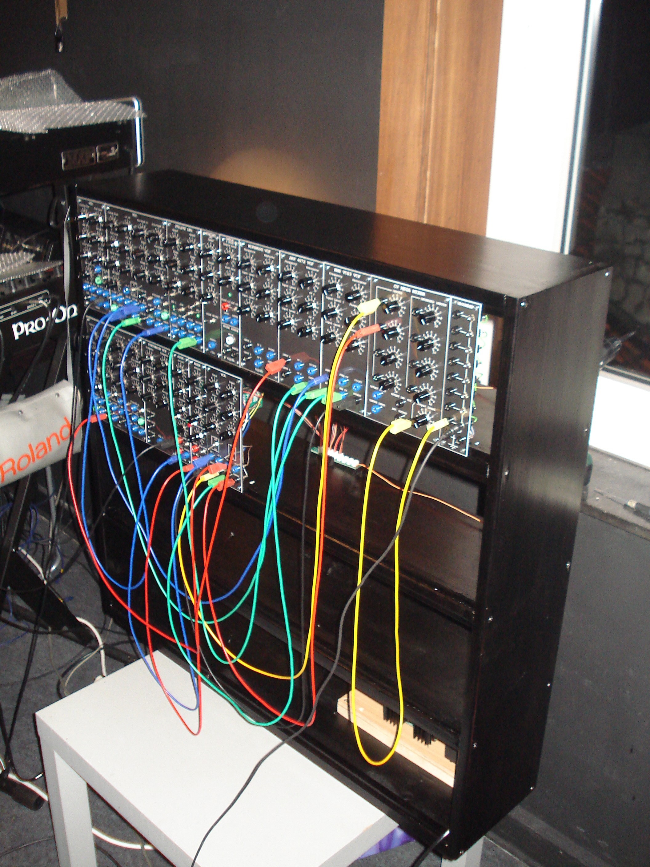

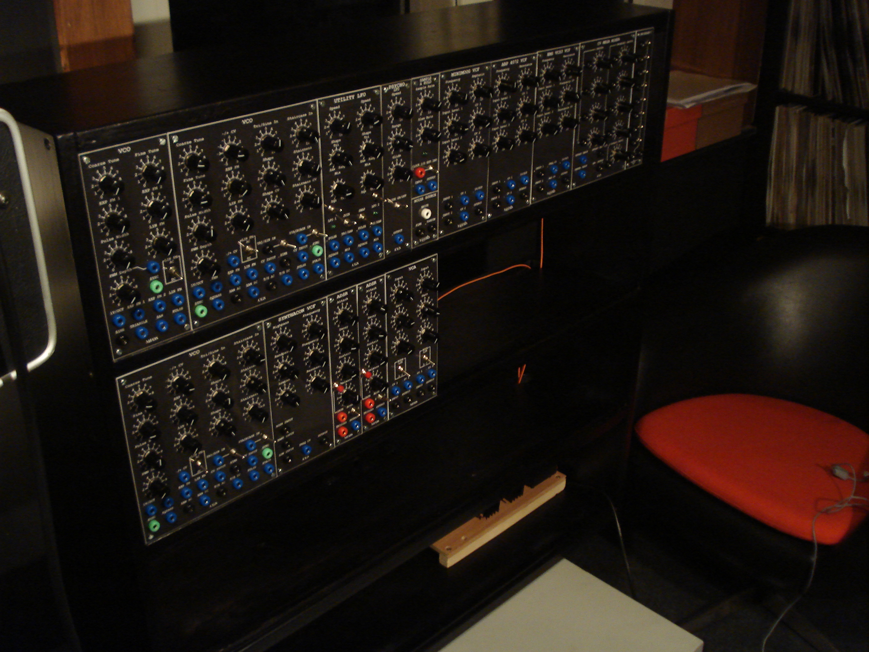

This is my first homebuild modular, I ordered the pcb's and part's in june 2009 & started to build begin september 2009 on the pictures you can see what I have done so far.
My goal is to fill up the whole cabinet. Smile

Nice,I like your panels

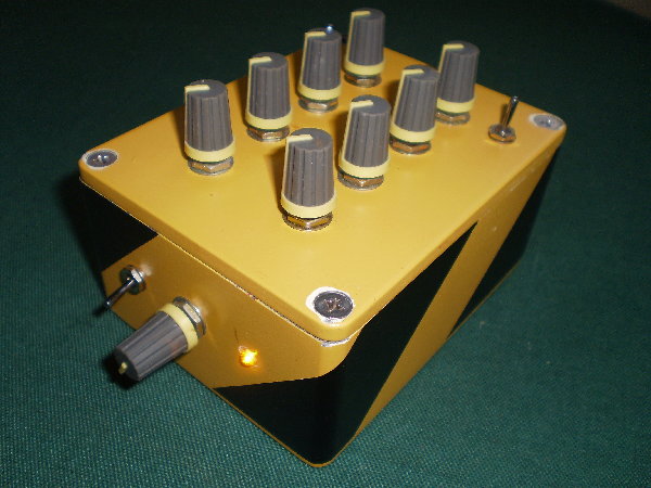

Atari PuNK Console... Atari style! I used black and woodgrain adhesive vinyl and cheap Letraset over a grey plastic box to give it that classic Atari console look.

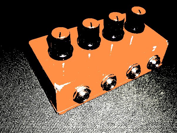

A simple Resistance Mixer...
