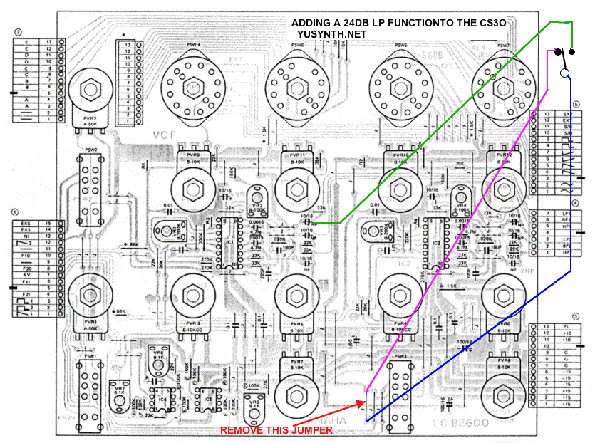

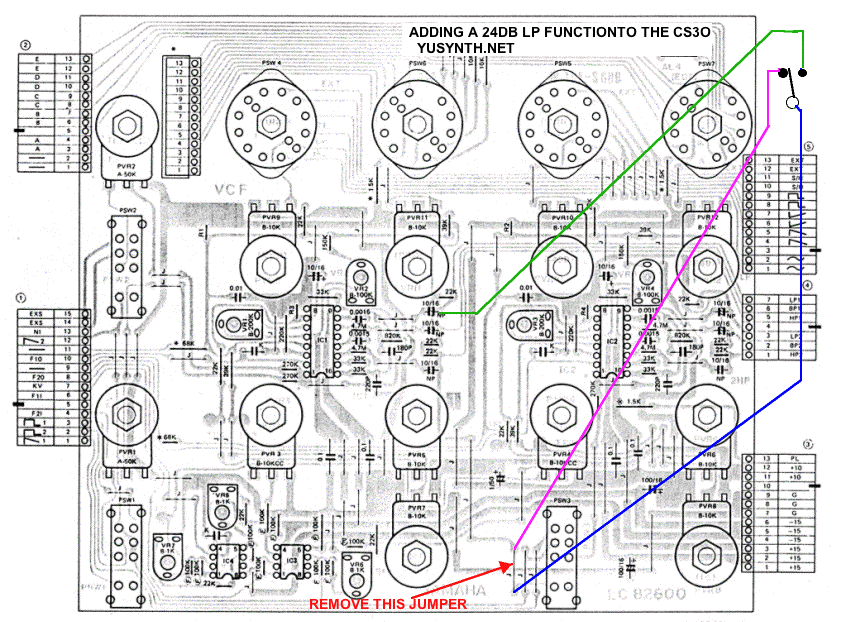

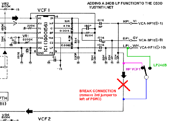

Hi Radek
I have no CS30 but from the schematics if I wanted to add a 24dB/octave LP function here is what I would do :
Schematics modification, the connection from the HP output of VCF1 to VCF2 is broken and a toggle switch is inserted to switch between the LP and HP outputs of VCF1. Obviously if you use a three voices switch you could also add the BP output of VCF1
 Filesize:  34.83 KB
 Viewed:  509 Time(s)
 Filesize:  155.6 KB
 Viewed:  578 Time(s)
Yves

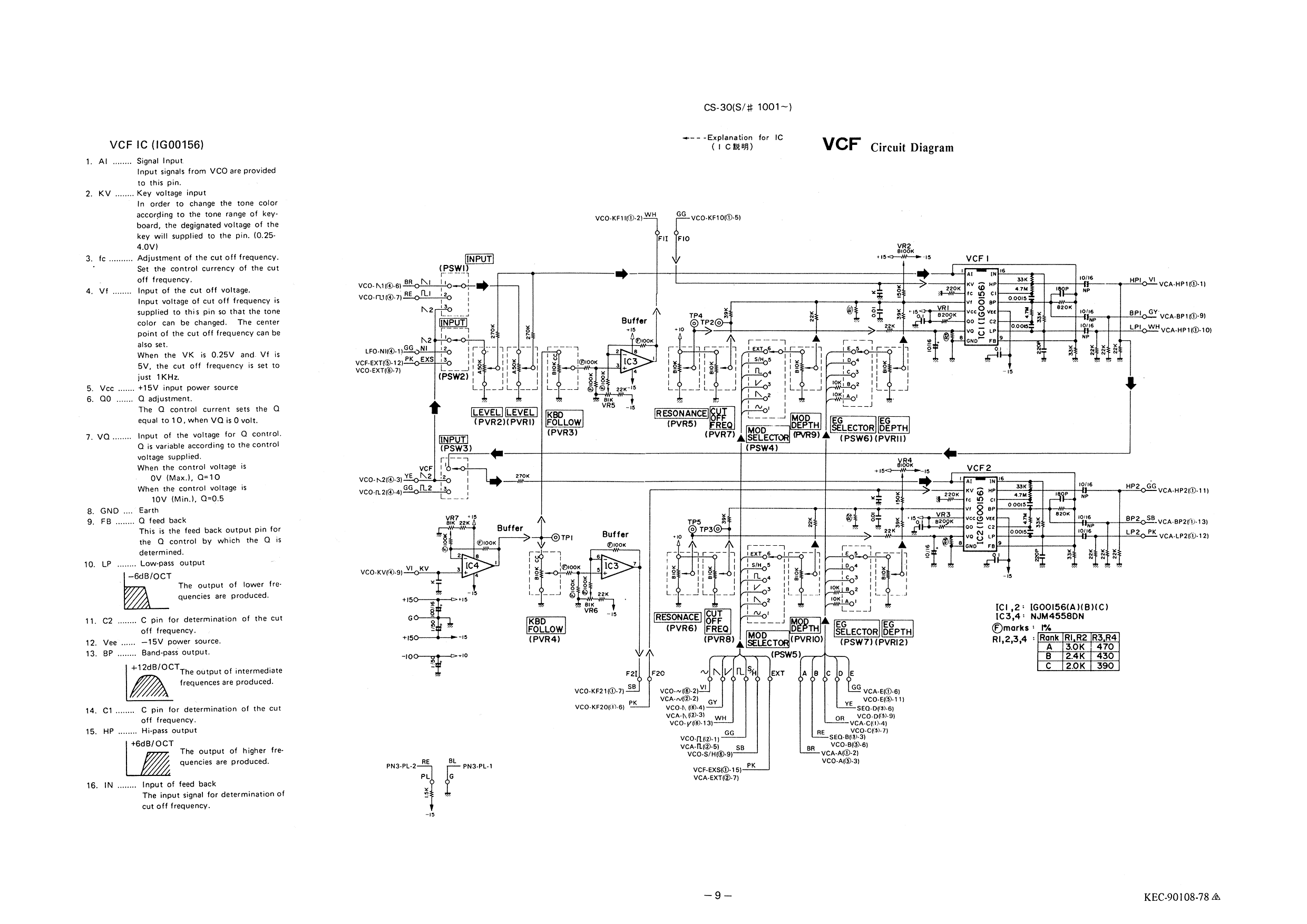

I am now interested in the Filter yusynth mod, but I was surprised to see the filter specs on the schematics: 6DB slope for HP and LP, 12DB for BP only!
 Filesize:  156.69 KB
 Viewed:  622 Time(s)

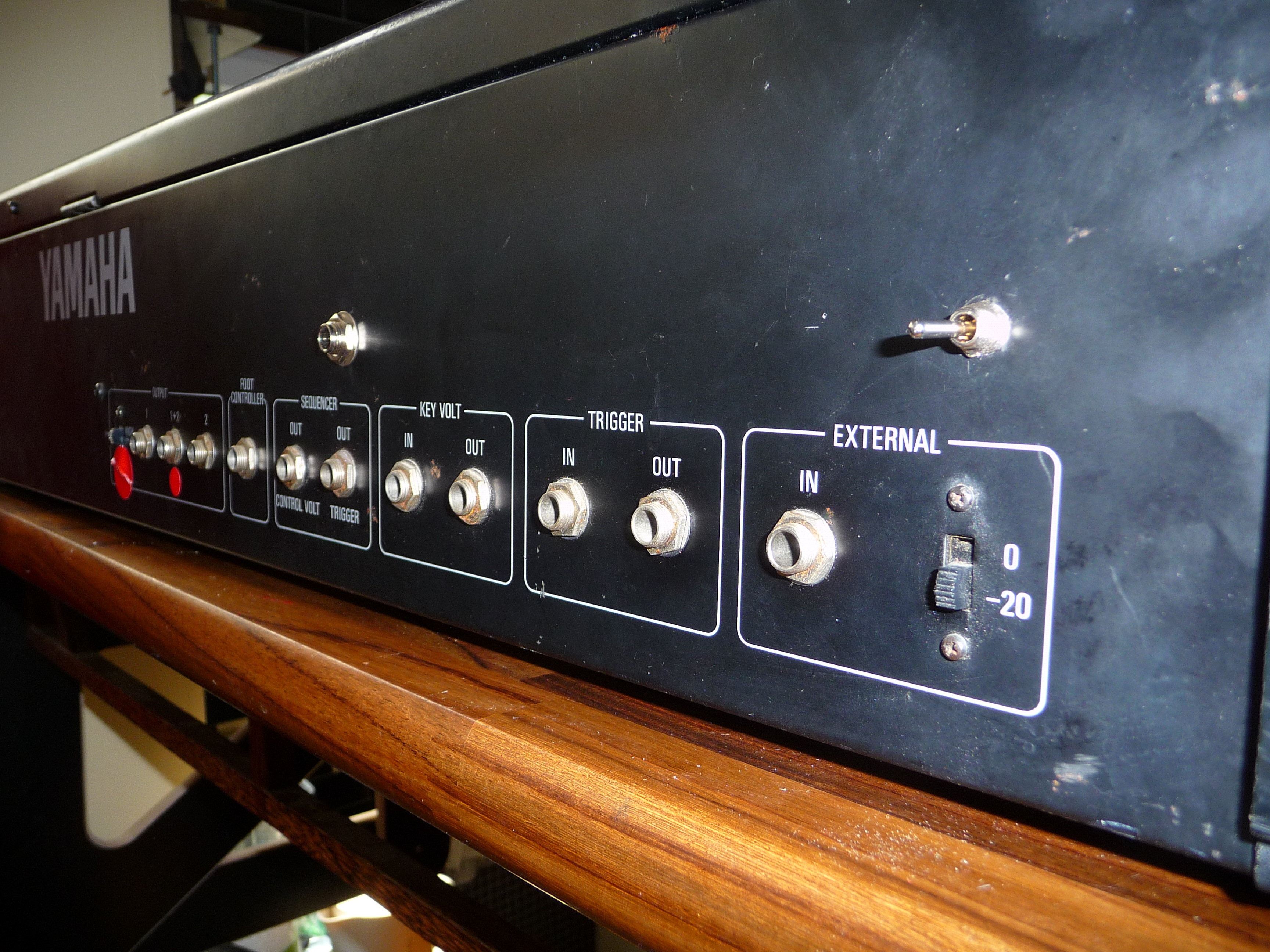

Over the serial filter 24 or 12 or 18DB/oct mod, I really would like to interface the CS30 to other gear, and I would really be able to externally control the VCFs (and LFO...) ...from synths, KORG MS04 or MSO1 pedal, Frostwave Beam (IR sensor) or Kenton or my Pulse + ( don't know if it should be linear or Log control though...)
Hope this can be accessible for an electro dummy like I.
meaning: I can solder, I have a simple tester , even have a scope somewhere in stock. But not really able to read a schematic...yet
Help would be appreciated nonetheless
The Fader for EG3 release is leaving me, if anybody knows where to find one...
here's a pic of the back of my CS as of today...
 Filesize:  4.16 MB
 Viewed:  527 Time(s)

PostPosted: Sat May 15, 2010 7:58 am    Post subject: Re: CS30 Filter in series Reply with quote  Mark this post and the followings unread
It is a typo of this manual, actually the corrrect legend should be LP 12dB, HP 12 dB and BP 6dB.
Yves
