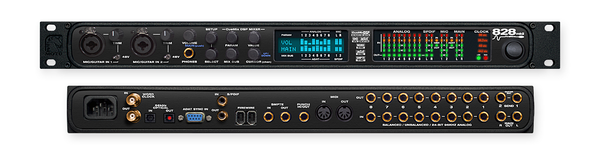

Dynaudio82
Joined: Jun 23, 2010
Posts: 8
Location: Russia
PostPosted: Wed Jun 23, 2010 1:10 pm    Post subject: Reply with quote  Mark this post and the followings unread
in the past i use a Tascam, now i only use the Motu 828mk2, is audio an card too, there i have connected the audio cables in Analog 1 and 2
This one i have:
http://www.majormusic.com.au/images/motu_828mkii_small_rgb.jpg
About your question of the menu, you mean this?

Wout Blommers
Joined: Sep 07, 2003
Posts: 4529
Audio files: 123
G2 patch files: 12
PostPosted: Wed Jun 23, 2010 1:29 pm    Post subject: Reply with quote  Mark this post and the followings unread
temptation_07 wrote:
... About your question of the menu, you mean this?
Yes, that's what I mean Smile
Are those 'Yoke' ports special Midi ports? I would select [828mk2] in both menu's. If you check it again, they will probably have been changed. That's a bug in NordGen. Select at MidiIn the [828mk2].
Is the Midi In on the Motu connected with the Midi Out of the synth?
If so, perform [Shift+DumpOne] see if the parameters (knobs) in NordGen has changed...

Just for others who are following this thread:
This is the Motu we are talking about...
