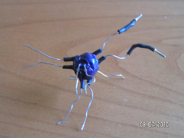

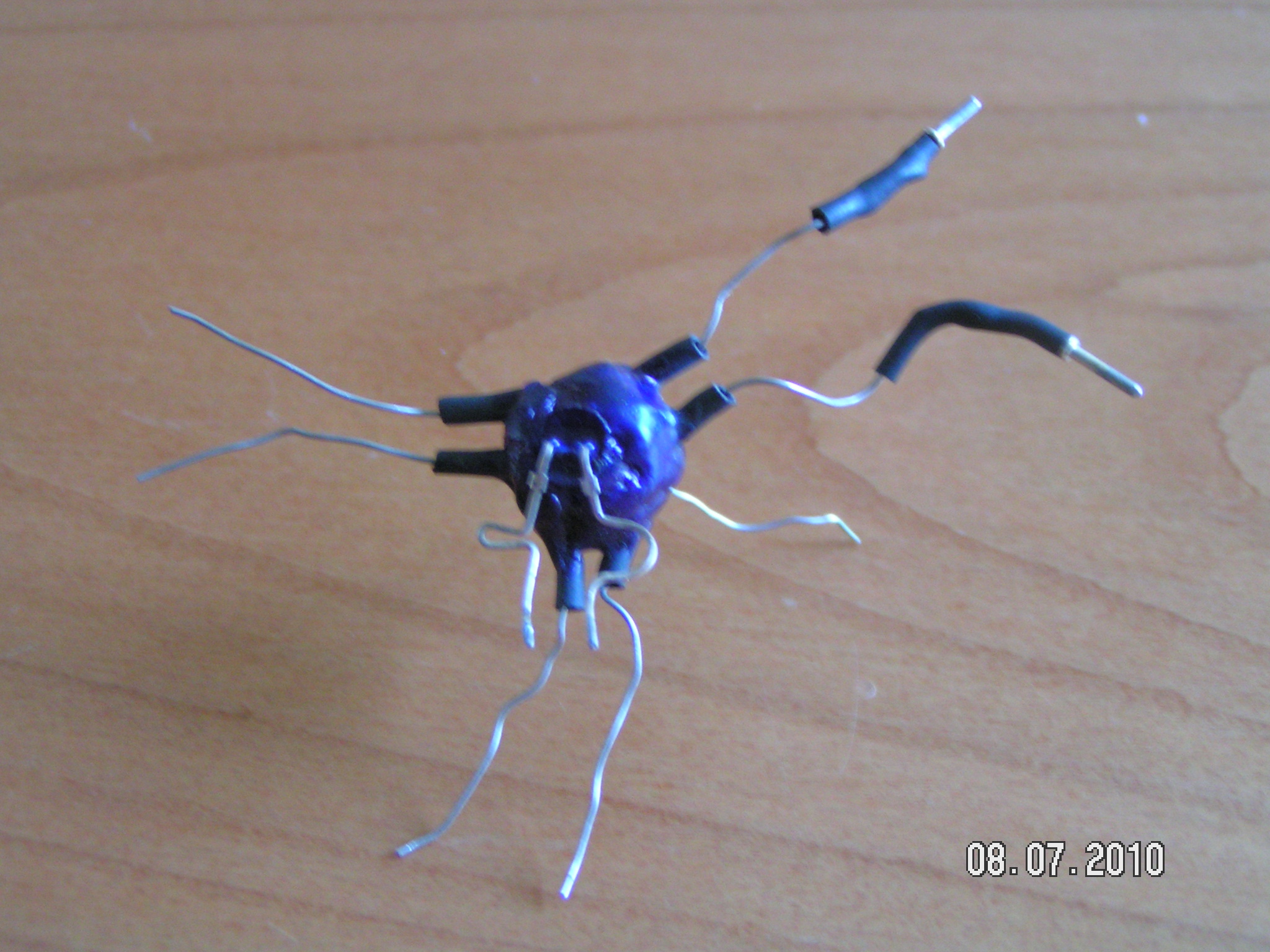

One LDR-multiple LEDs: works. One LED-multiple LDRs works as well. Here's one I built years ago for an abandoned project. Now waiting to be used for a quad voice "chorused" 40106 oscillator. Can you guess how I reminded myself what's the + lead? Embarassed
One LED with multiple LDR's trick: Put the LDRs in series for higher resistance, put them in parallel for lower resistance.

Remark: That quad-LDR vactrol was glued together with several layers of hotglue. The hotglue diffuses the light, so evens out the response, as not all LDRs have even contact to the LED.
Each hotglue layer was blackened with a marker,still some light gets through (also throuh the base of the LED that is not covered). The effect is slight enough to be ignored in dim lighting giving just a tiny humanising wobble. It can be used as a feature with bright lighting.
