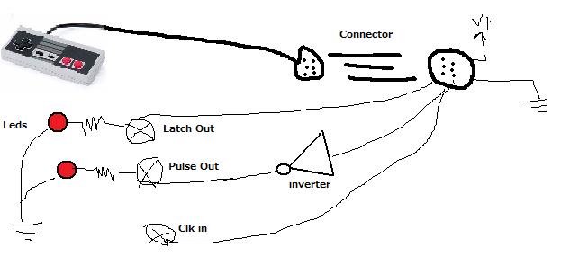

and after some thought, this is how i plan to attempt to use the nes controller with my lunetta:
According to my research, the NES sends a rather high clock signal to the chip and with each pulse the status of each button is sent back to the nes in a specific order as a data string of high/low/1/0's. (Which i predict will act similar to a 4017 with all the outputs tied via switches.) Whether or not the rate of pulses returned are related to the speed of the clock input (i.e. a division of) is yet to be determined, but i bet it's probable.
I would wire it up like i doodled up in the graphic. The latch output would spit 1 "longer" pulse with each clock pulse in. The Pulse out would send a string of high/lows such as 10110111 or 00110110...but because of how the nes works the data should be flipped with an inverter (if one prefers).
and finally a clock in jack should be wired up too.
I think thats how it would work easiest.
I'll have to think of it a bit more but if it were possible to have 1 out put per button, that would be slick. This i guess would involve how the nes interprets the returned serial data.

I havent done any physical toying yet (only got one nes controller, dont wanna blow it up) but it turns out the 'latch' jack shown above should be an INPUT not an output.
I guess for the proper function you'd send the latch a slower, divided clock speed and the clock-in a relatively higher speed, for example.
The latch pulse should trigger a 'button check' and return up to 7 data pulses for each button at the incoming clock rate through the pulse/data out jack.
