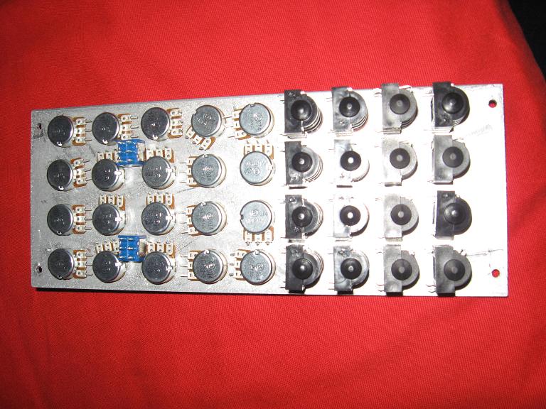

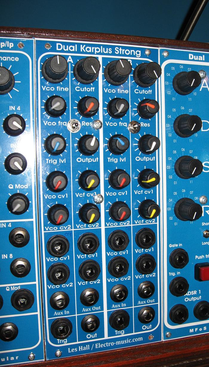

PostPosted: Sun Feb 13, 2011 5:14 am    Post subject: Reply with quote  Mark this post and the followings unread
Almost finished the Dual KS module i've been working on , Smile Smile
Need to tweak the vco cv tuning a bit , but it's working cool so far Smile .
I adjusted the sweep of the VCO & VCF by using a resistor on the + pot connections (MN3208 chip pcb 39K & 100K / MN3209 chip 37K & 120K).
I also decided to install the feedback send & receive sockets with the socket switching contacts allowing the feedback circuit when no jacks are plugged in , that caught me out during first switch on , heh Smile Smile .
heres some pics ....

I love this new build. I am blown away as usual. May I ask what jack types, and part numbers, your using?
Is there any reference on how you make your front panel art? I have been wanting to ask.
Keep up the fine work Dave, VERY impressed as always.

Looks great Dave, now I'm extra happy I sent you a second board. As you know, you can not only use the second board as a second voice, but you can use it as a resonator for the first board or for other stuff. The fact that you opened up the feedback path only adds to the possibilities. Well done, can't wait to hear some tunes.
Les

Dan ... Thank you , this was fun to build & fine tune Smile read all the pages of this thread if anyone is starting a fresh pcb , lots of handy info Smile.
Bill , Hey thanks Bill .... the jacks are pvc mono switching ones for all CV's & chrome switching ones for audio (same as the rest of the modular) all from Rapid uk electronics, front panel is a sticker , i designed the layout myself on Corel draw programme then took the panel files on a memory stik to my local sign makers shop ,
White printable adhesive vinyl with lazer printed blue ink design giving the impression of a white print ( white ink is available for his big Roland printer but is very expensive to buy in just for my prints)
so it is an inverted print with blue only outline leaving the clean white underneath. Smile Smile
i could have sprayed with a clear laquer but i have found the prints to be quite robust for home only use Smile Smile.

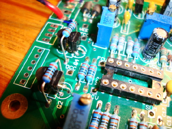

Hi all!
I am a touch confused about the expo "error" described in the thread, regarding pinout for the transistors.
Looking at the parts side of the PCB, with the power connectors at the top, are the transistor pins like this, starting from 9 O'Clock, top trannie far left pin going clockwise: EBCEBC ?

And by that, I mean was the schematic corrected per the mistake found a few pages back in this thread?

as far as i've understood it, they should look like in the picture (Q2 and Q4 turned around).
but i haven't seen an updated schematic yet

I tend to see components with all manner of different pinout...of the same type/number. I've seen 2N3904 with entirely different pinout than the ones I got from another store, so a physical representation is good but not "the" solution. I plan to try THAT 340 transistor arrays for a board's two sets of expo trannies. I guess that I have to conclude that the error noted a couple of pages back supercedes the schematic? I'll try that. Thanks, sorry.

oh, one note regarding the bjt mixup, it might be me (most likely), it might be a schematic error from the source (unlikely) or it might be an adjustment at the board house (possible but unlikely), but whatever it is you should know this: when you hook a bjt up backwards, what you get is, well, a bad bjt. In other words if you reverse emitter and collector but keep the base connected properly, you just get an out-of-spec, poorly operating bjt but IT WILL STILL WORK OK.
That's why i did testing to a rough degree and didn't really notice. It was good enough for me. But cooler heads prevail and our patient and methodical brethren (especially Kevin) got down to the real cause and stuff. I will get to this and update the schematic as soon as i can.
Les
p.s. in other words, just solder it best you can, it will work if not optimally.
