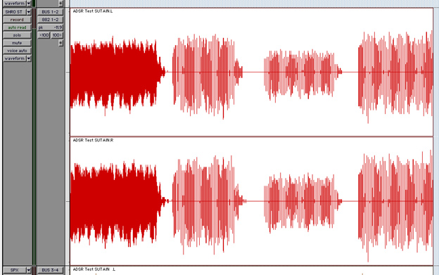

EG tested are always :
1- Roland M-140
2- Oakley ADSR
3- Oakley AD/AR
4- digisound 80-10
(CEM3310 based)
TEST 1
A, D & R = 0
Sustain = full
for sure a big clue is here...
On the M-140, it was like if Release is not at zero, or input gate was lengthened...
don't know why AD/AR is smaller in amplitude (maybe a diy mistake...) ; this is true for the three tests.
For sure waveform is a big clue :

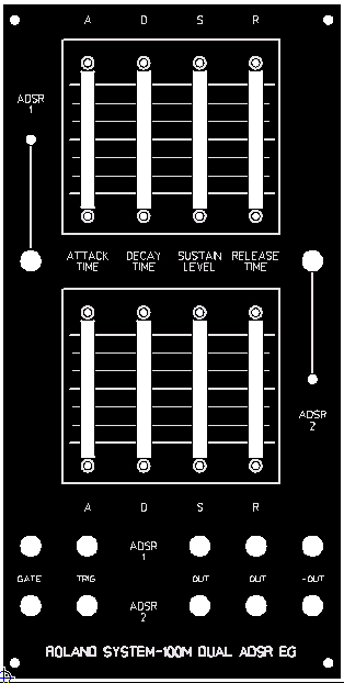

a M-140 dual clone.
The fact is that, using sliders for A, D, S and R, is way cool as you can "read" your adsr setting.
Slider knobs describe the contour of your envelope.
but schaeffer would be up to 50$...

frijitz wrote:
Myself, I would say that if I have A=D=R=0, I would expect to hear clicks, and that the Roland is not even working correctly!
i agree ; and i was about to think Roland has a bad design, so (maybe) it's charm…

I have build this ADSR on perfboard with all diodes and transistors substituted with modern ones (1N4148, BC547, BC557) and with +-15V PSU. Pots were substituted with 470k for A (500k will work too), 1M for D and R and S remains 100k. All pots are linear (B). Then I made it with two ranges - for the short one discharging capacitor is 1u and for the long one I'm adding to it in parallel one 4,7u and one 10u capacitors by means of switch. Executed like this it is the best ADSR I have heard - extremely fast (for the short setting), precise and with just right slopes -it is indeed snappy:)!

The replica of Roland System 100M ADSR I have build has definitely exponential slopes. It has even part of the A slope just before D, where it is almost Sustain like - one can call it Hold. This can be heard very well at slow setting. I believe the original behaves similar in this department - there is no reason not to. I have heard Pro One and I prefer Sys 100M ADSR (i mean the replica I have build - it is quite faster than the original with min A around 0,4 ms and min D around 1 ms). It is not slower than Pro One, but somehow rounder..
1234
Joined: Nov 14, 2010
Posts: 11
Location: Bulgaria
PostPosted: Fri Feb 11, 2011 7:55 am    Post subject: Reply with quote  Mark this post and the followings unread
And and the OPAmps are substituted by TL071 and TL072 varieties... Smile
