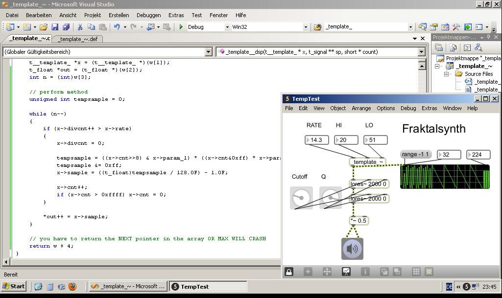

PostPosted: Wed Mar 16, 2011 4:37 pm    Post subject: Fraktalsynth for MaxMsp Reply with quote  Mark this post and the followings unread
cool stuff is going on here Smile
I'm working on a Fraktalsynth MaxMsp external.
It's working, same dirty sound as on PIC...
The NintendoDS Version is also available (if someone is interested mail me)

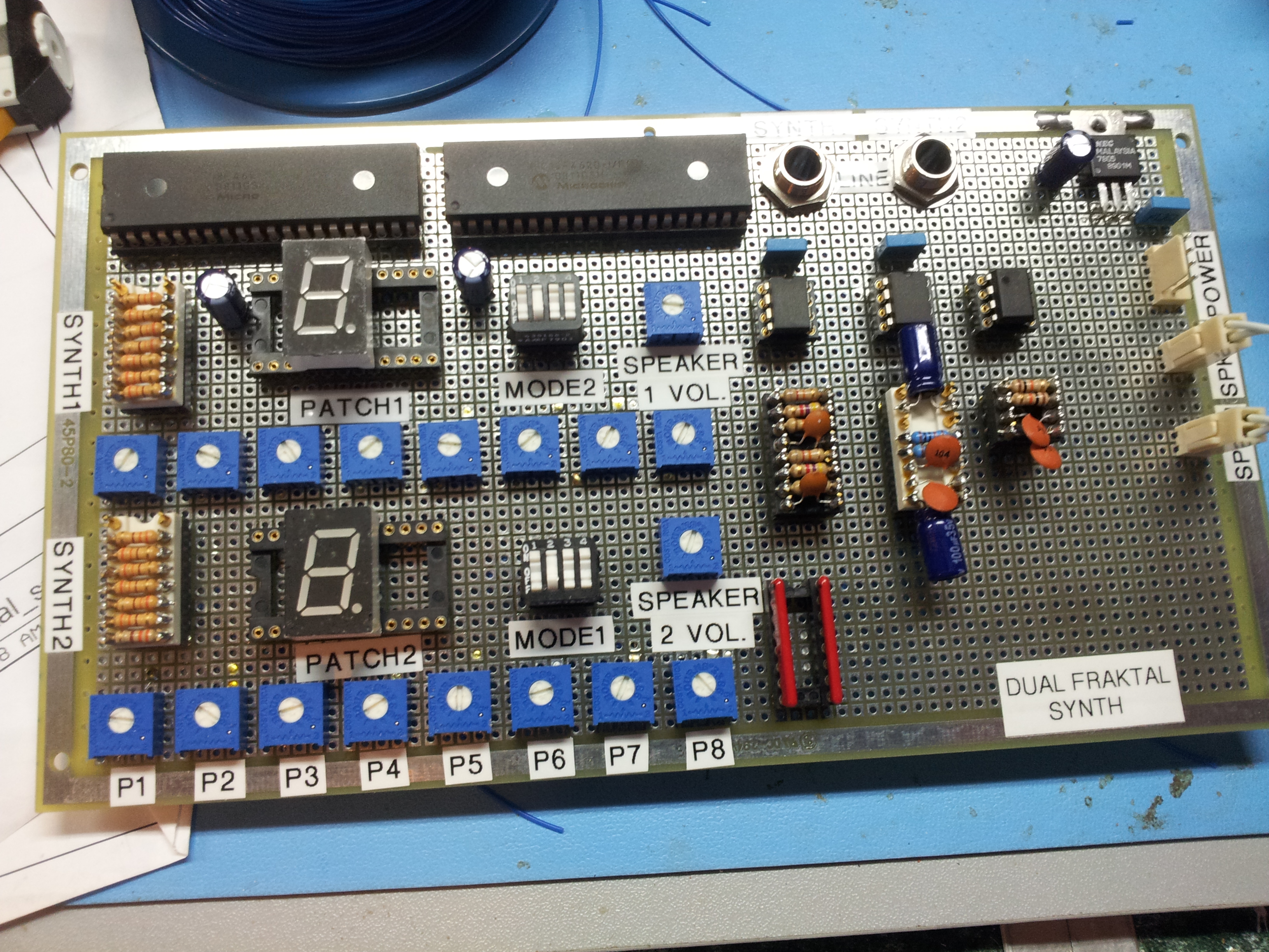

PostPosted: Sun Sep 02, 2012 7:26 am    Post subject: Reply with quote  Mark this post and the followings unread
Here are a couple pictures of a dual Fractal Synthesizer on a vector board. The is will used as part of a DIY setup at this years electro-music 2012 electronic music festival. It will be a collaboration entitled "The Soldering Musician and the Personal Digital Assistants". The board contains the original speaker amplifier for stand alone operation when connected to speakers and also has an LM358 based , capacitive coupled, LINE amplifier/buffer to connect to an audio mixer.
The original dual version was on solderless breadboard and did not have the LINE amplifier. It appears earlier in this thread.
I particularly enjoy using the WSG and FM sequencer patches on this synthesizer. It's a fun synthesizer to play around with ! Cool
Next the PT delay chips shall be added.
Its been a LONG while since I revisited this but still have to purchase the CCS compiler to add patches.
Bill
 Filesize:  3.41 MB
 Viewed:  3279 Time(s)
 Filesize:  3.48 MB
 Viewed:  3267 Time(s)

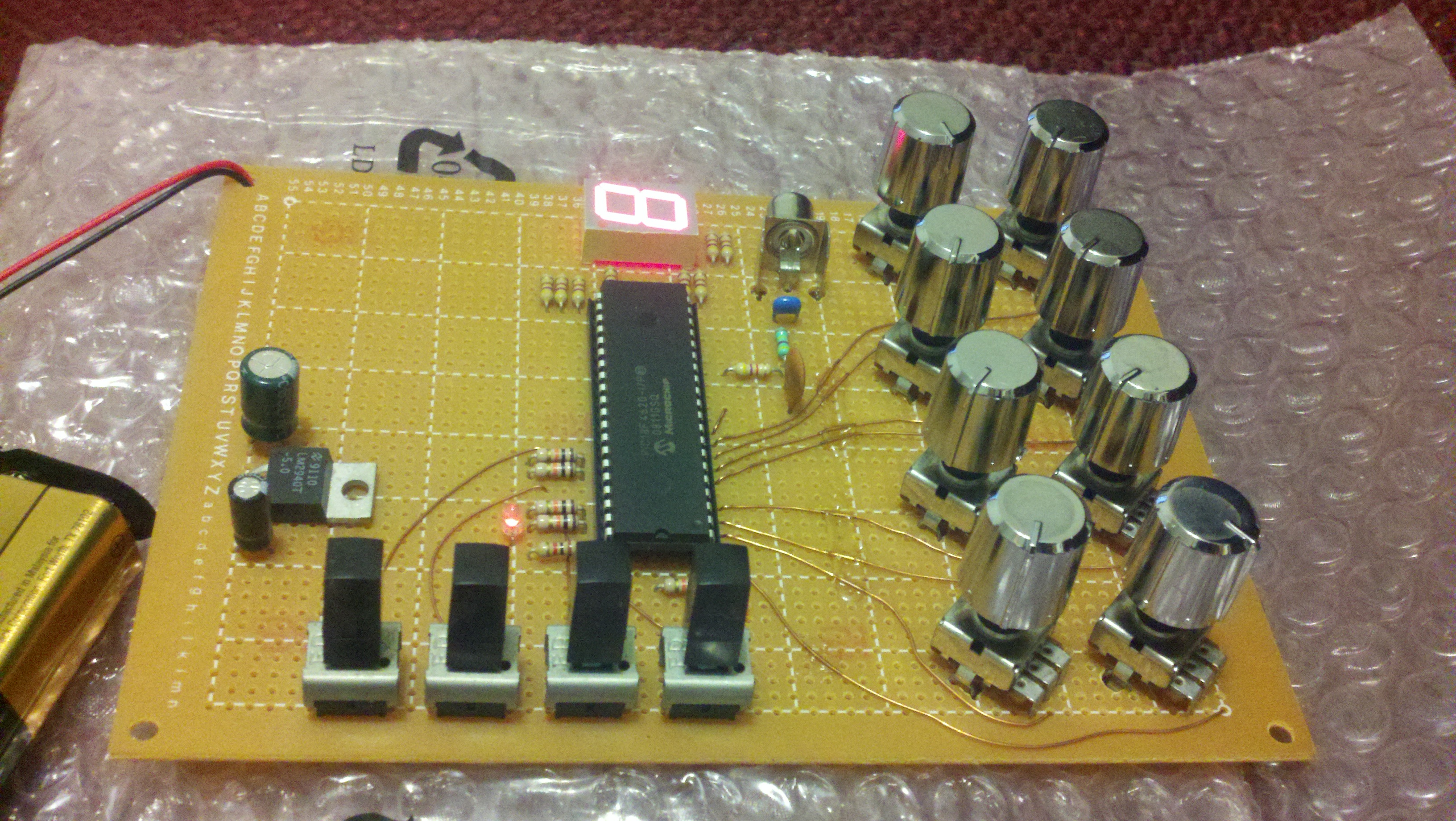

volare
Joined: Jul 31, 2006
Posts: 6
Location: Portland, OR USA
PostPosted: Fri Sep 07, 2012 3:06 pm    Post subject: Reply with quote  Mark this post and the followings unread
Here's a Picture of a fraktal synth I just breadboarded.The sounds are real cool.
 Filesize:  2.02 MB
 Viewed:  3253 Time(s)
Indeed ! Just very small amounts of input on the controls reveals some very unique changes in the sounds produced. You can experiment for hours ! Cool
I find that it's fun to play two of them and move each around in the stereo field.
