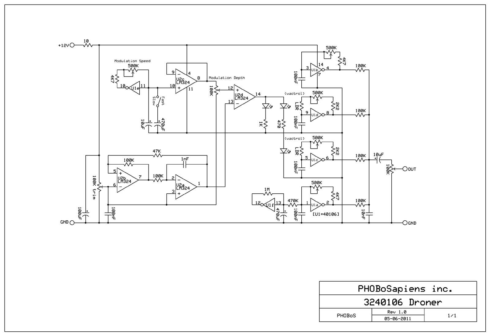

Ohm...
Recently egasimus asked how to make a common detune control for
multiple 40106 oscillators
. One obvious thing that came to mind was
using vactrols. Of course the oscillators won't detune exactly the same
which can be very useful for creating droney sounds.
My initial idea was to take a PWM controlled 10mm LED and place 6 LDR's
around them controlling 6 oscillators (40106). I did some experiments and
eventually ended up with using only 2 vactrol controlled (or is that vactrolled ?!)
oscillators.

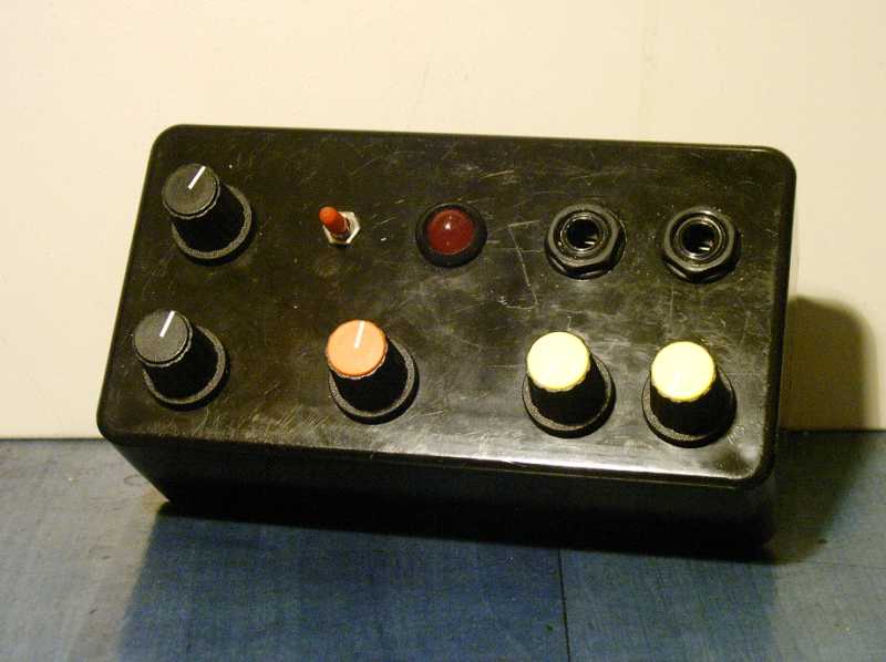

So here's the first circuit: "3240106 Droner"
- It has 2 oscillators to set a base drone one of which is slowly and slighty
modulated by a triangle wave provided by a third oscillator.
- Then there are the 2 vactrolled oscillators. The vactrols are driven by
a PWM controller which in turn is also modulated by a triangle wave.
Modulation depth and speed can be adjusted. The 100k trimpot is to set
the offset to get a nice vactrol responce. I made mine from a ordinary
5mm red LED, a LDR and a piece of heat-shrink tubing.
- The oscillators are passively mixed together using resistors and I added
a small cap to make the sound less harsh.
The enclosure is probably temporary as I'm planning to build a couple of
drone ciruits and put them together in a box with a mixer, delay, filter and
what else might be useful to create some nice drones (tips are welcome!)
I'm thinking of adding a cheap circuit bent keyboard aswell.
here's the schematic, a photo and some demos:

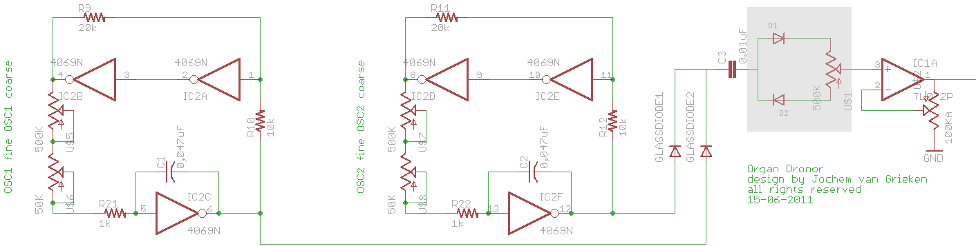

I've also been heavily focussed on Drones lately and they are just endless fun. Im working on the second version of my Organ Dronor and Im really learning a lot about filters and mixing. One of my favorites is to mix the oscillators together with diodes instead of resistors, really adds more flavour.
I don't have a finished schematic but I added a little taste of the dronor. Im using some very old diodes from a power supply wich tends to sustain the drone longer but any diode will do. The little added circuitry in grey changes the output from ramp to triangle to saw. You can also add diodes across the variable resistors on the oscillators with the same effect.
here are some of my drone explorations:
and a lot of recordings, some more succesfull then others:
the Organ Dronor by Tropical Benny
 Filesize:  15.45 KB
 Viewed:  1722 Time(s)

Just wanted to share my build of one of the Phobos droner design (thanks for the schematics !)
I took the 3240106 Droner and added the filter section of the Casper Electronics Drone Labs (low pass into distortion into 2x resonant band pass filters, with audio input)
Nice textures are going out of this thing !
Here a sound example, with just a delay added, feedbacking into the audio input: https://soundcloud.com/user-624222268/otoro-drone-02
And a pic of the thing (etching of the panel in process)
So, thanks again Phobos, and Casper, for the inspiration, much apreciated Smile
 Filesize:  336.46 KB
 Viewed:  749 Time(s)
Posts: 5883
PostPosted: Sat Aug 19, 2017 3:18 am    Post subject: Reply with quote  Mark this post and the followings unread
welcome party!
Looks great! and sounds good too, pretty agressive I guess the distortion might be responsible for that.
It brings me a lot of joy to see that the circuit is useful to you and nice to see it combined with some circuitry by
Casper Electronics, who has made some awesome things (the Drone lab being one of them). I hope you'll have a
lot of fun with it. Very Happy

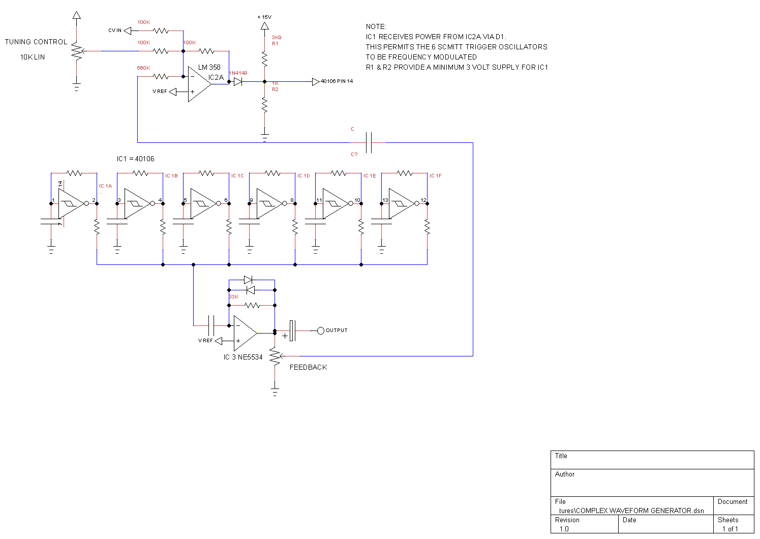

PHOBoS It is possible to modulate all six of the 40106 oscillators by modulating the power supply to the chip, the only problem is that this also varies the amplitude, although it is possible to correct that if desired.
The frequency of the oscillations is inversely proportional to supply voltage, that is increasing voltage causes decreasing frequency and vice versa.
Posts: 5883
PostPosted: Sat Dec 16, 2017 11:11 am    Post subject: Reply with quote  Mark this post and the followings unread
I haven't tested it, but yes that should work. They probably won't stay in tune though if you change the voltage
(in relation to each other that is). However, if you're planning to built the XOR Stereo Droner and you only
adjust the supply voltage for the 40106 gates their outputs might not be high enough to trigger the XORs
but it shouldn't be a problem to just lower the total supply voltage. hmm, U1b probably won't be very happy either
if it gets a higher voltage on the input coming from U2d. The 3240106 Droner has the output of the opamp optically
isolated from the 40106 gates so that one should work fine with adjusting only the supply for those gates. Power
starving might give interesting results too but it will definitely reduce the output level.

I made a complex waveform generator using a 40106 as six oscillators combined in an inverting mixer with diode clipping that in addition to producing complex intermodulation products ( creating a sound almost like noise ) ensured a more or less constant output amplitude even though the 40106 was fed a wide range of supply voltage ( in order to provide overall tuning ) by the opamp mixer. The inverting characteristic of the mixer corrects the inverse frequency voltage characteristic of the 40106.
 Filesize:  87.06 KB
 Viewed:  29477 Time(s)

PostPosted: Sat Dec 16, 2017 11:53 am    Post subject: Reply with quote  Mark this post and the followings unread
looks really nice, but the picture is just too small to be able to read (at least for my eyes Smile )
I'll try to find the original.

gasboss775

PostPosted: Sat Dec 16, 2017 12:01 pm    Post subject: Reply with quote  Mark this post and the followings unread
Here is the general idea and another method of normalising the output amplitude :

Schläfer
Joined: Aug 17, 2017
Posts: 18
Location: Berlin
PostPosted: Sat Dec 16, 2017 12:41 pm    Post subject: Reply with quote  Mark this post and the followings unread
Thanks, way better !
Posts: 5883
PostPosted: Sat Dec 16, 2017 1:25 pm    Post subject: Reply with quote  Mark this post and the followings unread
I thought about using a comparator myself as a transistor inverts but for audiofrequencies that doesn't matter much of course.
