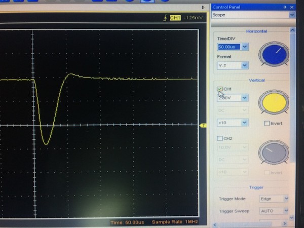

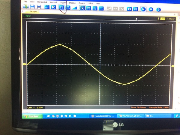

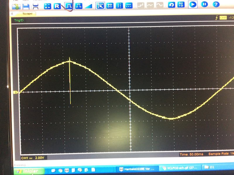

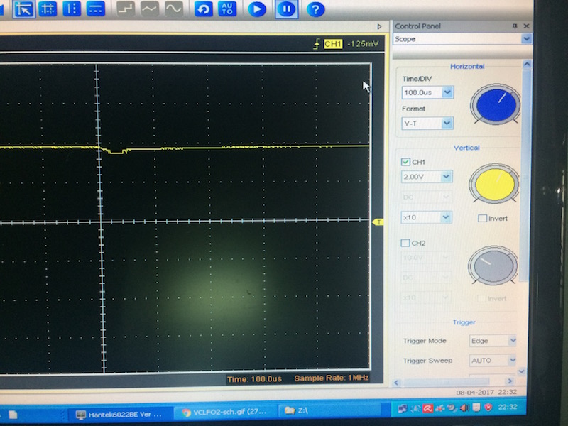

PostPosted: Sat Apr 08, 2017 6:57 pm    Post subject: changed C5 Reply with quote  Mark this post and the followings unread
Changed the C5 from 47pf with other values 470pf and 1K.
47pf C5
 Filesize:  158.32 KB
 Viewed:  409 Time(s)
47pf C5 zoomed to 50us
 Filesize:  122.59 KB
 Viewed:  417 Time(s)
1k C5
 Filesize:  153.44 KB
 Viewed:  369 Time(s)
1k C5 zoomed to 50us
 Filesize:  138.84 KB
 Viewed:  390 Time(s)
