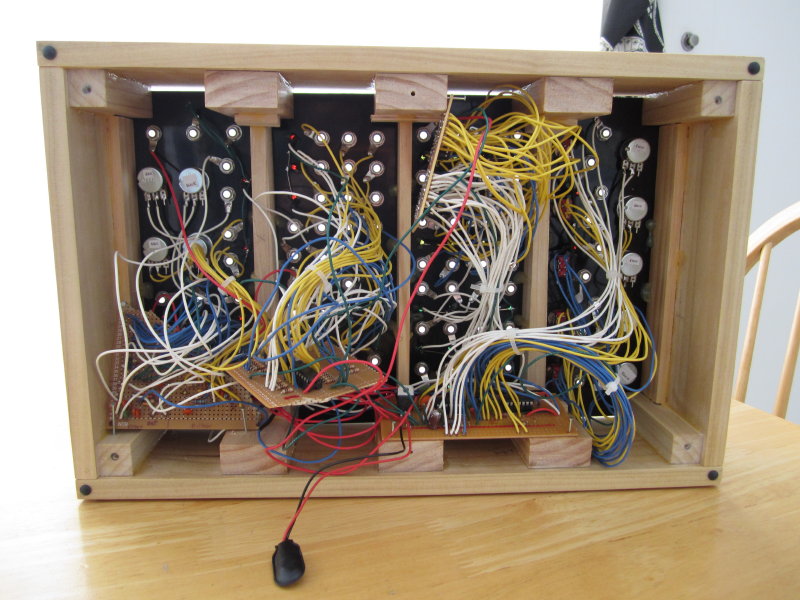

This is the sound making thing I made using the random assortment of CMOS chips from Electronic Goldmine. As you know, the IC assortment included 25 CMOS chips. I selected 6 of them and built the below.
In addition to a photo, I wanted to include my notes so that anyone just starting out could easily build these circuits (and modify or improve them!).
The chips I used are:
MC14069UBCP Hex Inverter (x2)
MC14040BCP 12-Bit Binary Counter (x1)
CD4020BE CMOS 14-Stage Ripple-Carry Binary Counter/Divider (x1)
CD4019BE CMOS Quad AND/OR Select Gate (x2)

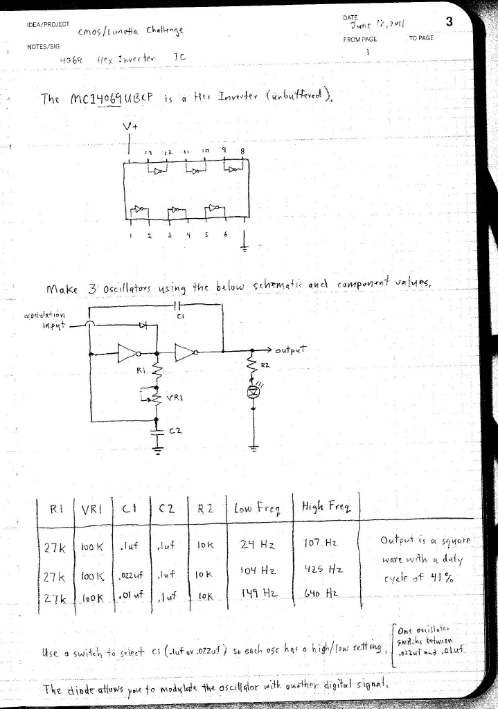

The 1st panel includes 5 oscillators (1 high, 2 mid, 2 low) using the 4069 ICs.

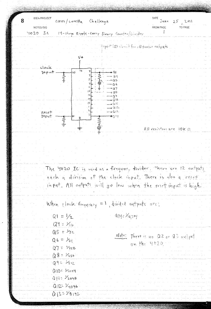

The 2nd panel includes 2 frequency dividers using the 4040 and 4020 ICs.
The 3rd panel includes a bunch of logic gates using 2 4019 ICs. Also, there is a 3 input resistor mixer and 3 input diode mixer.

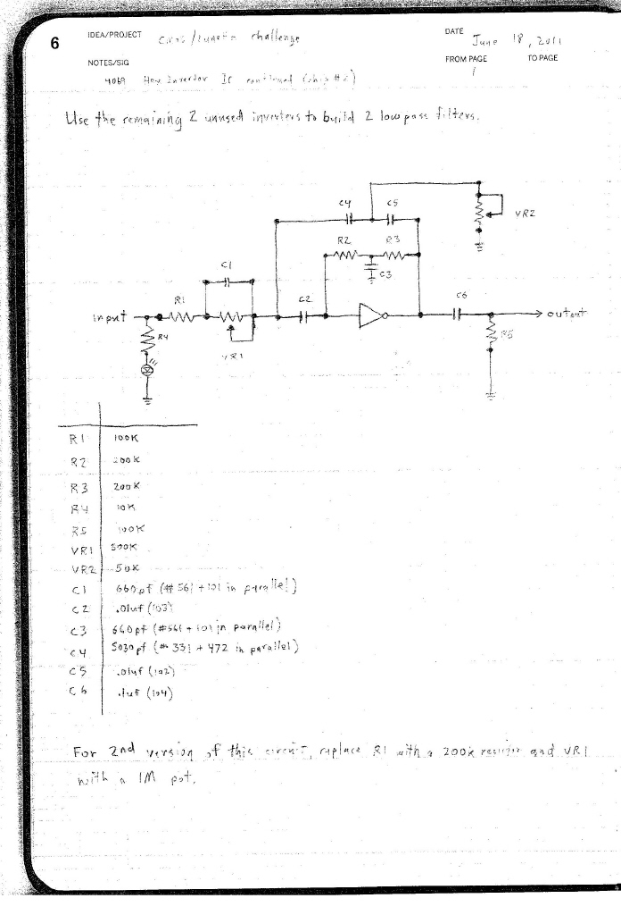

The 4th panel includes 2 filters using 2 inverter gates from the 4069 IC in panel one. There is also a passive mixer with volume control and an output jack.
This was a really fun project to work on and I'm going to continue with my remaining chips (I've already started building the 2nd case). I'm also looking forward to seeing what other people are building with their assortments (a few of the chips have me stumped, and I need ideas!).

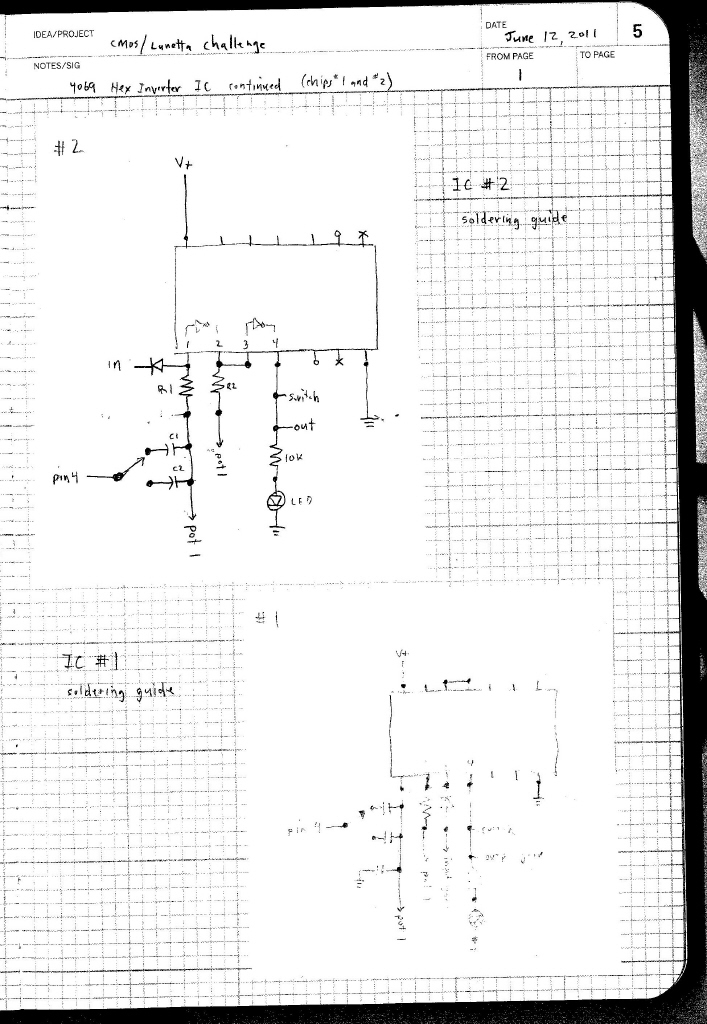

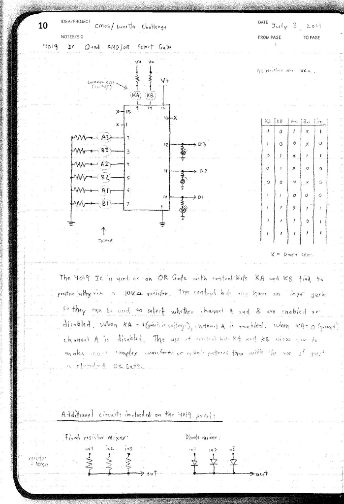

Here are my notes for the circuits (pages 1 to 5)

more notes (pages 6 to 10)

hey, thats really nice! i can see a lot of work has gone into this, very well done Smile
tjookum
Joined: May 25, 2010
Posts: 360
Audio files: 26
PostPosted: Thu Jul 07, 2011 1:24 am    Post subject: Reply with quote  Mark this post and the followings unread
Thanks for sharing, it's great to see the entire process and not just the end product(wich looks amazing).
one question though...what does it sound like?

also, how does the 4020 compare operation wise to the 4040?

The 4020 and 4040 are very similar. The 4020 has 14 stages while the 4040 has only 12. The 4020 does not have a divide by 2 or a divide by 4 stage, but it does go lower (all the way down to divide by 8192).
I just shot a quick video today in an attempt to demonstrate the filter. The sound is very low on this video so keep an eye on the oscilloscope to see how the filter changes the square wave as I adjust the 2 pots.
The pot on the left is VR1 in the above schematic and controls how much input enters the filters inverter. The pot on the right is VR2 which controls the resistance to ground.

Could you give me the way you have calculated the osc frequency ??
Thanks !!

I see you are using CMOS in linear mode for the filters. Do you happen to know what the current draw is for the whole circuit? I always thought they would draw to much current to use in battery powered devices.

I didn't have to calculate the oscillator frequency because the DSO Nano has a frequency display.
I don't know how much current the filter draws as that is not something I measured. I'm using a single 9 volt battery for power (with a 7805 voltage regulator).
The filter was actually the most fun part to build. Using the scope was very helpful in seeing how replacing various components effected the filters response. I'm sure the filter can be improved upon. I'd like to build a version that can be modulated by other sources as opposed to just using the 2 pots.

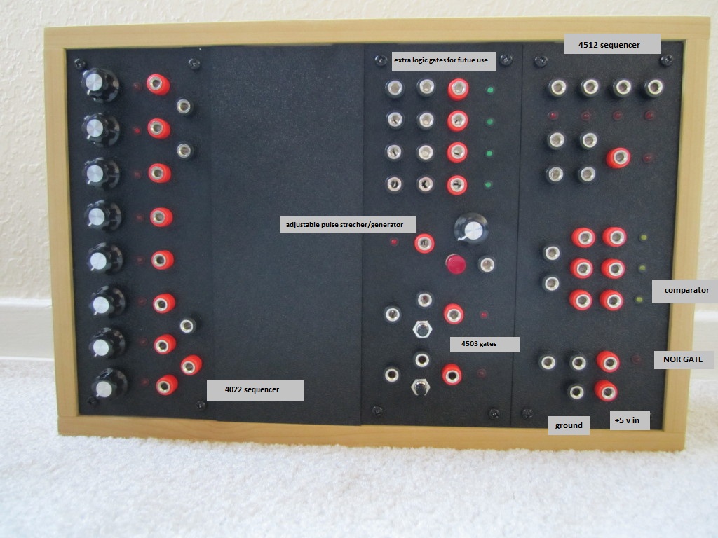

I just finished using the chips from my grab bag (actually, I used at least one of each type in my bag, there were a number of duplicates). Anyhow, here are 2 photos of the thing below. I'm also going to scan my notes so you can see how I made the circuits. I'll post a video once I get my order of banana plugs. I need to make some longer patching cords now that I have 2 units.

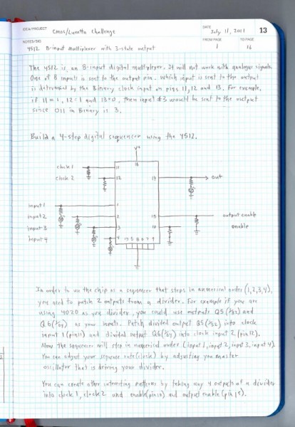

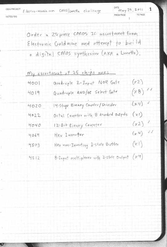

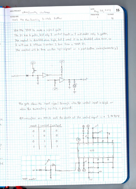

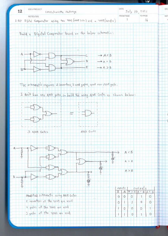

And here are my final five pages of notes describing each circuit. I've got a color scanner at my new job!

well done Im very impressed, you really took on the challenge and made it into a succes.
And thanks so much for sharing your findings, I don't have the time right now but I'll definately look into them later.
and where did you get that sketchbook? It looks like an excellent tool for putting down ideas.
