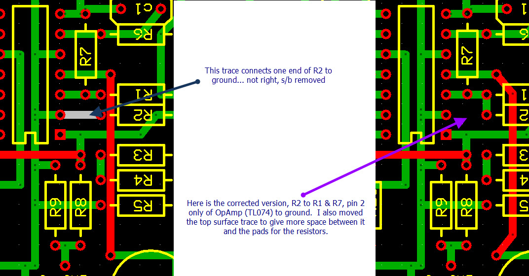

Here's a PCB for the lfo, i havent built it, but have checked against the schematic and its correct.
its in EXPRESSPCB format
best to have the schematic to hand while you build it as i havent drawn up build docs (too lazy)
Edit : R2 to GND problem fixed and layers sorted out, thanks marvkaye

PostPosted: Tue Aug 16, 2011 4:15 pm    Post subject: Reply with quote  Mark this post and the followings unread
Hi bubzy... thanks for posting that PCB layout... very cool indeed. (I need to learn how to do that... Confused ) I have one simple question, though.... are the trace layers reversed?? The ExpressPCB specs say that red traces are the top layer and green ones are the bottom. I'm sure that swapping them is no big deal, I just want to make sure I'm not missing something that should be obvious. I also found that with a little judicious tweaking I can fit two of your layouts on one of their Mini-board blanks, makes them very reasonably priced....
Your thoughts??
<marv>

PostPosted: Tue Aug 16, 2011 4:37 pm    Post subject: Reply with quote  Mark this post and the followings unread
i have actually put the green traces in as jumpers. but yeah you're probably right about the layers being the wrong way around. id wait until someone (or me) has actually built one of these before spending money though.. there can always be problems that aren't obvious until you build something Very Happy ill probably get on it this week.

PostPosted: Tue Aug 16, 2011 5:45 pm    Post subject: Reply with quote  Mark this post and the followings unread
Good idea... I'll await a progress report before going further. BTW, swapping the traces was a snap. Nice piece of software.

PostPosted: Mon Aug 22, 2011 4:45 am    Post subject: Reply with quote  Mark this post and the followings unread
Hey bubzy, just curious if you had a chance to do anything with this PCB?? I started work on my stripboard for it but got distracted with other chores... I'd really prefer the PCB version, though, so my motivation to complete the stripboard was probably reduced considerably. I'm really looking forward to your update.

I'm sorry to hear that, I didn't know they didn't have a Mac version. All things considered, though, since bubzy apparently didn't have time to do his PCB over the weekend I thought I'd give it a once-over to see if I could find any errors. I was surprised to catch one right out of the gate... see the attached picture.
I'm going to continue checking and will post additional corrections as they appear. Hopefully there won't be many more and I can put up a copy that matches Tim's schematic faithfully. Just remember, this is bubzy's PCB layout, I'm just being a second pair of eyes. When it's all proofed and if he doesn't mind, I'll be happy to post a PDF version for you.
Detail of fix for R2 to ground problem... shows move of top-surface trace as well to give more space between it and R1-R5 resistor pads.

I didn't find any other errors. Disclaimer... I am complete noob at checking PCBs (although I have done several successful stripboard layouts), so please check closely to insure I haven't missed anything. Bubzy did some fine work and deserves all the credit for this layout.
The picture shown is a screen cap of the actual ExpressPCB layout on one of their mini-boards (2.5" x 3.8"). I'll U/L the actual file later. Green traces are bottom, red traces and yellow silkscreen are top.

PostPosted: Mon Aug 22, 2011 11:15 pm    Post subject:   Reply with quote  Mark this post and the followings unread
marvkaye : nice work. how the heck did i miss that (considering that i follow the schematic with a highlighter pen....... :S)? original now changed. please post the expresspcb files up, dual board is a nice idea too.
new pdfs uploaded (instead of the wrong zip file last time. sorry)
