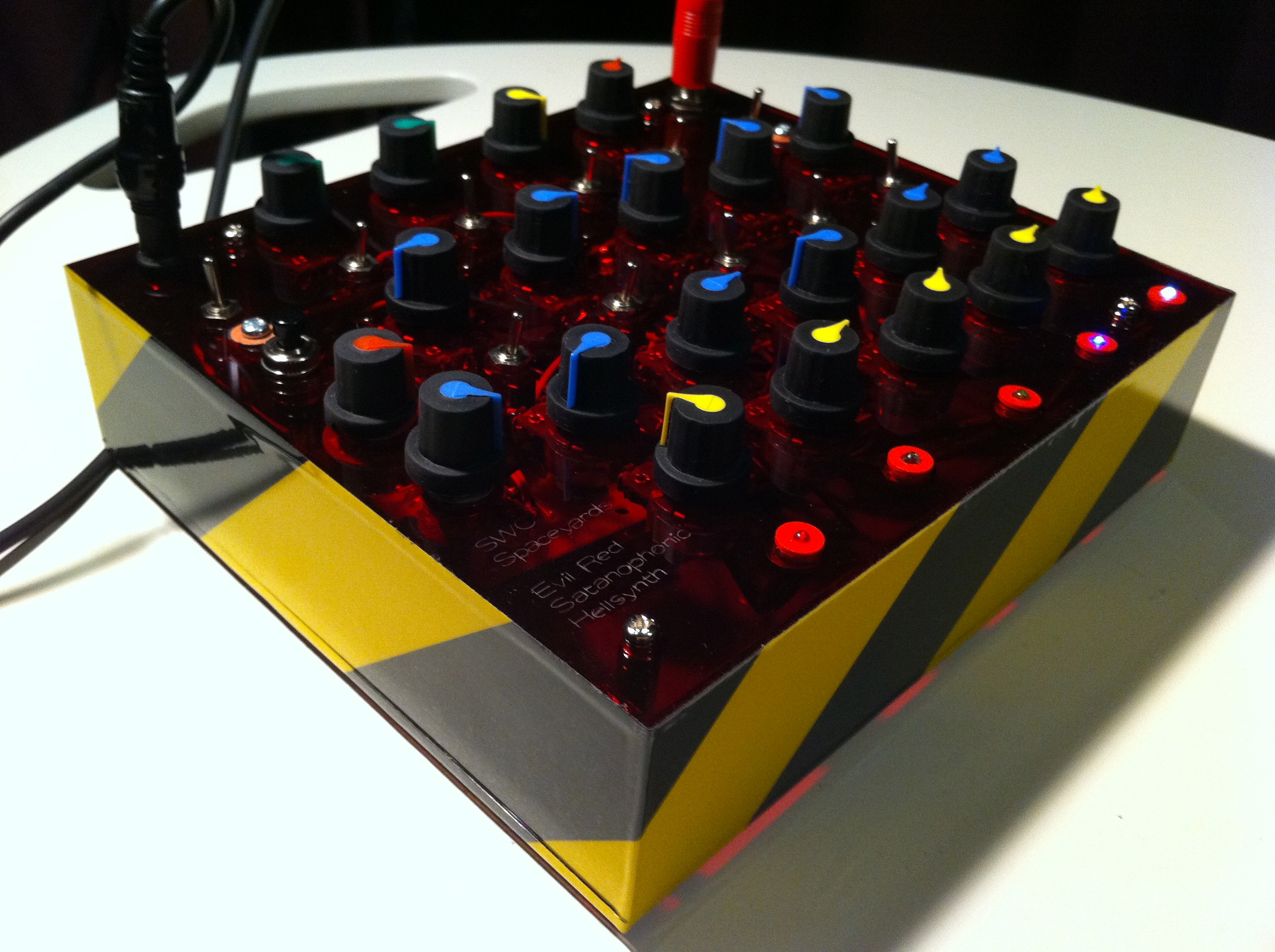

Here's the latest machine out of SWC Spaceyards... hehe..
 Filesize:  1.42 MB
 Viewed:  815 Time(s)
 Filesize:  1.66 MB
 Viewed:  762 Time(s)
Posts: 5883
PostPosted: Tue Mar 29, 2011 4:47 am    Post subject: Reply with quote  Mark this post and the followings unread
wow! that looks great!

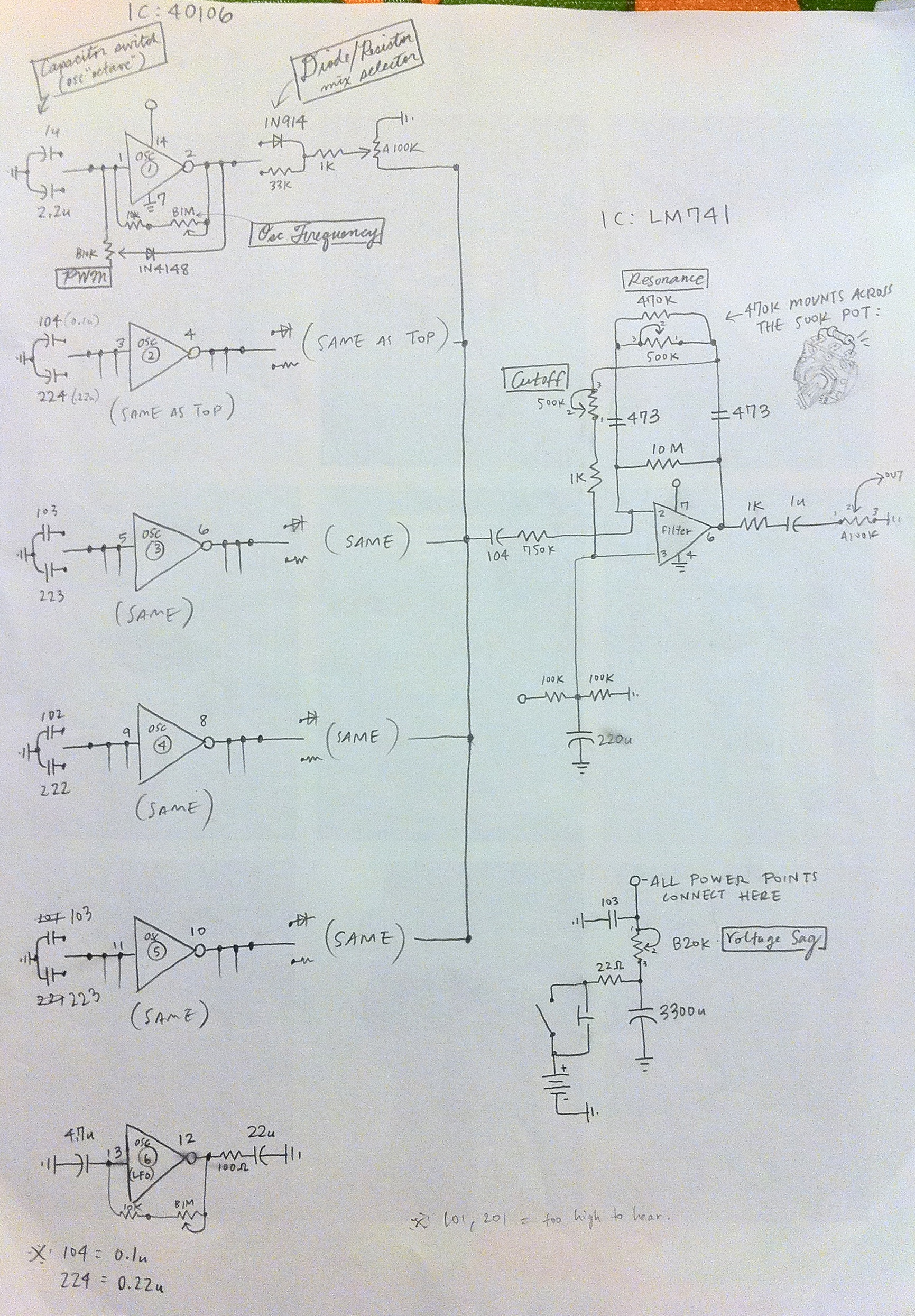

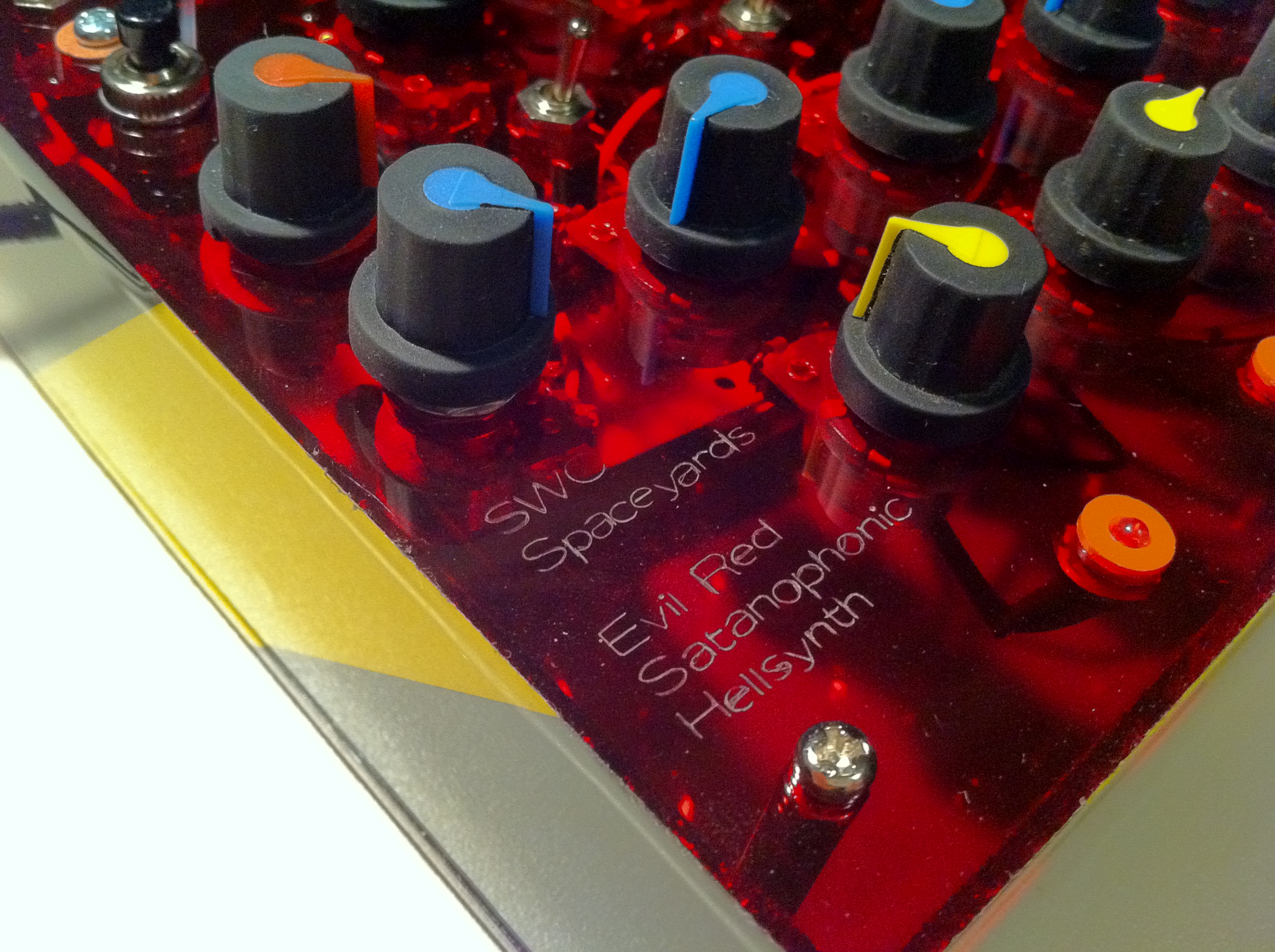

PostPosted: Sun Apr 10, 2011 2:59 am    Post subject: Yet another one... Reply with quote  Mark this post and the followings unread
The latest creation...
I've changed a few things: one cutoff pot instead of two (a mod of the WSG filter circuit), played with different capacitor values for the oscillators, and also experimented with a different way of soldering in which I stuck the diodes and resistors straight to the pots, but differently than I had before (it worked and is cleaner).
These things are addictive!!

Nice device!
Looking at the schematic you posted i wonder about the osc 6 (lfo), it seems to be "grounded at both ends" what does it do ? What is ic connected to ?
Stay Cool
Mikael
http://www.mikmo.dk
TheOutsider
Joined: Mar 10, 2011
Posts: 13
Location: Osaka
PostPosted: Wed Apr 13, 2011 5:02 pm    Post subject: Reply with quote  Mark this post and the followings unread
Mikmo,
It is indeed grounded at both ends. I don't know where I read it (possibly somewhere on this thread even) but this kind of 'LFO' works not by directly modifying the output of the oscillators, but by interfering with the way the other oscillators get power, since all of the oscillators are part of the same IC. If you watch the video I linked to, you can see and hear how the LFO wreaks havoc on the other oscillators, especially when the voltage is sagged. Actually, depending on the settings of the voltage sag knob and the LFO, something very unusual happens. When the sag is dropped to half or lower, and the LFO is set fully clockwise, the unit(s) produce almost white noise, which the red unit is doing at the very beginning of the video (sag=1/2, LFO=max). Later on, the LFO is dropped to about 1/2 (at around 1:45 in the video) which makes the oscillators cycle on and off. This cycling only happens when BOTH the voltage sag AND the LFO are dropped to about 1/2: if the sag is set fully clockwise, changing the LFO speed doesn't produce cycling, but works almost like a conventional LFO (although it is kind of subtle).
Sorry I can't offer a technical explanation... I'm not an expert on circuits by any means. All I can tell you is I like what it does. Hehehe..

TheOutsider wrote:
Mikmo,
Sounds kinda like the Cacophonator. Extra oscillators mess with the current draw, but don't get hooked up as sound sources. Cool idea.

Repeater,
Yes indeed I think it may have been the Cacophonator that I 'borrowed' the LFO idea from. I must've looked at about 100 different pages on the Internet and the same amount of schematics before I mashed together my mixed up mess of a circuit. Love these things though! 2 more in the works right now.

PostPosted: Thu Apr 14, 2011 5:14 am    Post subject: Reply with quote  Mark this post and the followings unread
Thanks.
technical explanation or not it makes totally sense Very Happy

I've got a question... Need some explanations !
On The outsider schematic, we can see that the pwm oscillation is built around a 4148 diode. Could someone explain me why we need this diode ? in an electronically way ? It's a bit of theory that i don't get yet.
Thanks for any answer !
Smile
http://h.a.k.free.fr/
www.electroncanon.org
Kabzoer
Joined: Feb 07, 2011
Posts: 82
Location: Belgium
PostPosted: Tue Nov 15, 2011 9:35 am    Post subject: Reply with quote  Mark this post and the followings unread
the feedback resistor determines how fast the capacitor charges,
a diode+resistor in parallel (pointing towards the capacitor) makes it charge faster in the on state,
but when it's in the off state, it will discharge at normal speed, as if the resistor+diode are not there.
The opposite will happen when it points towards the output.
This change in speed in either the off or on state will make that state shorter = pulse width
Hope I'm right on this, but that's how i assume it works...

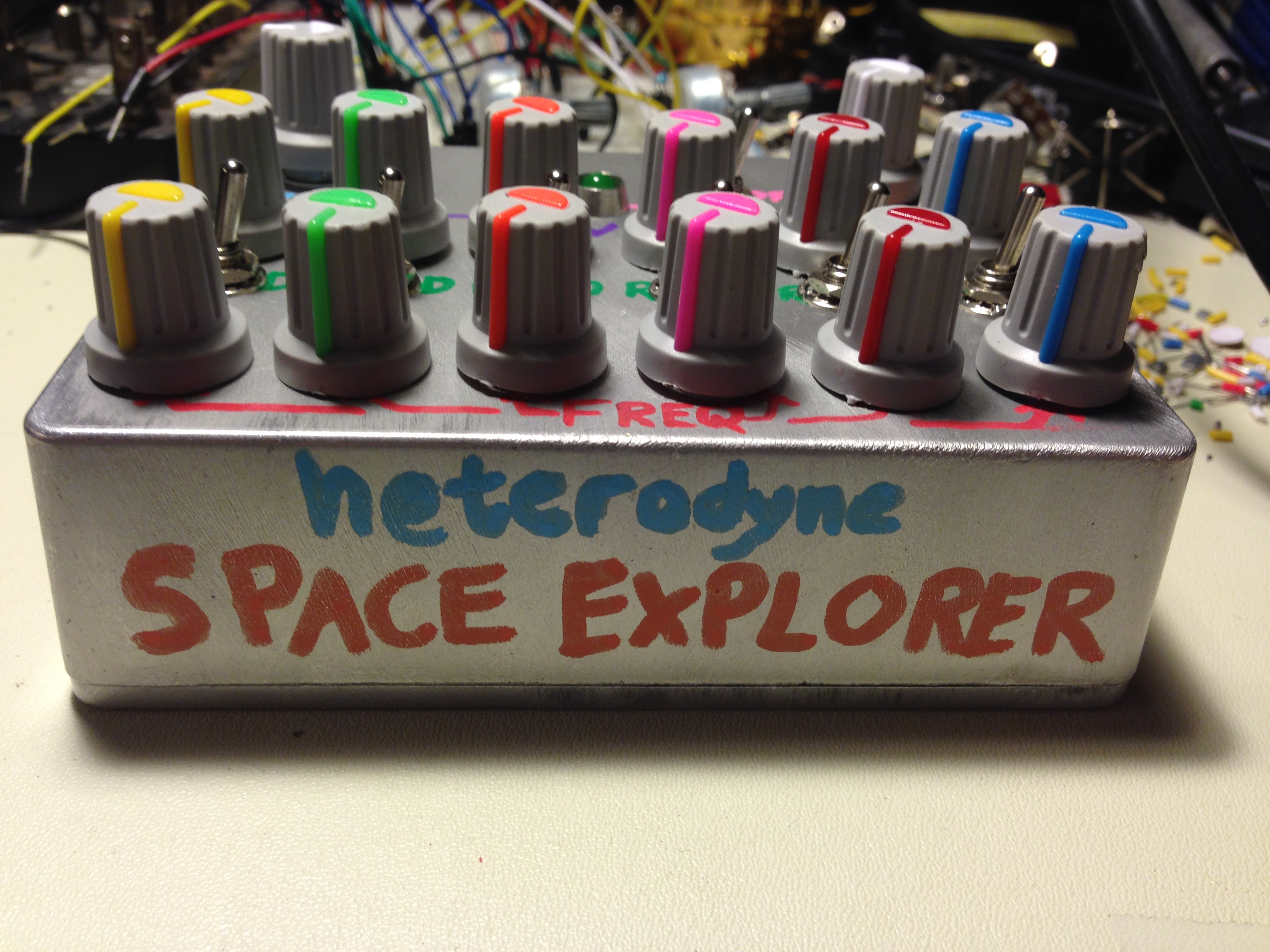

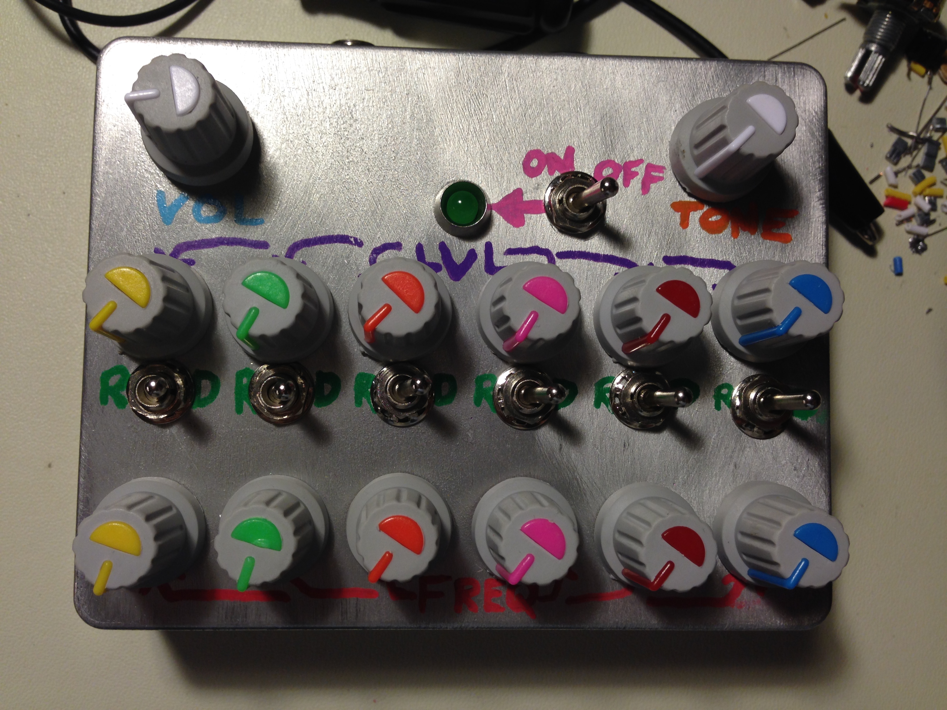

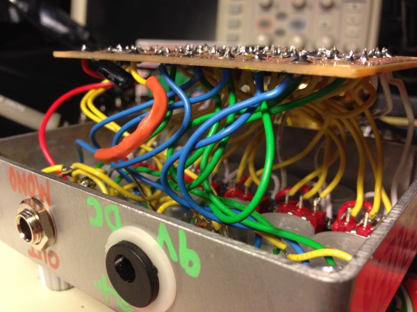

PostPosted: Mon Dec 15, 2014 10:31 am    Post subject: Reply with quote  Mark this post and the followings unread
here's mine i made quickly. nice and easy circuit.
i ended up using all six inverters. 3 pairs of different ranges (caps).
i used an SN74HC14, which i messed up and didn't know its meant for 2-6V, but its working OK on 9V....for now... Embarassed
