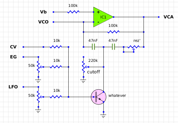

just to clarify your arrangement could you post a circuit diagram please? I may have it right though: The transistor is conected as the diode is, but your CV goes to the base (through a 100k resistor?) and the initial/main frequency control pot is connected as normal?

PostPosted: Sun Dec 25, 2011 7:25 am    Post subject: Reply with quote  Mark this post and the followings unread
You're right. Here's a nice drawing of it with happy colors to make it even clearer. It's still a work in progress, so values may (will) change. I'm not sure if the resistors between CV pots and transistor base are required. I'll have to try without. Perhaps a small value resistor (470R ?) at the transistor's emitter is to be added. Now the pots behave in a *very* log manner, I'll have to handle it too. And screeching noises are heard with rez' at max and cutoff in the treble. A tiny cap across the op-amp might help, like in the Morley schemo above…

PostPosted: Sun Dec 25, 2011 3:31 pm    Post subject: Reply with quote  Mark this post and the followings unread
hah, whatever transistors, the newest brand of high fidelity medium power whatever-polar junction transevers! Laughing
I would strongly advise 100k resistors on all things going into the caps and transistor, acctually the transistor may require lower resistance but I would put that main frequency pot through a 100k resistor just to be safe.
Thanks very much for the schematic, everything is becoming clear now Smile

umschmitt
Joined: Jun 29, 2011
Posts: 189
Location: brrlin
PostPosted: Mon Dec 26, 2011 10:05 am    Post subject: Reply with quote  Mark this post and the followings unread
CORRECTION ! I'm so chaotic that I hadn't noticed that this arrangement works better than with a pot to ground ! Still need to set proper values… Anyway this transistor trick is great.

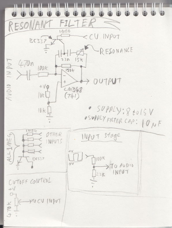

PostPosted: Sat Feb 18, 2012 6:37 am    Post subject: Reply with quote  Mark this post and the followings unread
This circuit is so versatile Shocked
I've been experimenting with it alot today, I really figured out alot of things ... but it's hard to word them right.
The transistor/capacitor combination filters the signal, yes, but it also allows much of the high frequency oscillations to be bypassed to ground, so they do not feed back into the op amp and are subsequently not attenuated, this gives you the resonance (see my thread on the resonator for a device which just adds resonance and no filtering). When the resonance potentiometer resistance is high, it is almost as though there is no connection between the capacitor on the output side and the output, so you end up with alot of unusual, frequency independant resonance, also changing other components will affect the resonance.
All components are changeable!
Both caps determine the resonance and filtering of the signal however the capacitor on the input side of the feedback path (the left hand side one in my diagram) has more to do with the resonance frequency and amount of resonance. I haven't played with it but I invite you to try some different values!
Attached is a diagram of the circuit I was using today. keep the input low, about 1 or 2 volts, for best results. If it gets too close to the op amp's limits it doesn't work very well. Also using a better op amp like an LM324 or something really special like a TLV072 would make this work alot better. I just happened to have an LM348 to hand (four 741's) so I used that.
Remamber, all components are changeable and thats what makes this circuit so good, but you may get better results with other values or other types of op amps or transistors.
I feel I should mention that I had some problems with slight irregularities on my input signal, I say problems, but that should be "features" Wink Any distortion on your input signal can have a great effect, adding a power supply filter capacitor helped keep my input signal clean.
Last but not least;
Thankyou Umschmitt and richardc64 Very Happy
 Filesize:  303.19 KB
 Viewed:  618 Time(s)

i also play with this filter and i like it!
i think this is also intersting to mod this filter
