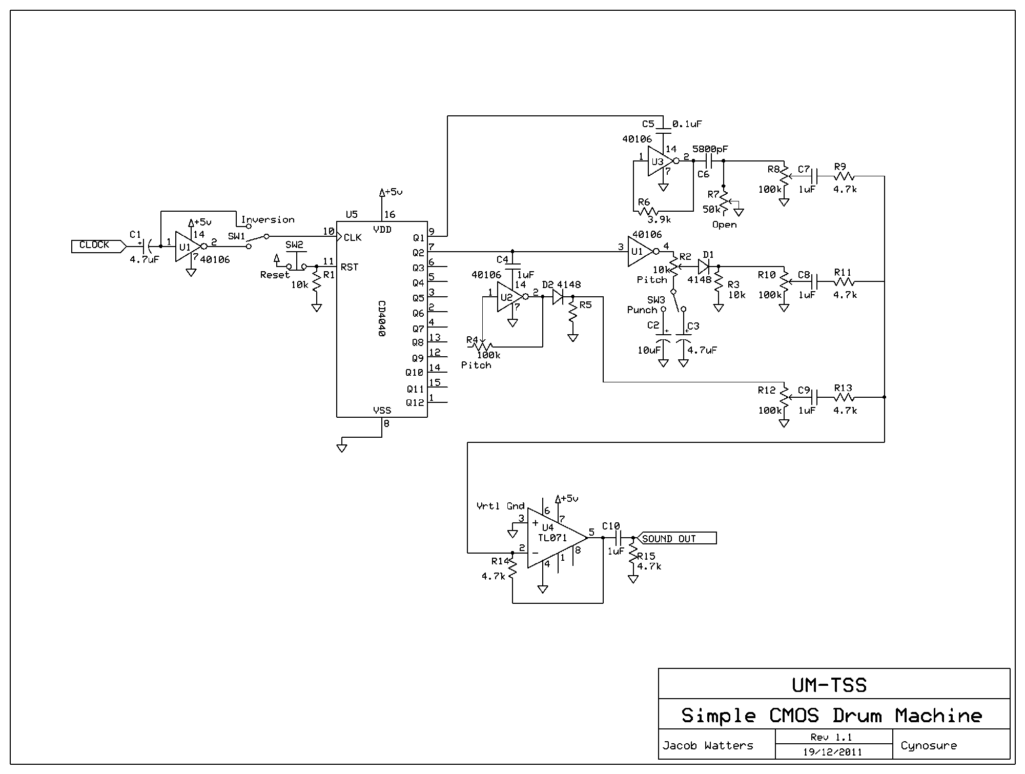

PostPosted: Mon Dec 19, 2011 2:21 pm    Post subject: Reply with quote  Mark this post and the followings unread
Here is the latest version with better filtering.
The only thin i'm not too happy with is the kick. I am going to play with that a bit. I may need to add and active filter.

PostPosted: Mon Dec 19, 2011 2:53 pm    Post subject: Reply with quote  Mark this post and the followings unread
Some random suggestions:
*) Replace U4, the TL071, with a TLC271 or a similar, single supply op-amp. Feed U4 pin 3 from a voltage divider, made from 100K connected to +5V, and 56K connected to ground. This should put about 1.8V on pin 3, given your 5V supply. Decouple U4 pin 3 to ground with something like a 1uF capacitor. This will make for a *much* improved mixer. The TL071 is not a good choice for your setup (unless you like the sound, of course. Smile ).
If you use a TLC271, then connect pin 8 to pin 3.
*) Once the mixer is working, increase R9, R11, R13 and R14 to equal and much higher values, at least 100k. Right now your mixer - if it was working - will have a 4.7k input resistance. I'm guessing this is probably not what you want? Among other problems this will severely distort your filter following U3.
*) Belt-and-suspender suggestions (unless you like to run 'em hard): Add 470 ohm resistor in series with R4. Add reverse voltage protection diodes to U2 and U3, for instance a pair of 1N4148. Connect cathodes to pin 14, anode to ground. This will largely protect the ICs from the negative supply voltage pulse, generated while their 'pulse' capacitors, C4 and C5, recharges. Right now they do so by drawing current through U2 and U3 - in reverse.

PostPosted: Tue Dec 20, 2011 8:05 pm    Post subject: Reply with quote  Mark this post and the followings unread
MadScientist - Thanks for all the suggestions. You were correct about the resistors. The distortion on the snare sounded great, but it was drowning out the kick too. I will try adding distortion another way.
I am using a virtual ground on the TL071. I know it's not the best method, but it is getting the job done for now.
Also, I added the diodes that have the black end at pin 14 and the other end to ground. Is that the way it should be? The other way stopped the sound from working.

PostPosted: Wed Dec 21, 2011 1:51 am    Post subject: Reply with quote  Mark this post and the followings unread
The virtual ground is fine, that isn't the issue. The problem is that a TL071 cannot really work on a supply voltage of 5V. The output is listed in the data sheet as being able to be driven to typically 1.5V below the positive supply rail, and 1.5V above the negative. At worst these limits are 3V below and 3V above. So, worst case, your op-amp will not be able to swing *any* voltage around the virtual ground, best case will leave you with 2V of somewhat undistorted output. Maybe. Confused
The result is that you are very/extremely likely to have a flat topping output from U4, regardless of level. This will add harmonics back into the signal, harmonics you may be trying to filter out. A TLC271 is a common part, which is guaranteed to be able to drive its output between 0 and 3.5V on a 5V supply, giving you more wiggle room. The virtual ground I suggest puts about 1.8V on pin 3, which of course is just about halfway between 0 and 3.5V.
If your load is always above 1Kohm, then the positive limit increases to 4.2V, in which case 2.1V may be a better choice for the virtual ground level. (Looking closer at the datasheet, then you should connect pin 8 on a TLC271 to ground in your case, not pin 3.)
Correct, and they shouldn't chance the sound in any way, they just make life easier for U2 and U3.

PostPosted: Thu Dec 22, 2011 6:32 pm    Post subject: Reply with quote  Mark this post and the followings unread
Thanks again for the advice. I ended up using a TL071 to distort the snare on purpose.
Here is what I have on hand. Would any of these work for the mixing?

After some deliberation and testing, I decided to use a TL072 - one opamp to give extra distortion the the snare and one to mix. The distortion is actually sounding better on the drum sounds - especially the snare. It sounds too zappy without it.

Here is the final schematic. Thanks again for all the input. I decided to go with the TL071's because I want the distortion. I even added a Wasp distortion filter to the kick (modified from the JH Wasp schematic).

For U3, U4 and U5 you use a 16 pin package of which you only use one inverter.
Could you maybe use this: http://www.onsemi.com/pub_link/Collateral/MC74VHC1G14-D.PDF
One inverting schmitt trigger in a package.
